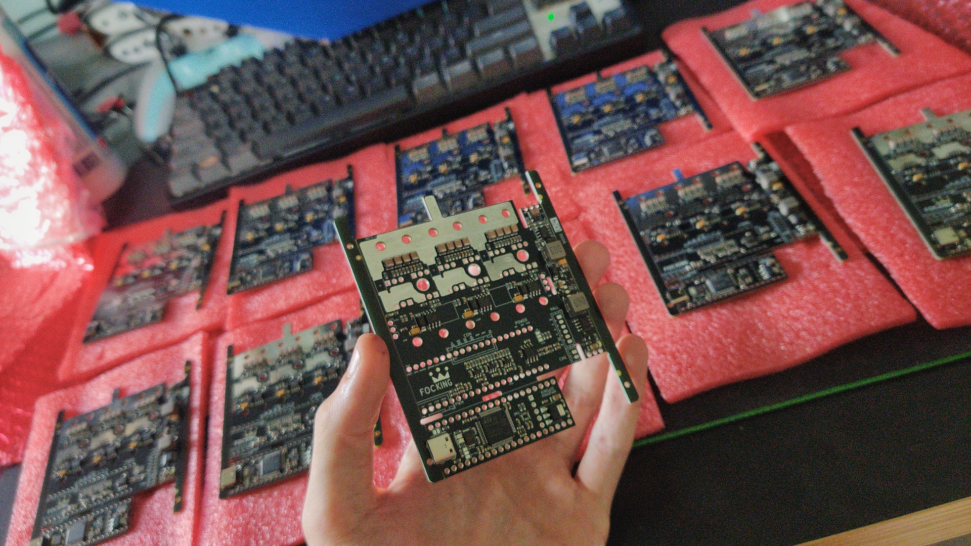

I’ve received the boards, they look stunning. Has anyone else had the PCBs produced in black yet? Currently waiting for the remaining components and already starting a draft on the shell design

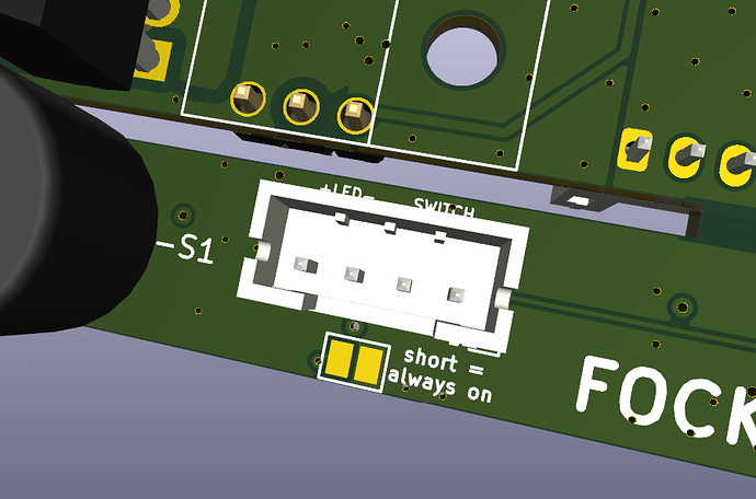

I have a question on how to make a latching switch work. I am forced to use a key switch. I soldered it to the “short = always on” pads. So when the keyswitch is on its shorted. Turns on beautifully, but when I turn it off it stays on for 5+ minutes before powering down. Anyone know how I could make it work?
Use momentary switch on dc-dc board. Connect it to pin 1-2. Pin 3-4 is for led.

I can only use a keyswitch, will it still function as I expect it to using pin 1 and 2?
just turn the key to on position, and inmediately back to off.
That’s not a proper solution. I looked into the schematics, R9 is the feedback resistor that creates the latch and keeps the circuit on after you release the button. Remove it and the circuit no longer holds itself on, it just directly follows whatever the switch input is doing. So a latching key switch works perfectly. I just tested it and it works exactly as expected.

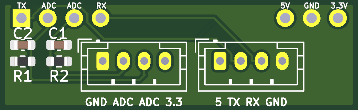

Finished building 1 today and took it for a drive. Just had basic motor setup + motor and battery max adjusted and it works wonderfully. Will make the 2nd one for my dual motor escooter soon and then I’ll tune them and see what they can deliver. Also 1 issue I am facing is noise on adc2. The throttle mapper GUI shows it being stable. But when adc2 is setup as regen or as kill switch it randomly activates itself. Even after manually adjusting the mapping. It’s just a brake lever switch with 2 pins. Works fine on my dual ubox and makerbase. I will investigate it further.
Use 10k pulldown and 1uf pulldown on adc chanels. Mines also catching some noise, but this solved the issue.
Edit: reply to your tiktok post. The controller is not capable for 300A. The opamp gain, and the shunt is limiting to 220A
there are also this 2 expansion boards where you dont need this 10k pulldown and 1uf
i made those boards, one for uart and adc and one for vesc express. But there is error on the pcb. If someone needs i have new for the uart and adc.
