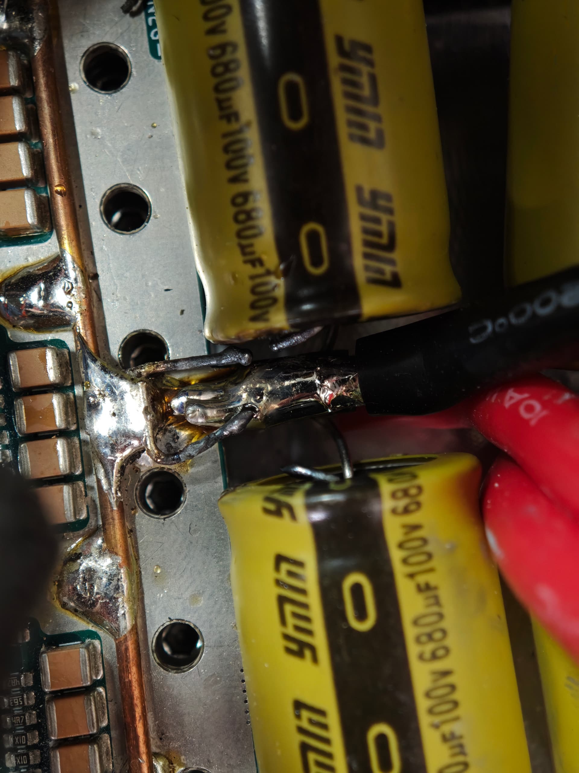

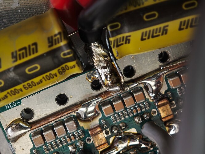

So, I popped the lid open to inspect the damage… and wow.
Both controllers had capacitors with their negative legs blown clean off.
The rear controller still seems alive, but the front one? Nope, it’s not even turning on.

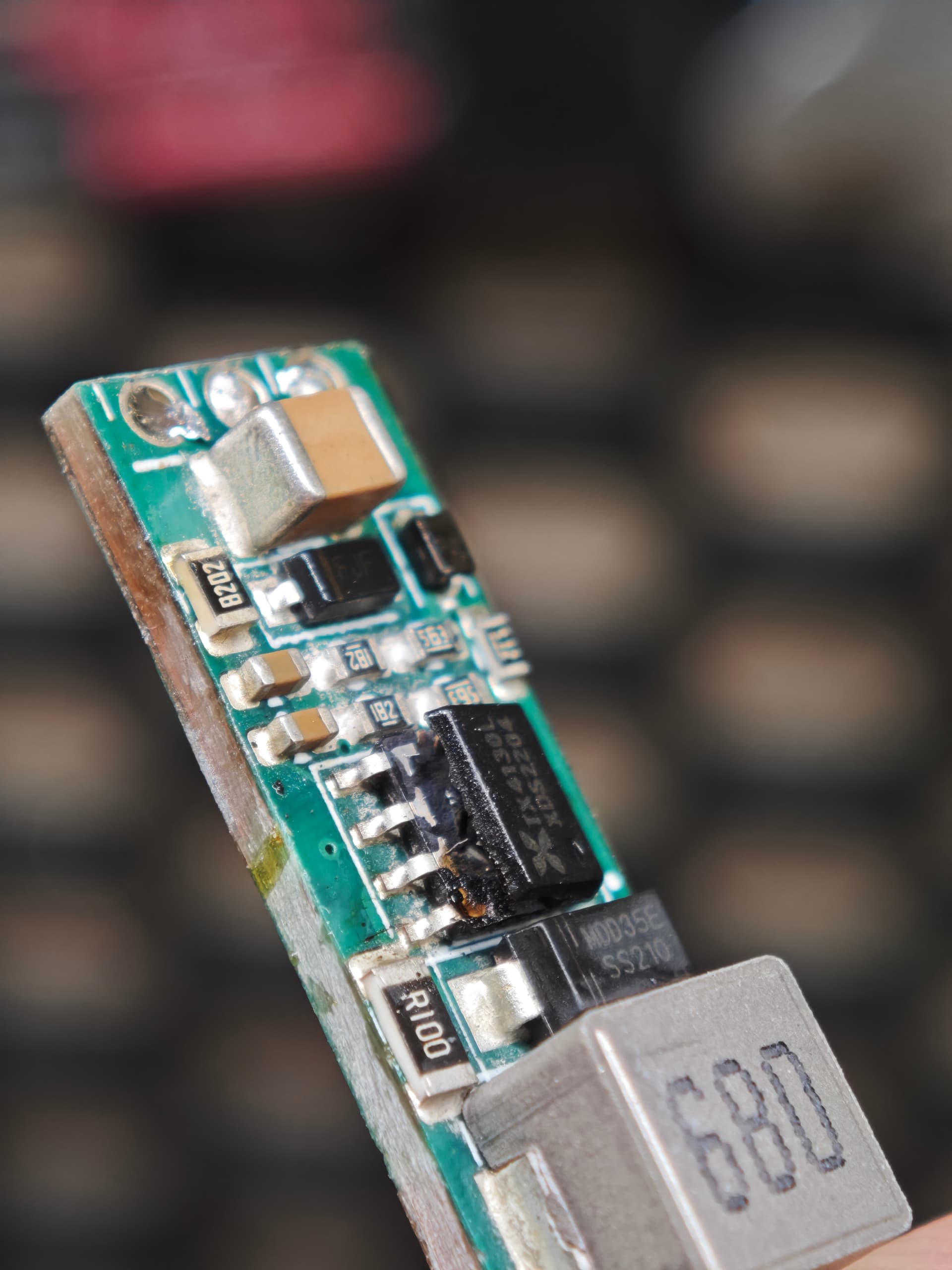

After a closer look, I spotted an “open-minded” IC on the DC-DC board. The PILL still works fine when powered from USB.
Did you enter zero motor amps or zero battery amps or both?
I entered zero motor amp, and leaved the 25 battery amps.
I guess you caps were not enough . This chip can be changed very simple and your VESC should be up and running in no time.
Get some bigger caps!
best
But this problem is not caused by the capacitors. Why did it blow with zero phase amps, and immediately when I moved the throttle?

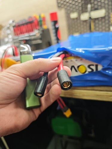

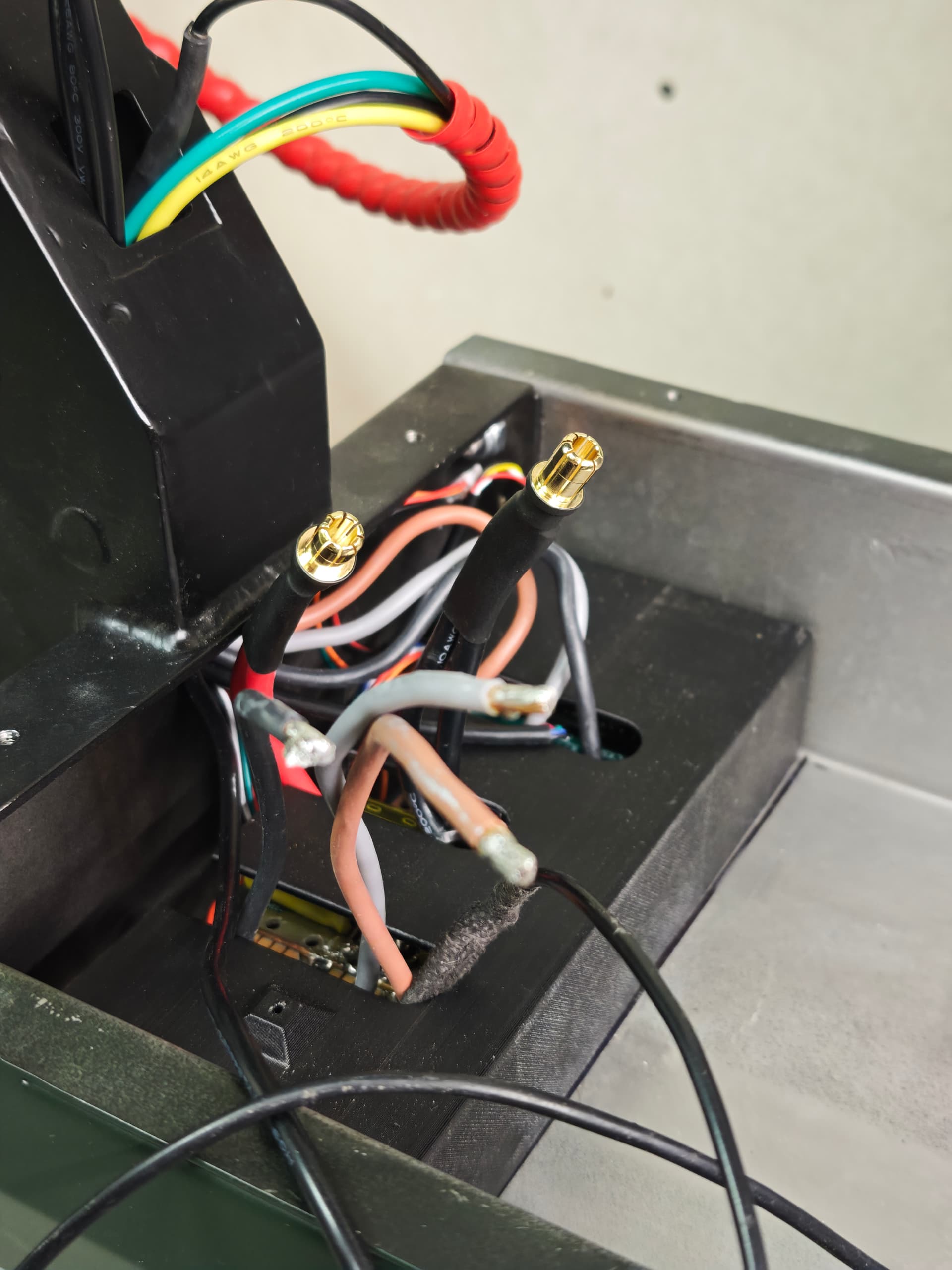

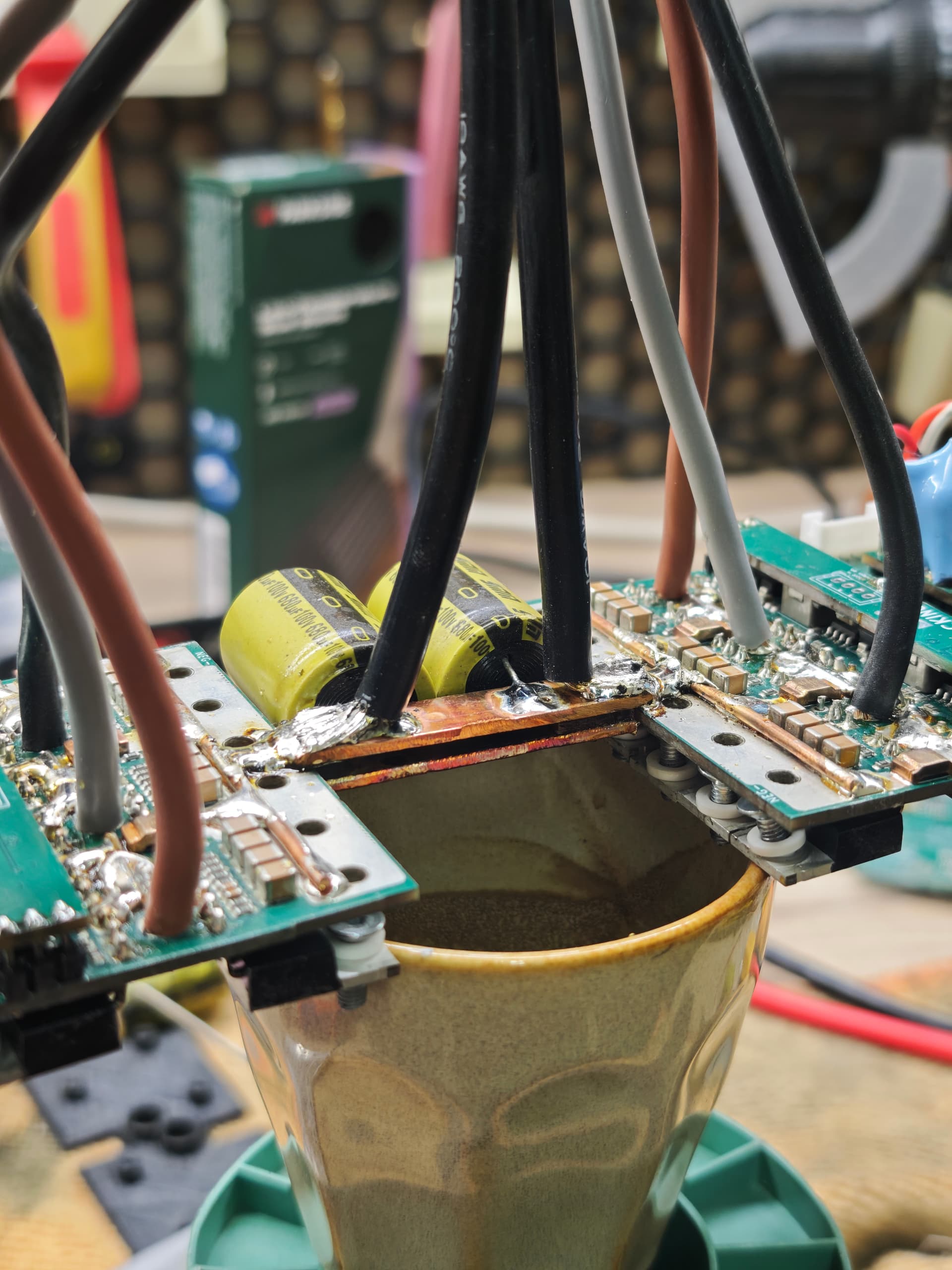

I put back the fixed controller, made some changes on cables and connectors, but it not able to measure the flux linkage with the 21s battery. If i use small 20v drill battery working without problem. Here is video whats happening flux linkage measure
And some pictures of the update power line
I often had to restart the vesc tool before flux linkage was detected. You have to try it multiply times. I don’t know why it is not working all the time.

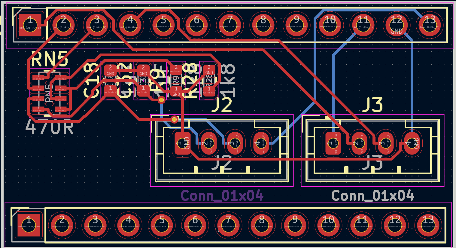

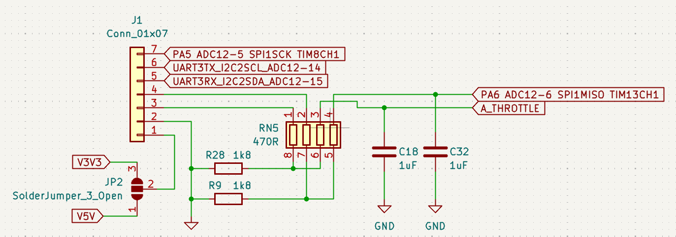

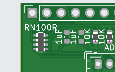

I changed the resistors, and added one more PCB for vesc express. GitHub - Warloo93/FOC-KING-ESC-ADC-and-VESC-EXPRESS: Add-on board for FOC-KING ESC
Can somebode check my schematic and pcb? Second time i made something like this :grinning:
it looks fine. i orderd 5 pcbs (had a coupon) so it just cost mit 8 $ with tax + shipment. I will test it.
I always wanted to design such an nice board :slight_smile: Thx for the effort !

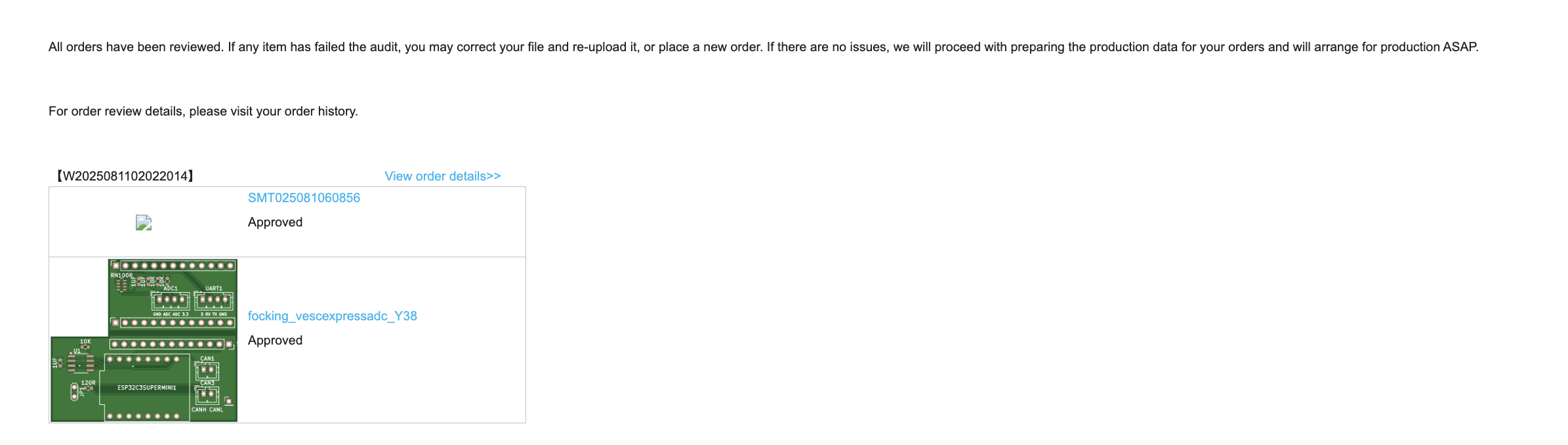

it has been approved and is “in production” right now
Did you checked the parts after you uploaded the bom file to jlcpcb? Becouse a had to change the resistors for correct values.
Its not a nice board, but thanks. :upside_down_face:
sure i checked the values after the upload :wink:
Good for you. :grinning: I didnt checked correctly

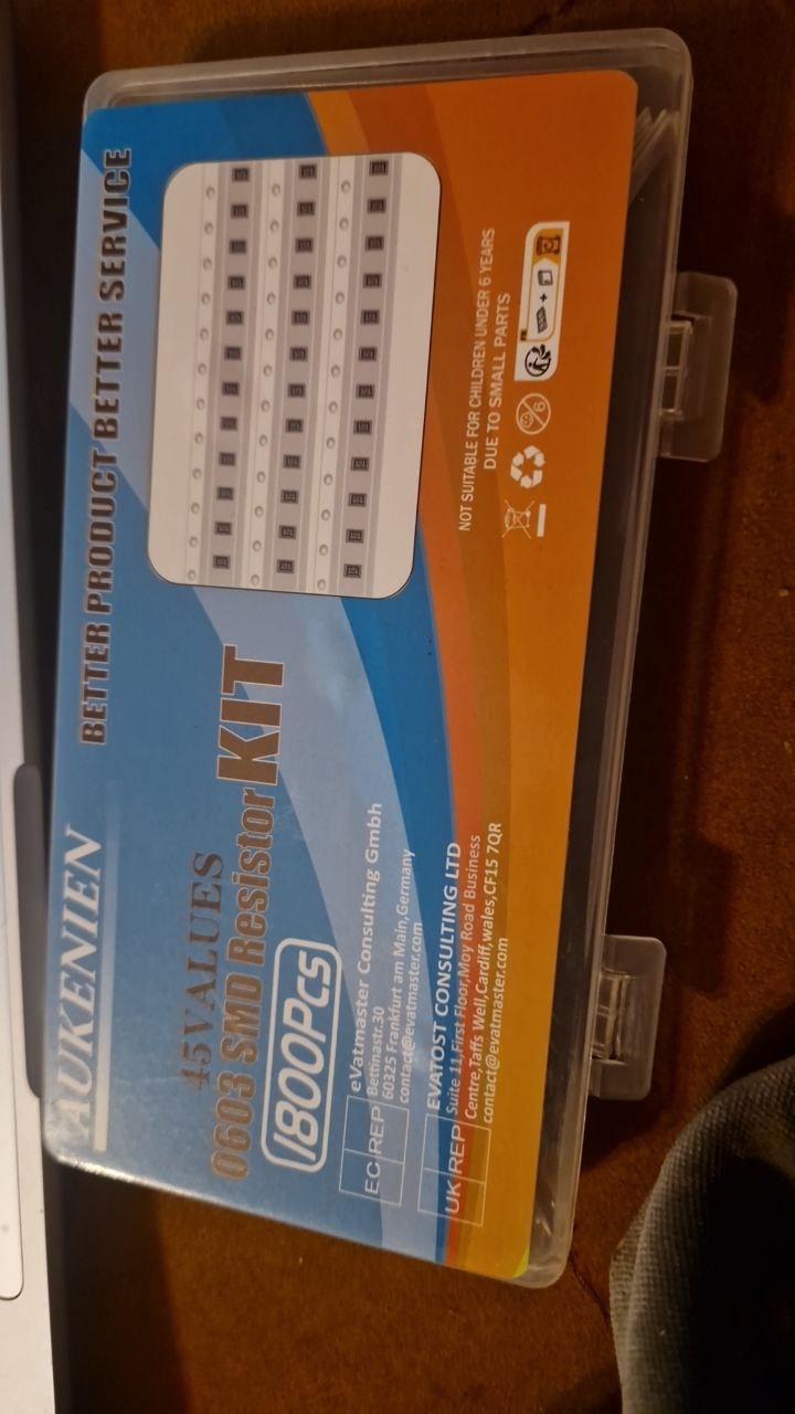

ok use a heatgun an order some on ebay or amazon :smiley:
https://www.amazon.com/-/en/Values-25pcs-Ceramic-Capacitor-100pF/dp/B0C5SKM9VT/ref=sr_1_8?crid=19TQ6CUJ2UIQS&dib=eyJ2IjoiMSJ9.W6-ERUZktbS478MU0wB4MBpEX6INMhZ9psIr6j47GrDEON1KG8735ItOEDW02D_7FiVxoQOY63YHA_8YLPjxkAqe0cMJ76GA3-t6xii4DyHLfax6Ay0KnYtIA9mUR0tgvSoDfL3cfakqRF_U2OFYkYfiPZdZt-n9nCnVortRSwZU6ujPdP3nt4l0_vh_xyU0Lb_CDxvGy-1iLJI6xbbW8PMzopRDCwmEGCQYHGjwvpgz9DqUFWbRG38c0RgySRcG0AZ24dG3O9bDdB1f10e08gbjqtXQkTxgWcv9PAZs67U.QXYzd7gVVhJ9evCRUw546f_63Uk-uvY1XLle3SU_JZo&dib_tag=se&keywords=1uf+kondensator+smd+603&qid=1755167858&sprefix=1uf+kondensator+smd+603,aps,87&sr=8-8

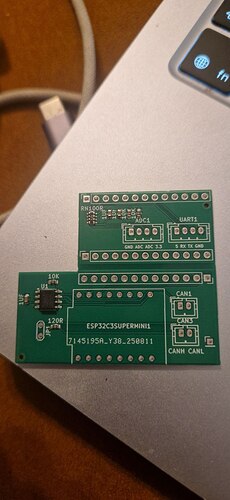

no got the boards today but , I placed the wrong resistors on 10k xD. I put 1.8k … good time to solder the correct ones xD
