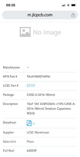

Someone can tell me what is this Part number , because I didnt find what kind of component is:
need better descriptions and the complete Part Number.
and this one too:
If you use the reference in the bom from the production file, you can look it up:
https://m.jlcpcb.com/more/componentDetail?componentCode=C7171
The reference is in the last colomn: C7171
