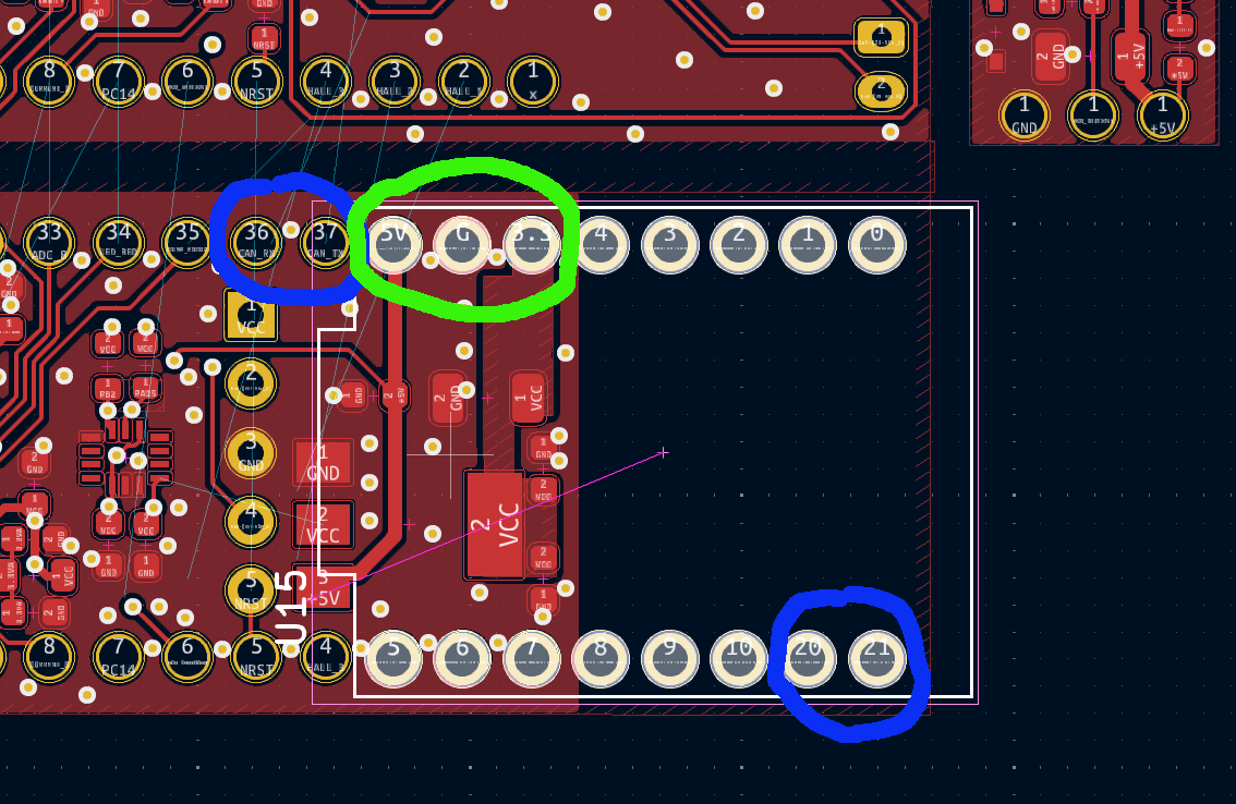

This is proving to be difficult, because the pinheaders are overlapping on both boards (esp32-s3 supermini)
You could actually attach the esp32-s2 supermini directly on top of the pill (like I have shown).
But I think I will have to pass the torch to someone else for coming up with a solution for the vesc express.

I like the idea of the extension board on the side. It adds a great flexibility to the FOC-KING. So you can customize it as you like.

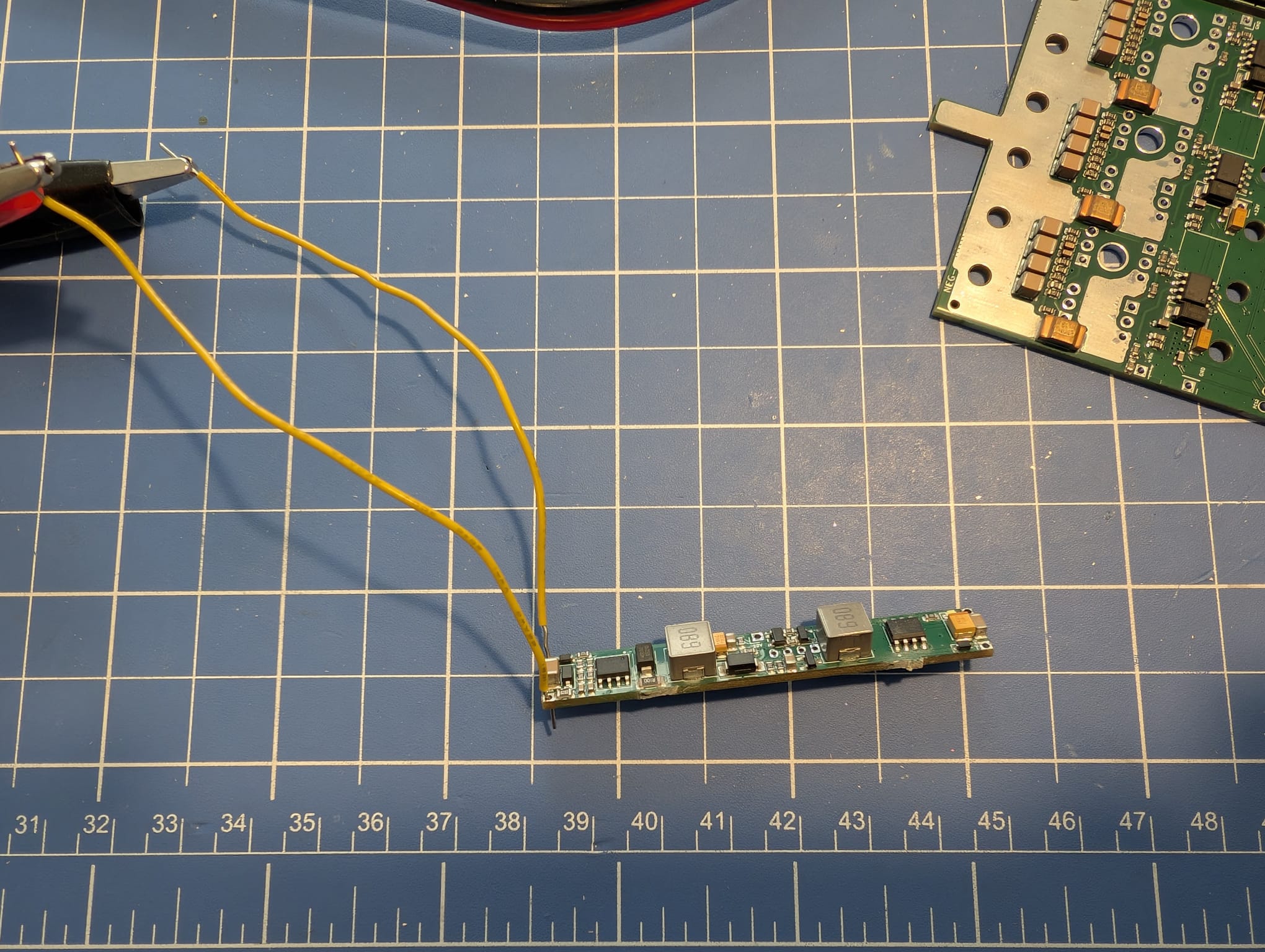

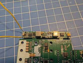

Hi, I’ve just started assembling my 5 FOC and I’ve found the first problem. The power module does not work.
I’ve connected as indicated in the assembly instructions and double checked with the KiCAD files, but the light does not turn on.
The power supply is limited at 0.1 Amps, but it does not consume anything at all.
I’ve tried with a separate board, and as it did not work, I tried with a united PCB as well.
Does anyone know what am I doing wrong?
Also, I’m trying to upload 3 photos to show it, but apparently I can not embed any media in the post, anyone knows how to do it?
Thanks!!!
you have to solder the bridge if you do not have a button connected!
its on the other side of the board
Thank you!!
Definitely, that’s a good reason why it wasn’t working for me!!! :smiley:
Now the power-in module works perfectly, thanks Markus (shambler) for your advise.
