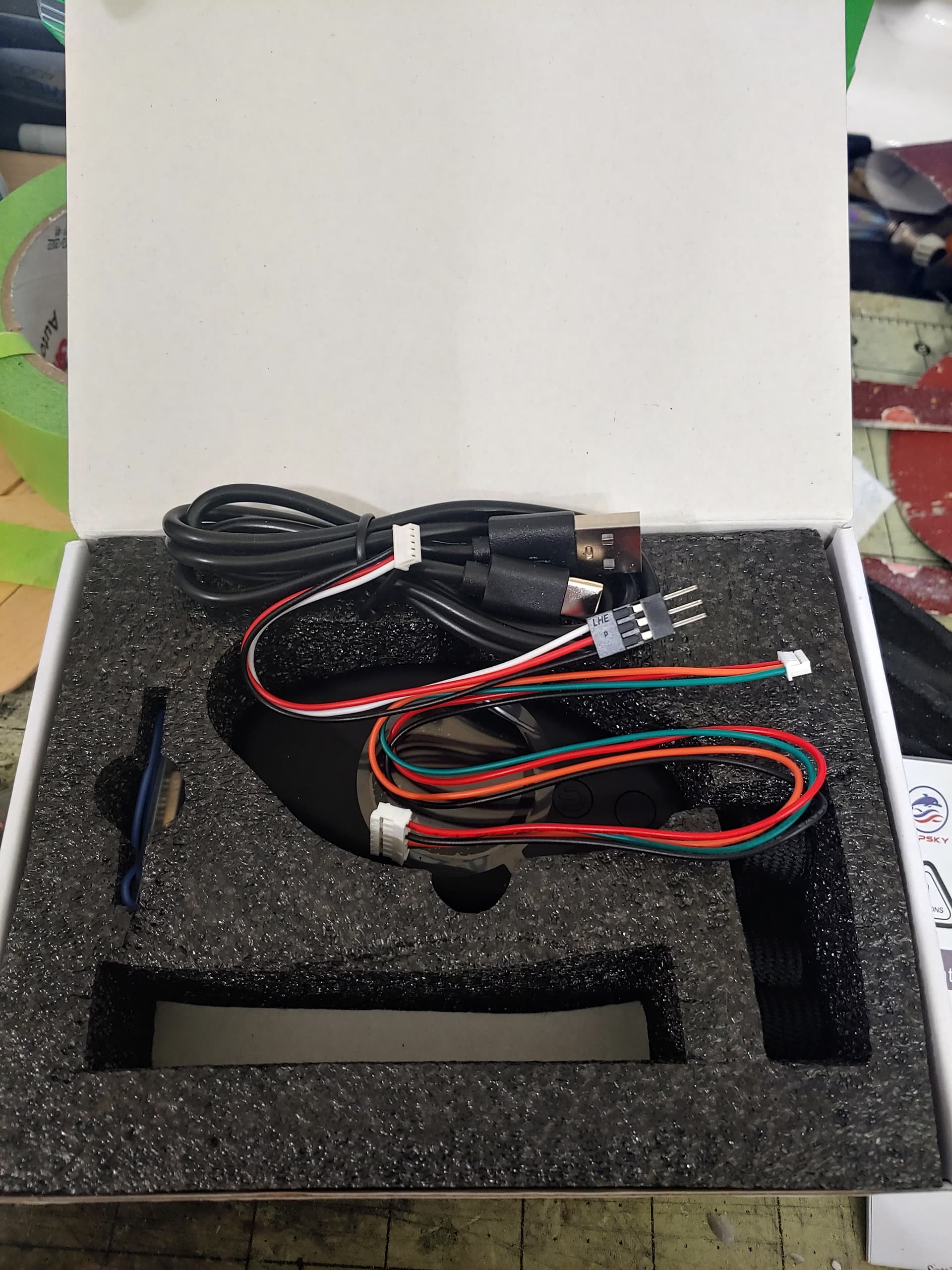

Looks like the stock of the remote coming from amazon still only includes one wire option. So it is important to choose the version needed for the VESC you want to pair it with
I know a while back someone else posted about them now just including the vx4 and vx6 wires but I made sure to order the version I needed just to be safe.

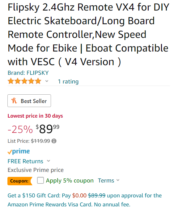

Flipsky 2.4Ghz Remote VX4 for DIY Electric Skateboard/Long Board Remote Controller,New Speed Mode for Ebike | Eboat Compatible with ESC(V6 ersion) Amazon.com
Just saying … :sweat_smile: cheeper and only 2 day shipping :sunglasses::zap::fire:

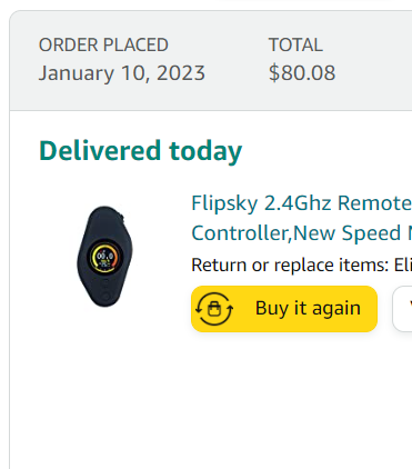

Amazon is only $80 though? :thinking: There is a little box you click when on the listing page to get 5% off
I didn’t have to pay for shipping, and if I wanted the cable for the VESC 6 version I could have ordered it that night and received it the next day.
