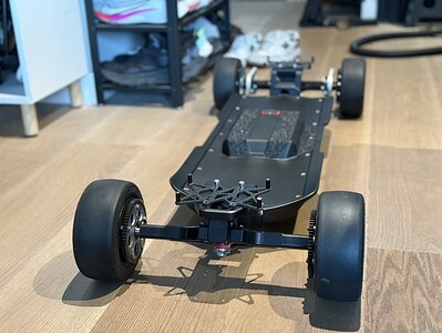

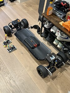

Ended to receiving a new deck prior to esk8con (literally like 5 days before I flew), and rushed to build and test it before flying to Vegas.
It’s still in prototype, so can’t delve too much into it as of yet, but should be a fun platform going forward. Though it is quite short compared to most raceboards out there.
Managed to get a single short session in with my original 16s5p in a backpack, since the battery for this deck was shipped directly to Vegas in preparation for esk8con.
A welcome side-effect of a short deck and brackets was that it fits perfectly in my regular suitcase with minimal disassembly, which made flying a tonne easier.
