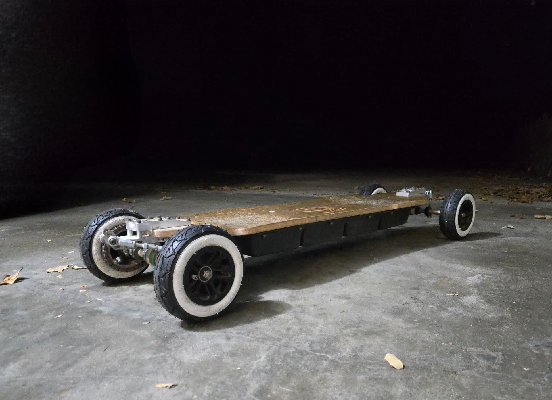

I went down tire size and don’t want to mess with gearing.
So I want to try FIeld Weakening on the Llama.
12S8P P42A pack
unity.
SKP reachers 153kv.
Where do I start for esk8…???
Throw 60a @50% duty at it!
What is that going to do?
