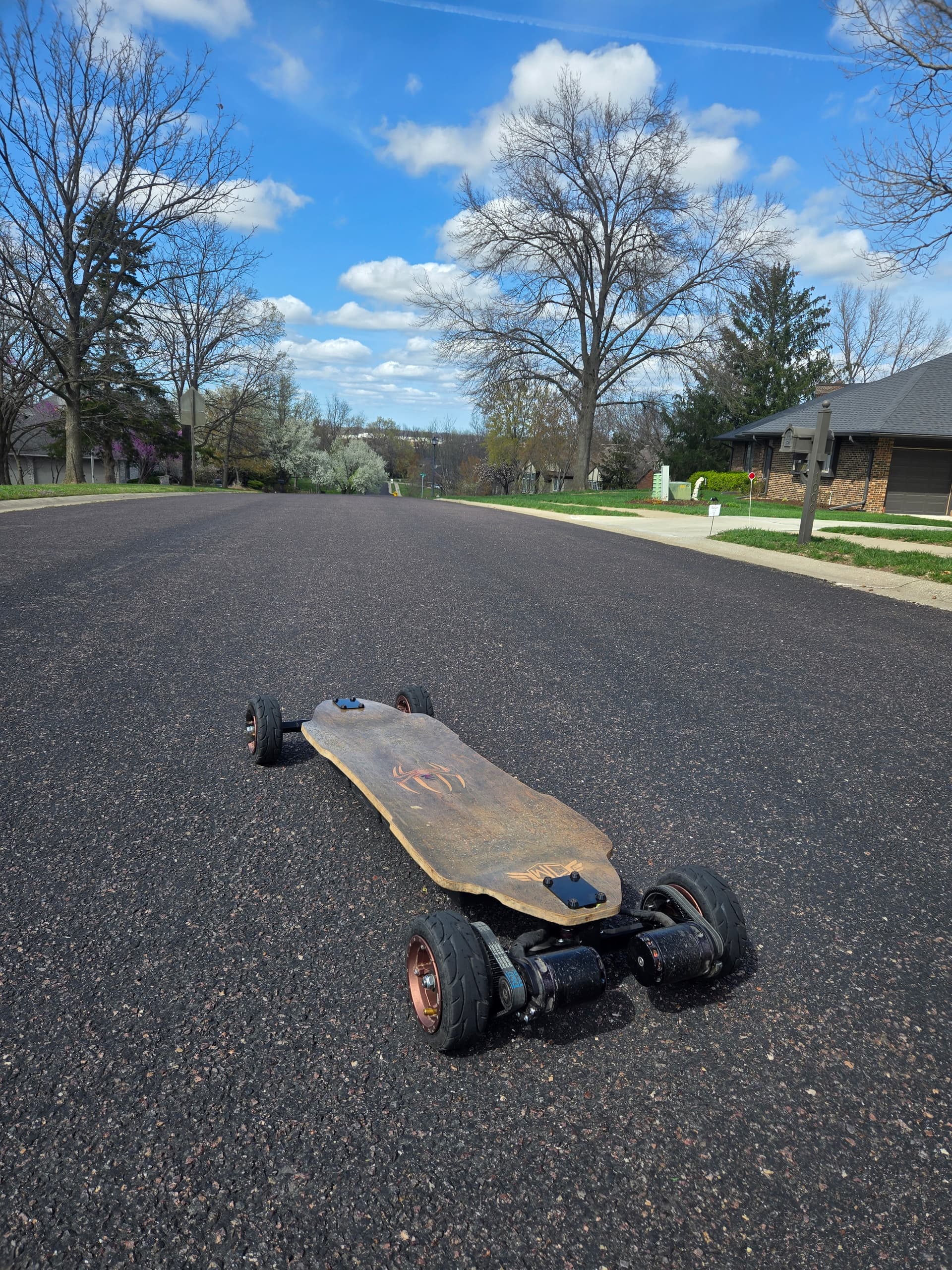

So I flipped on Field Weakening on an Esk8 today.
Looks like I only gained a couple miles on the bench and maybe one mile in real life…
Not much testing so far…
Can I throw more amps at it?
Throw more amps at it!
But bench test and make sure the motors run smooth before riding.
You’ll notice hall sensors being weird once you get the settings too high
