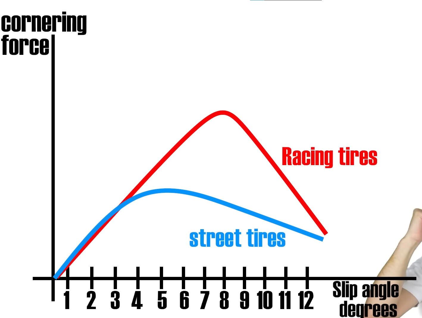

The reason you want to maintain traction on asphalt is that tires will glass if you push them past their breaking point and then you lose a ton of grip, this is why ABS exists. This doesn’t really happen on dirt both because of the surface and compound/tread grabbing at the loose surface. It does to an extent but not as extreme.
Its also near impossible for an F1 car to have a controlled slide since as this picture shows, its an extremely steep drop-off, and once you hit that point it’s going to keep sliding because once it goes past that point it can’t just pick up where it broke you need to go lower than that so it can regain traction and de-glass. If you have ever watched an F1 race (which I know Morgan has because every time I scroll past one of Mercedes’ posts it shows he liked it already :joy:) you will notice 2 things the first is that there is no slide at all (at least on purpose) and when they do slide they can hardly correct it, the tires break traction so abruptly that their grip basically vanishes and they spin, mind you these are basically the top 20 track drivers in the world.

Of course, F1 is a terrible comparison to almost everything esk8, they have downforce, suspension, only steering on the front axle, front brakes, etc., but all I was comparing is the way that tires behave when stressed and pushed past their grip limit and that is at least decently similar.
Hmm, so one might conclude from this, if losing traction is more acute and leads to loss of control, then it’s faster to maintain traction. otherwise it’s faster to drift through rally car style.
