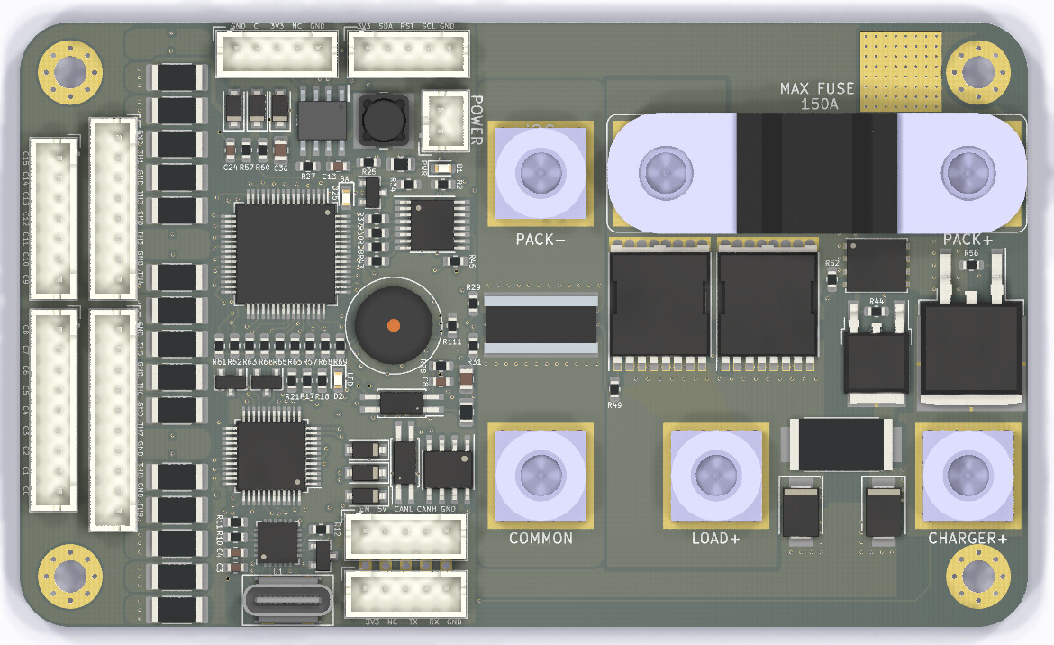

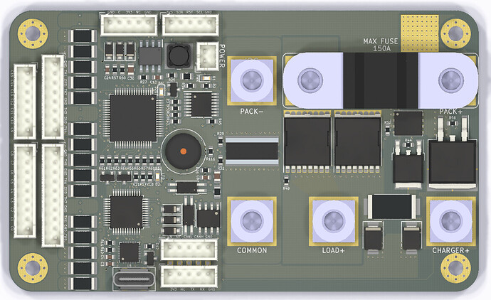

No staying vertical for USB. I don’t see a good point there. Vertical will works just fine. Horizontal will extend beyond the PCB edges or will take more space. All other connectors are vertical. i don’t like mixing stuff.
Small update: routing finished.
40% reduction in size by doing dual layered components.
Might be able to go up to 150A continuous discharge with 2oz/in thick copper
As a senior PCB designer and IPC certified idiot :joy:: watch out for making enough vias (pretend capacitive coupling and correct your floated areas)
Just a friendly hint, no balls on table
Will try to. Routing finished, but still some small things to do & verify.
Thanks
Thats awesome on the connectors to JST PH. Are they equal current rated? 5A i think those wr-mcp3 are. damn tricky sons of bitches :hammer: those connectors are
2A for JST PH which is more than enough for balancing, most BMS for small packs balance at less than 100mA. Measurements are done at standstill, so smaller cables should not have an effect on the measurement precision.
Ordered today the latest PCBs for the 15S & 18S “Full” version.
The only schematic change are related to the USB C connector & removing the BLE module, so I’m quite confident that this version will be just fine like the previous one. On the other hand, the PCB layout is completely new due to the smaller size, but the design rule tracker is all clear, so it should be fine…
