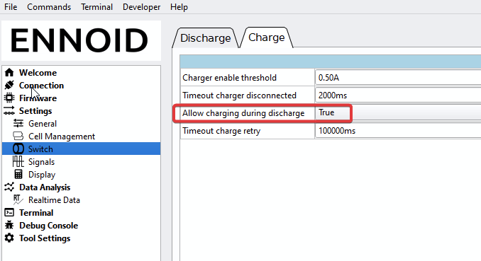

For reference, the charging port does appear to stay live once the voltage is brought up if ‘Allow charging during discharge’ is true. This remains to be the case when the charger is removed from power until the next shut-down.
I will repeat again: Use VESC tool for configuring XLITE and do not use ENNOID-BMS tool unless you really know what you are doing.
VESC tool is a lot easier to use and you will not experience unexpected behaviour when using it for configuring.
Thanks, that is what I need.
I tested it works.
I.e. we could use Charge port as Load port.
It is great!

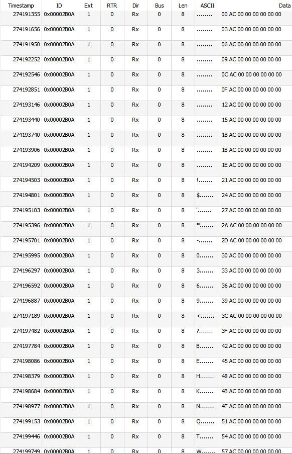

btw I discoverd some bug in CAN telemetry transmittion in version 6.0
It sends a lod of messages 2B(CAN_PACKET_BMS_TEMPS), assuming there are 172 cells.
It does not works in V6.0 jnly in 5.5
i mean

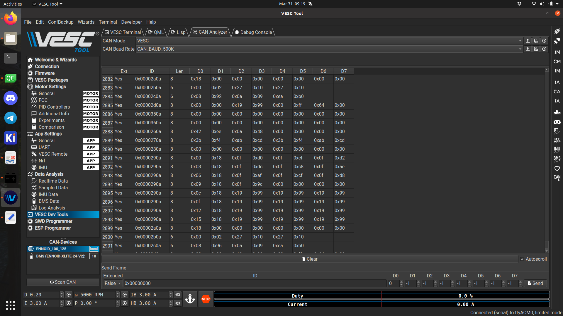

Could you be a bit more specific about the bug you encountered? Using VESC tool or EBMS tool for configuring? Parameters etc.
There is no such bug in VESC tool over CAN bus and this section uses this particular message… so I doubt there is a bug there unless you do something wrong. Like using your own firmware.
FW: XLITE-12 V2
I observe direct CAN traffic via ESP32RET can sniffer and SavvyCAN SW.
I simply don’t observe this CAN bus issue you are reporting on V6.00 firmware which is available on the website. I tried many different scenarios, using ENNOID-BMS tool and VESC tool for config. Everything seems normal, I receive only one 0x00002b0a. The only CAN message that repeats itself 8 time is related to the 8 x 0x0000290a which correspond to the 8 x 3 = 24 cells voltages.
That is why I’m asking, what is you configuration? Which firmware are you using exactly (from the website or the one included in ENNOID-BMS-tool)? What are your settings? Maybe you have somehow broken the settings when using ENNOID-BMS-tool because it is possible reach 172 temperature channels if you configure with several "monitoring IC count " or many “parallel module count” and also “number of temp sensor per monitoring IC” Maybe you are using an XML file for configuring? Beware, they are a good way to preserve your settings, but are not always compatible between versions. I must update the claim on the ENNOID-BMS-tool settings page, it is confusing

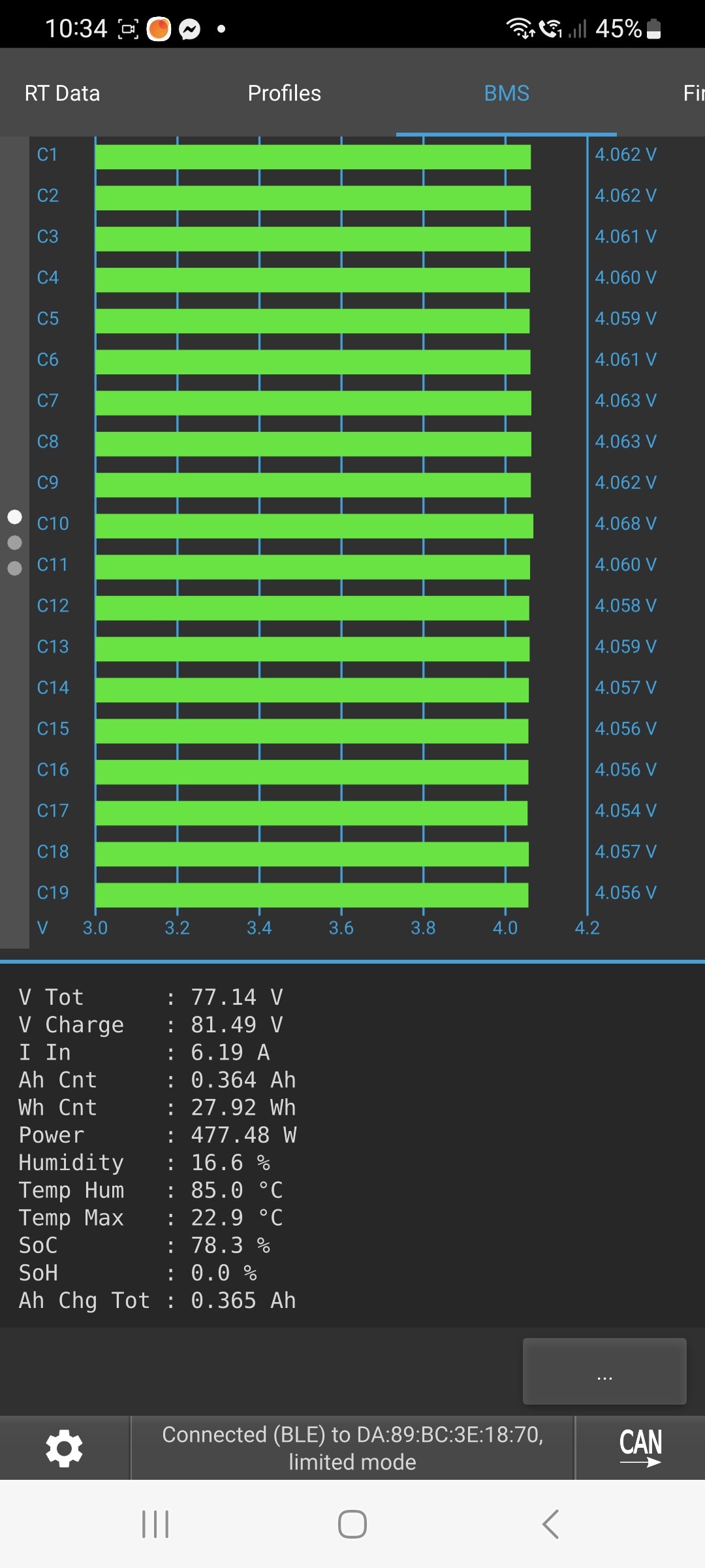

@ENNOID XLITE-v3 - I noticed high temperature temp hum while charging. 100°C seem excessive and a bit suspicious (19S battery, 5A charger).
I have 2 termistors on cells and they correctly show temperature close to ambient (21°C).
After powering on BMS temp hum rises quickly and settles around 37-40°C on idle, but after starting charge session it raises quickly.
Is this normal behaviour? What are the expected, safe values for temp hum?
I noticed new test firmware -6.1 beta2 and release notes saying that it’s fixing charge thermal protection, so decided to upgrade. It doesn’t seem to change anything.
I set up charge max temp BMS to 60°C, but it doesn’t stop charging after temp hum is 60°C or over
