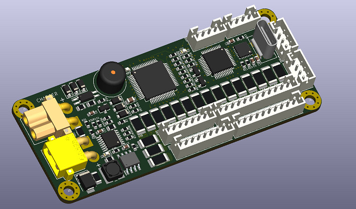

Would 30mm x 100mm be too wide or too long for X LITE version? Could go xcheap & xsmall with X LITE version…
For putting it into the Onewheel BMS slot, I think it’s totally fine (also depending on thickness). I’d say if you wanted to make it fit Onewheel well, making it 37mm wide would mean the user won’t need to figure out a way to secure it, whereas 30mm might be too loose in there. But it’s a minor concern.
35mm wide would allow to keep the additionnal connector row for thermistor inputs and the quite large wurth terminals…
Thermistors seem important :slight_smile:
Not sure I care about the wurth terminals (they seem like they won’t fit in the Onewheel BMS space), Onewheel uses two XT60s (one goes to the battery and the other to the controller), have you considered those? They make things convenient - as opposed to connecting or even soldering separate wires. For a charge-only, I assume there would only be one XT60, for the battery (in addition to the charging port connector).
To make it super convenient, there could even be an XT60 for the controller even on a charge-only BMS, wired straight to the battery one. Just throwing some ideas…
I don’t think XT60 even xt30 connectors would fit on the board directly. They could only be soldered directly on the board creating a sort of protuberance. Soldering pads is the cheaper & smaller option so the user can place the junction where there is space. I really like having M5 screw connectors but I agree, they are quite large for e skate application.
Drawback of soldering pads is, well… user has to solder the wires on a brand new board… :sob:
XT30PW might actually fit… what do you think about this small 30A max. connector?
No answer about XT30, so I worked a few hours yesterday on it to see if it would works.
So far, it fits on a 35 x 85mm. This could be a future ā€œcharge onlyā€ narrow version with XT30PW for connecting the charger on a flat battery pack.
No need for larger connectors than 30A if the BMS is only used for charging…

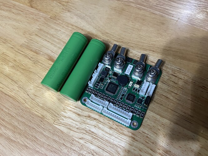

Started to ship some SS-18-LITE this week:
Not that they are that big… but I understand that smaller is better on this forum.

Tbh. I’d just be drawing the CAD model based on the dimensions I measure and all that’ll be is the triangular profile of the OW BMS pocket (plus the length which we already have and it’s not a concern). I’ll likely just send you a 2d schematic with dimensions…
But, seeing as you have 3d models of your designs, if you (after I send you the dimensions schematic for a basic fit-up) send me an stl, I can 3d-print it and verify the fit for you. I think that’s a reasonably easy way to do it?
Yes, I will send you step files.
I can also try to bring the connectors more centered. Also, note that the two connectors opposed to the balance+temp connectors could possibly be removed/not populated I think. Those are for the power button & I2C display which might not be useful for most users on a charge only BMS. There is an automatic wake-up function when connecting a charger and there is also the possibility to use an external 5V enable signal coming from the connected ESC to wake up the BMS…
XLITE.step (31.0 MB)
See attached .step file
Wow… now we are talking… I guess is still 18s (and not just 15s, to have room for improvement, and even in the future for discharge too). Looking awesome. I am impressed.
Zippy is right, with the thickness. I guess now with the cad, could be adjusted easily. Thanks for the hard work!!
