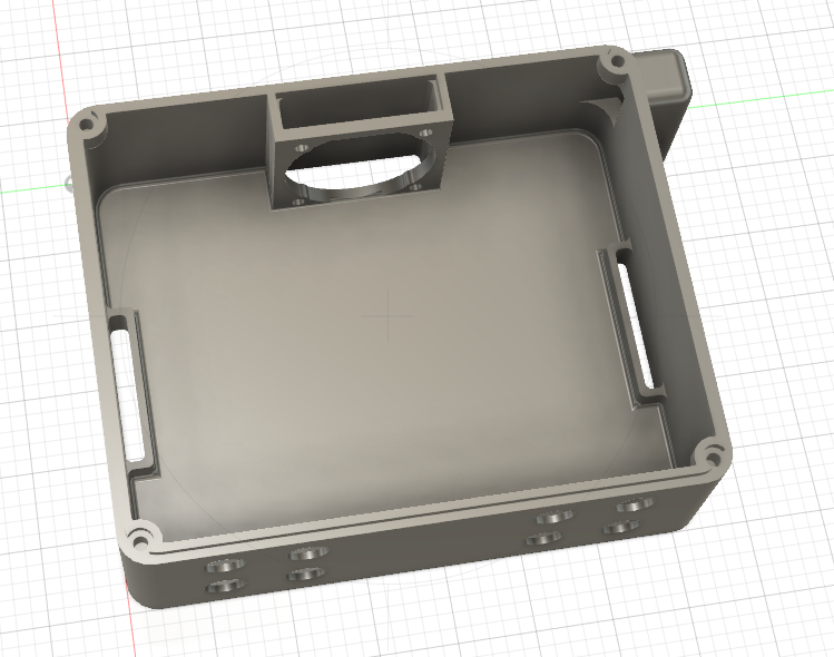

The highest temp ive ever seen on my 12s 4.12x2 mountainboard on a hot day, towing someone up a hill is 52c. On an average day like today i couldn’t even crack 41c. I use 1 high power 50mm fan.To prevent wayer ingress the inlets and outlets are underneath the enclosure parallel to the board with a 5mm gap. Heatshrink is removed from the vescs

Why not build a encloser that has a large alu plate in it exposed to the outside air. Large CSA exsposed to outside air has a huge amount of heat exchange potenchal and you moving is a fan
That would involve a complete redesign of what I currently have. It will never happen.
Is it a top box mounted ESC?
Just one vent can’t do much as there’s no way to allow air out of the enclosure so air won’t flow in. Two vents can work but water and who-knows-what gets in too. Gore vents allow tiny amounts of air to get in/out (if using two vents) but just exposing a metal heat spreader plate to the outside (with the ESC and whatever else mounted to it) will be much more effective IMO.
