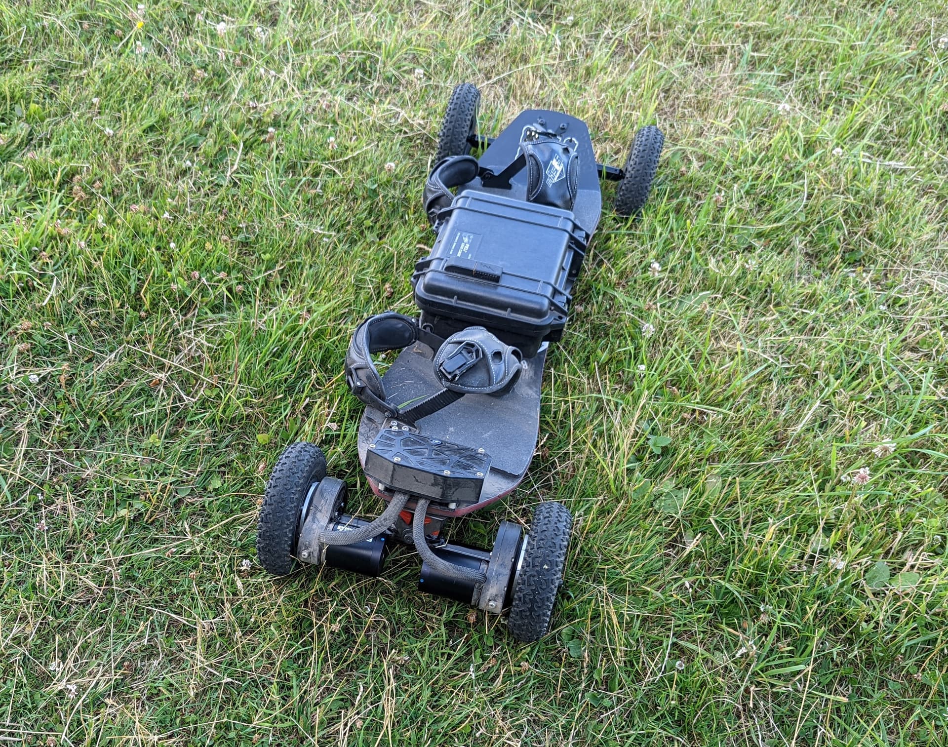

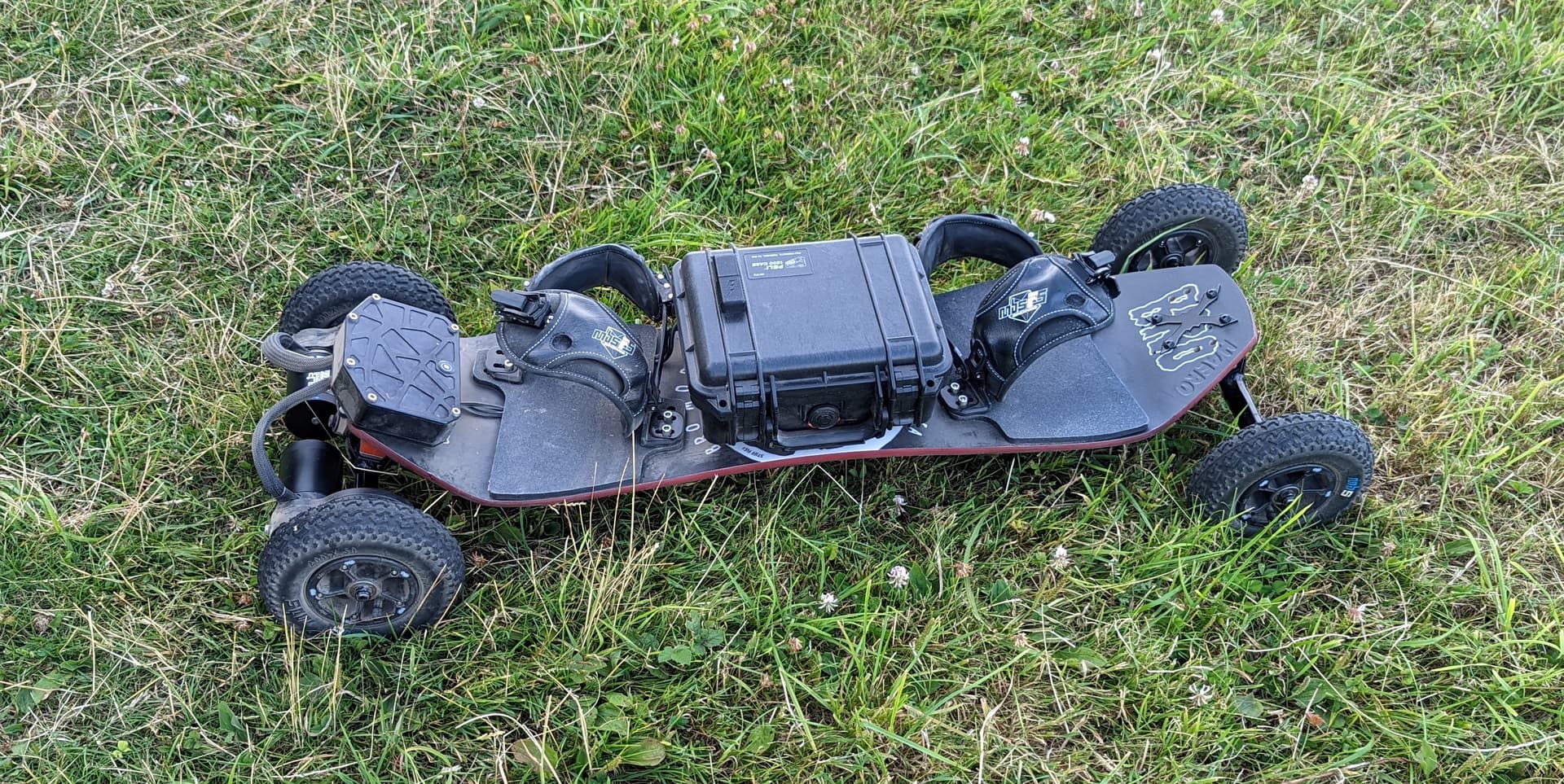

I’m really happy with how this build turned out :blush: I’ve been riding it pretty much exclusively offroad down the mountain bike trails in the woods near my house. I used to mountain board as a kid, and this brought back a lot of good memories, I love that I can blast uphill as well as downhill now (we are living in the future!).
Sorry I forgot to take pictures of the completed board before riding it and covering it in dust, I was too excited to test it out!
