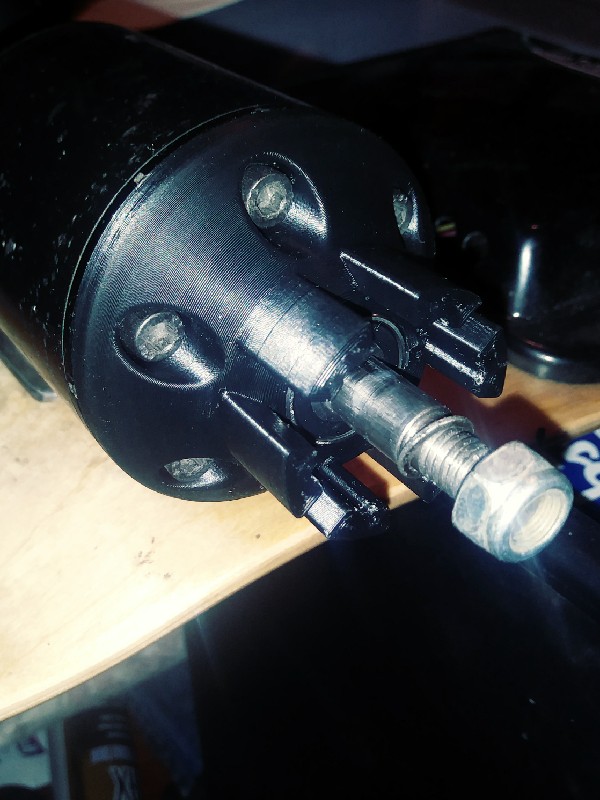

Rev. 2
I was a little OCD about R1 plus i left the adapter in the acetone vapor bath too long…
esk8 testing today for science…
Could explain why the acetone vapor bath? And how?
I can give you the concept and you may educate yourself further if you choose to…
acetone is a solvent…
if you heat acetone it will vaporize at a low temperature, which has many positives
investigate the interwebs and use your noggin and there are a myriad of uses for a vaporized solvent
in this low-tech application I placed some paper towels soaked in acetone in a glass jar… I suspended my part and put the whole assembly in the sun to vaporize the acetone…
acetone vapor increase layer bonding in this application
removes magnets from motor bells in other applications…
go vaporize some shiT!
Thx Kook, now up to improving my bonding
go slow… an hour~ish in the warm day sun may be sufficient…
you can always choose to override your slicer as well…
science is k00l
Just be aware that it only works on certain filaments:
“filaments that can be polished using this process are: ABS, ASA, PMMA, HIPS and Polycarbonate. Other filament types are either unaffected by acetone or are damaged by it.”
I had great results with this filament:
https://www.extrudr.com/en/products/catalogue/green-tec-pro-natur_2286/
