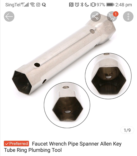

I use one of the these and it works great. Let me find the size. Genius. Can’t find rn but they usually come in sets and are as cheap as @Zach 's cologne.
Remove the adapter and use a 17 or 19mm wrench. Then it’s basically loose, might need a rubber hammer to force it out.
