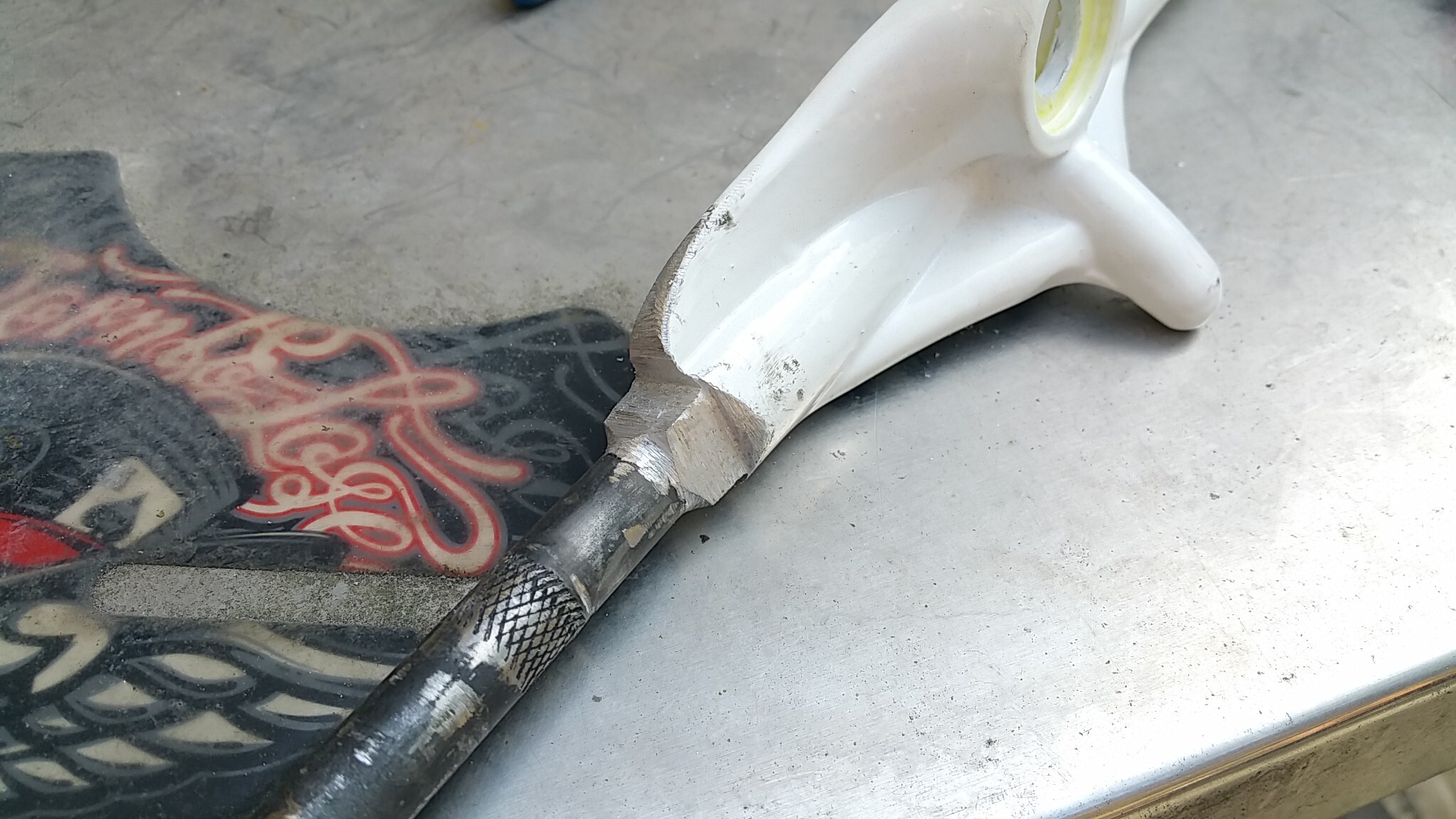

Kenna has offered me a new axle with no changes whatsoever to the one I’ve already bent, because of this I’m DIYing “adapters” made out of wowgo hub sleeves that sit on the inside of the motors.
They will be 1-2mm smaller in diameter than my wheels so that they never touch while riding, they will prevent any motor contact when riding on uneven surfaces and will also prevent the axles bending as the “adaptors” won’t allow the axles to flex as much as they will touch the ground before that happens.
Covering only a small part of the motor, I don’t think it will affect the heat dissipation that much, lets see.

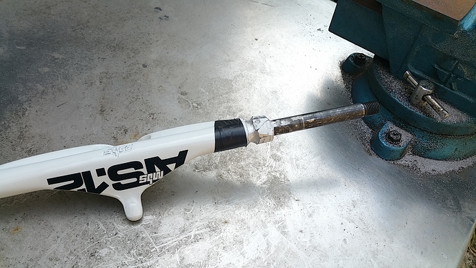

It’ll be a lot of filing to remove the alu hanger and expose the 12mm Hardened Steel axle to match the original hanger, but I think this will be way stronger.
As a bonafide 12mm axle and not stepped down to 8mm I will have to use trampa hubs with gummies on them. Dunno when I’ll get it all done but this is the road I’m going down.

All done,
I ground the aluminium off using a table grinder and a vice.
Take care not to grind the axle…as soon as you see sparks you’re grinding hard steel.
Proceed with caution and don’t rush when you get close to the axle.
It’s totally doable and easier than I was expecting.
Use a hand file to create the square ends needed for the motors and for rounding off the edges here and there.

Trampa make 10mm skate trucks. Hardened hollow steel axle.
I can use trampa adapters so the 12mm motors fit tight on a 10mm axle, this will allow me to use the Caguamas that I had planned to use all along as there are bearings that fit a skate wheel and a 10mm axle.They had the best feeling and complimented the motors 58kv better, these trampa hubs have killed the torque obviously and the increased top end is something I don’t care for. I want to skate and do tricks, you can’t do anything at 28mph except go straight, hold on and pray you don’t crash, not my deal.
