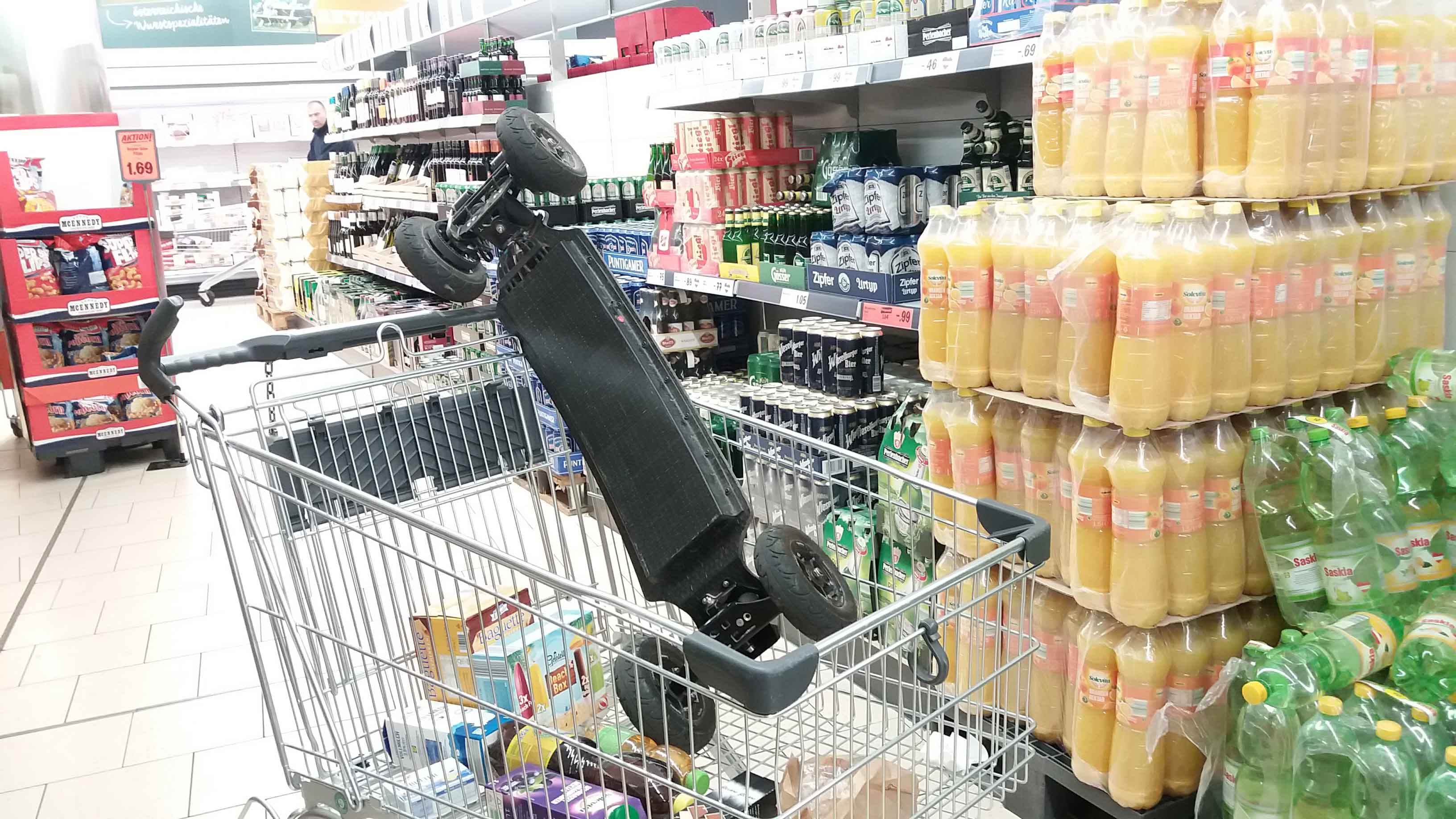

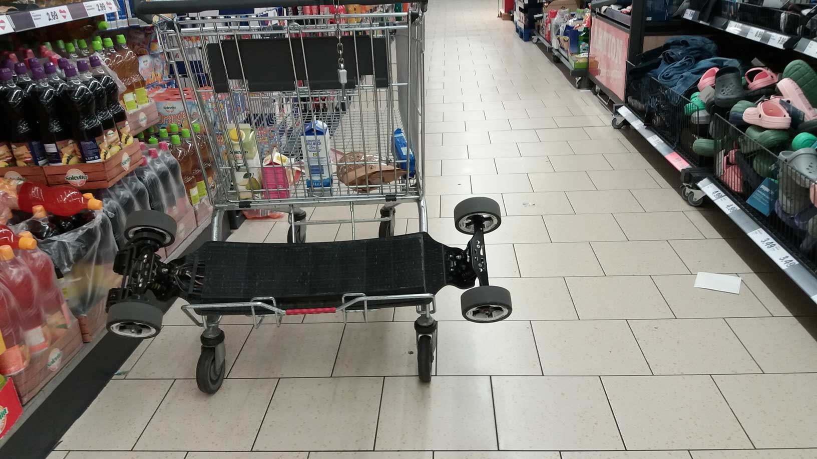

For commuting or grocery store I wouldn’t use a MTB because it’s big, heavy and bulky, hard to carry and to store.

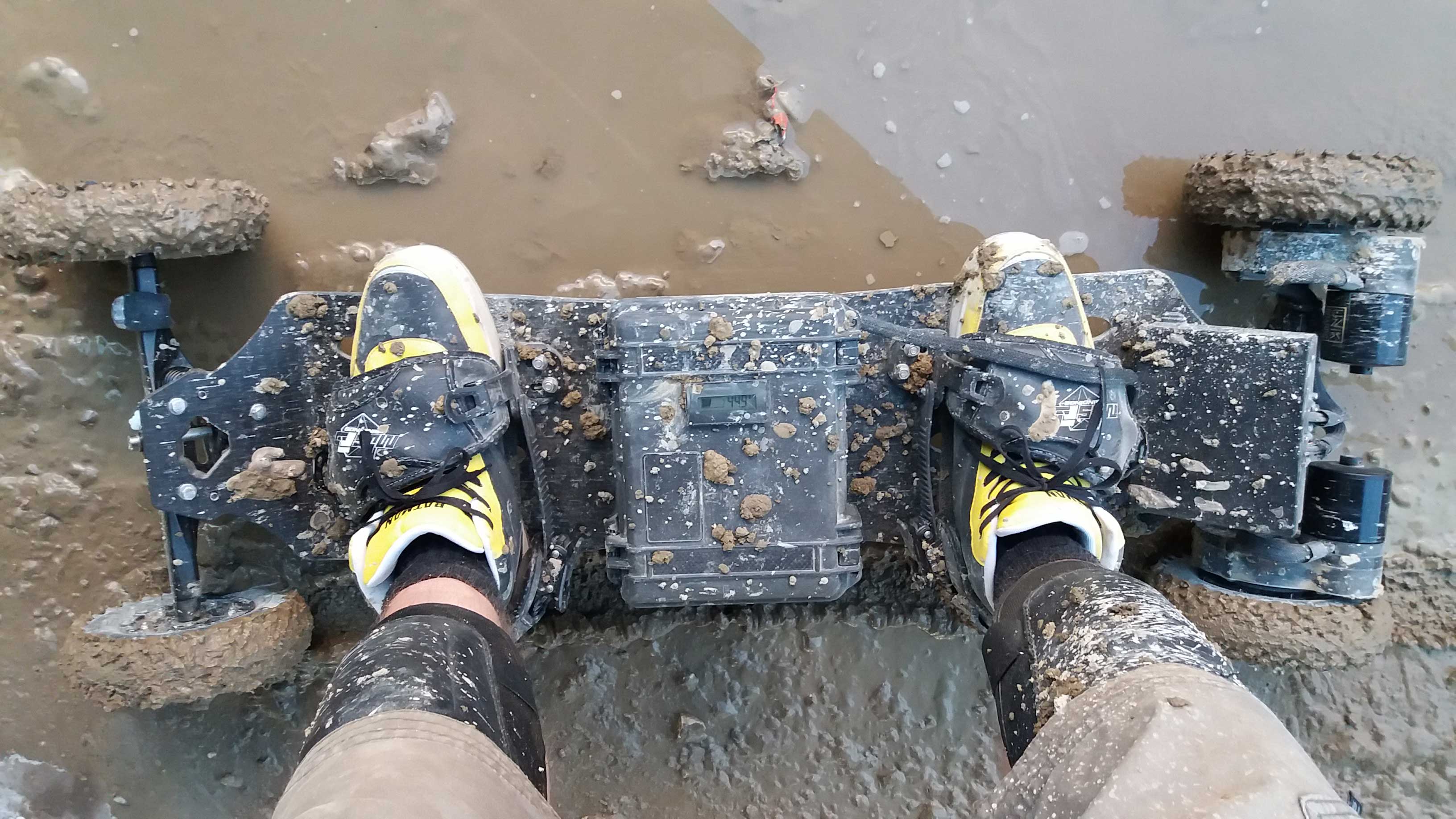

One important thing to mention is safety gear. If you use bindings you gonna fall different and therefore should wear more safety gear like e.g. crash pants, moto x protector vest (with back protector and hard shells) and fullface helmet.

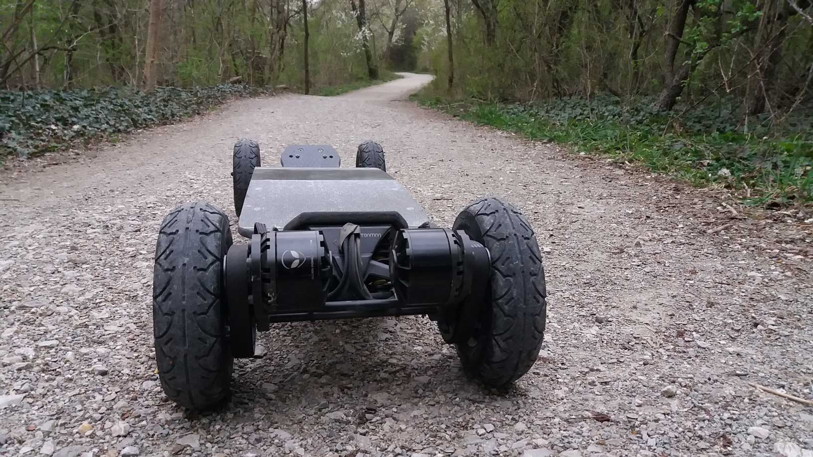

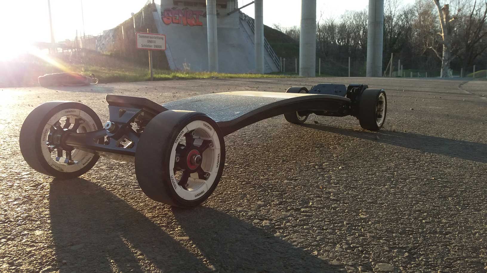

For commuting I prefer an AT board (in my case urban carver) with undermount enclosure and 7" pneumatics without bindings. I can ride almost everywhere from grass, gravel, dirt or whatever if necessary. I commute 20-30 minutes to work in the city and with 7" I never have to get off the board. Even with 125mm urethane many curbs are too big which sucks. The range is not great with 10s4p but I like the slim look.

Here urban carvers mini vs. normal truck
street carver deck vs. holy pro
The carver deck is quite narrow in comparison to holy pro.

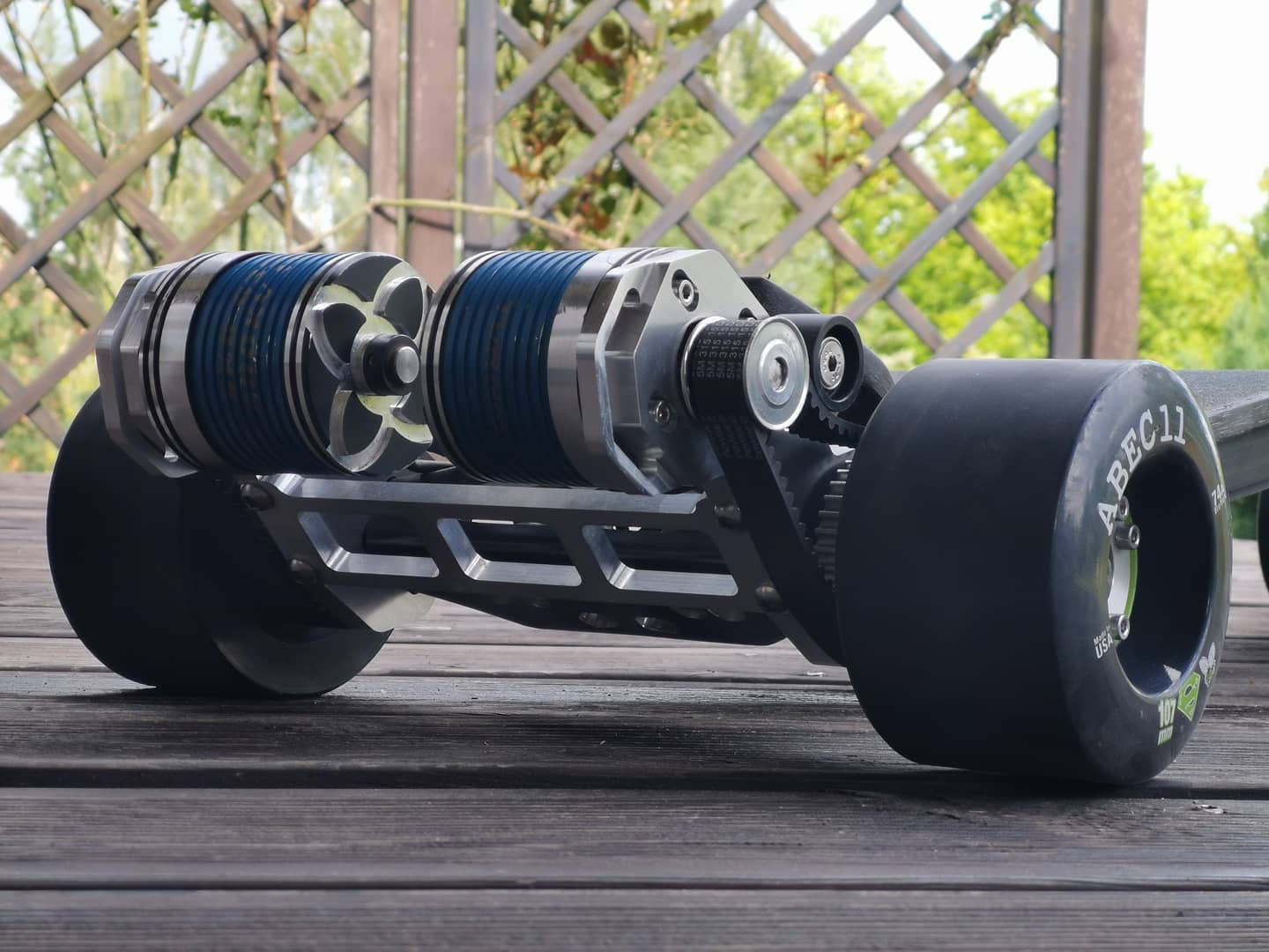

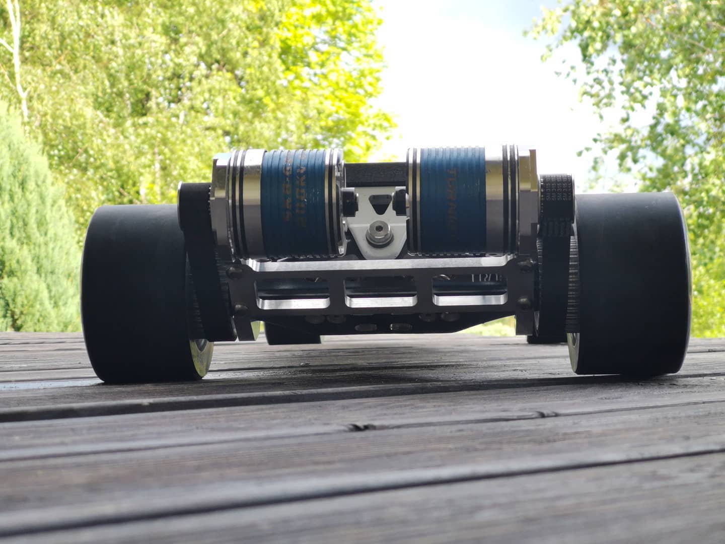

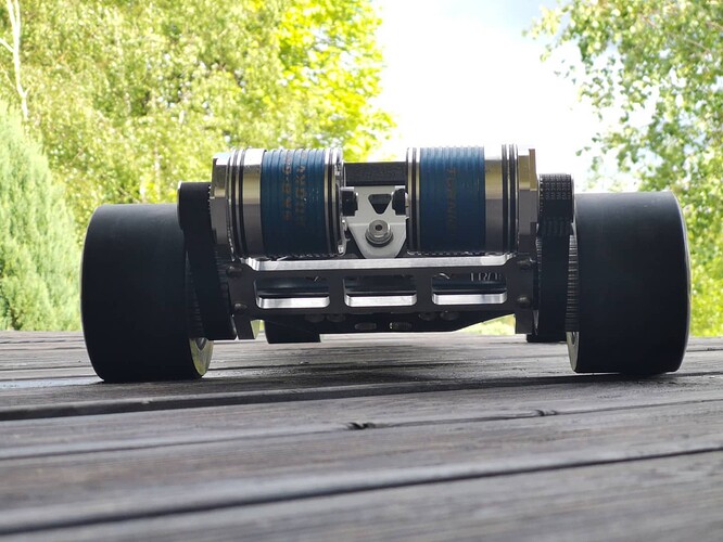

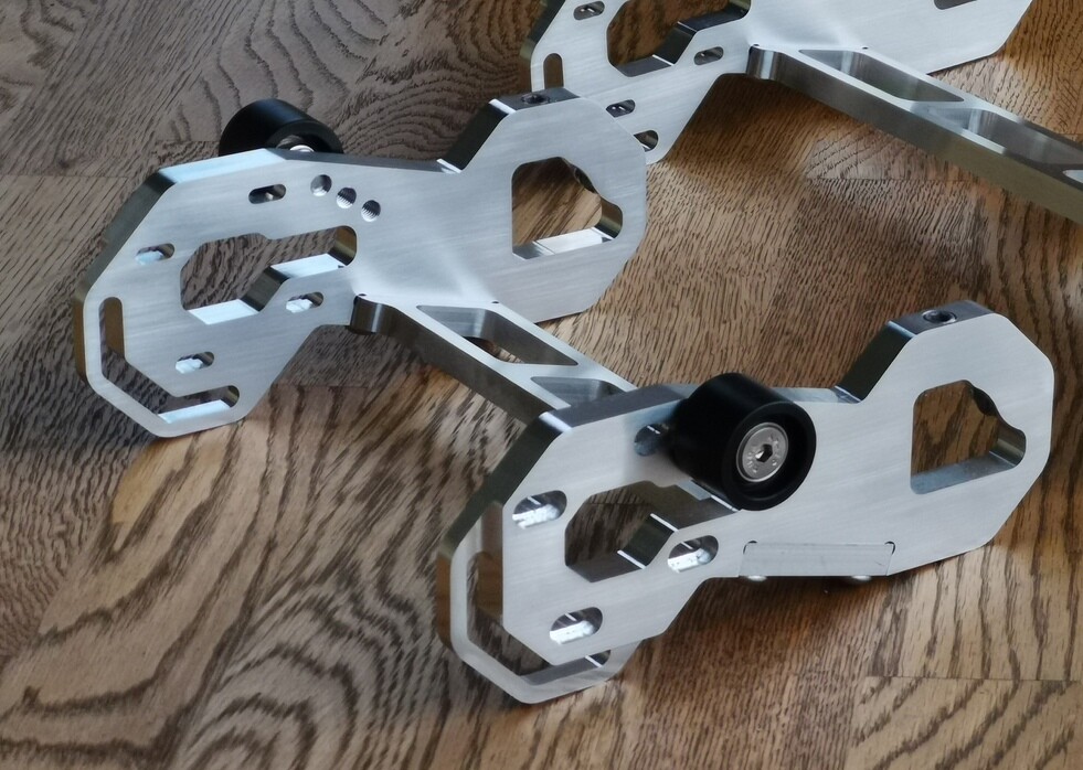

How is this possible? Did you mount the bottom crossbar?
A crossbar is required to hold the motor plates parallel to each other.

I got the version with the adjustable bottom crossbar, it’s possible but hard
