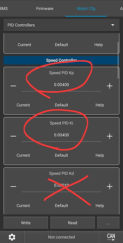

I kinda went wild and changed these to 0.05 and 0.1 and didn’t really feel much of a difference which is why om wondering if this setting actually does anything for current PID
Are we sure this isn’t for position control mode?
