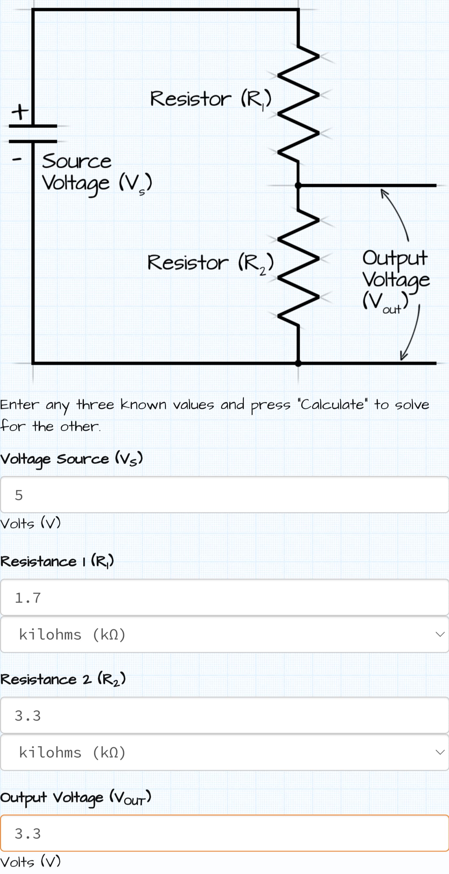

So, I ran into this issue myself as well. Almost all ebike throttles are 5v halls with a 0.8 to 4.2v range, which means the ADC1 misses out on a bunch of throttle range. This reared it’s head really problematically for me as I am using a “mid point return” thumbwheel throttle which springs back to the middle and holds at about 2.4v. That means I get 0.5 → 2.4 for regen and 2.4 → 3.3 for acceleration (due to the vesc not reading above 3.3). That’s 1.9v of range for regen but only 0.7v of range for acceleration, which makes it feel SUPER twitchy.

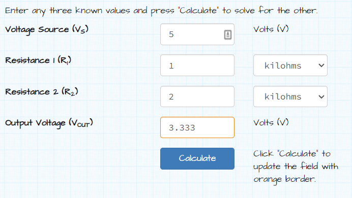

Thanks to a quick consult with @kevingraehl I figured out how to wire up a voltage divider so that the return voltage on the signal line is scaled down to 0.3 → 3.0 range. Now I get the full usage of the throttle with both accel and regen behaving at the same scale.

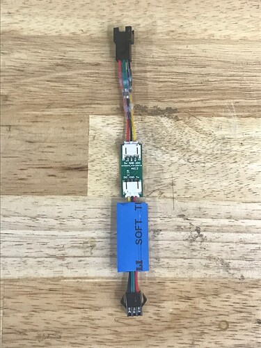

Here’s a photo of how I wired this up:
Some notes:
- I only had 1k resistors on hand, so for the 2k section I just ran two in series
- This is clearly the most professional job done you’ve seen
- Excuse the odd part of mine where I cross the black/green, my throttle is wired wrong and I had to adapt
- My diagram is probably not, uh, engineering accurate, but does work
Overall, this does the trick really nicely and I’m happy.

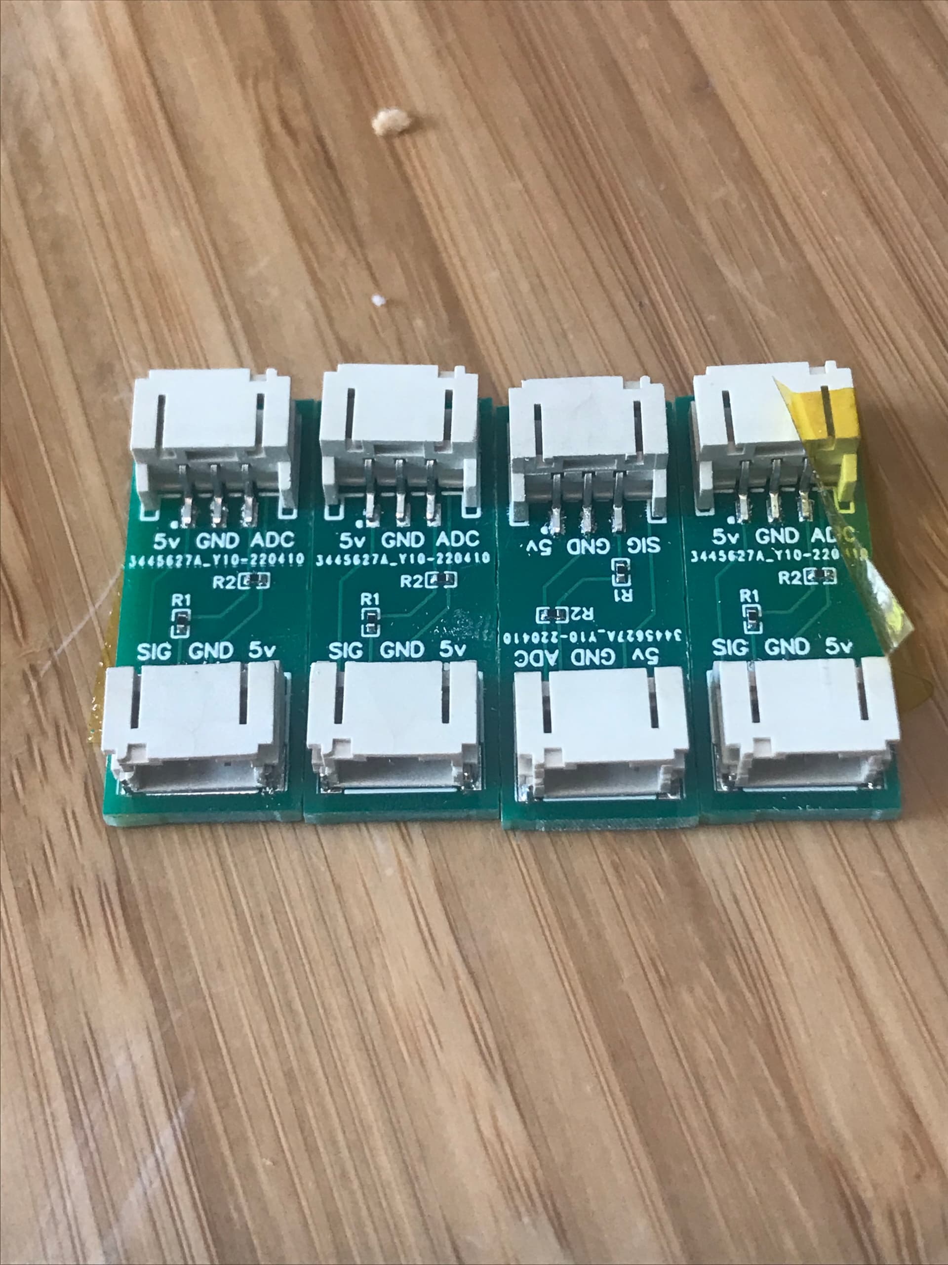

So, heck, why not have some fun and make this a bit nicer.
Send it off the https://jlcpcb.com/ and about 10 days later…
Noice.

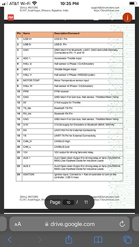

Where does it say that? Not on the image there.
I still see nothing saying it’s okay. It’s not that hard to just ask them.
This is true according to @kevingraehl who sold it to me.
I went ahead and asked them, since you seem to have a phobia for no reason at all
I wrote them days ago. I got ahold of the guy who sold it to me. No phobia here. And they confirmed what I wrote?
Did u call India?
You got ahold of the manufacturer, or a private seller?
The manufacturer replied and states 5V input voltages are fine on the 3shul ESC
