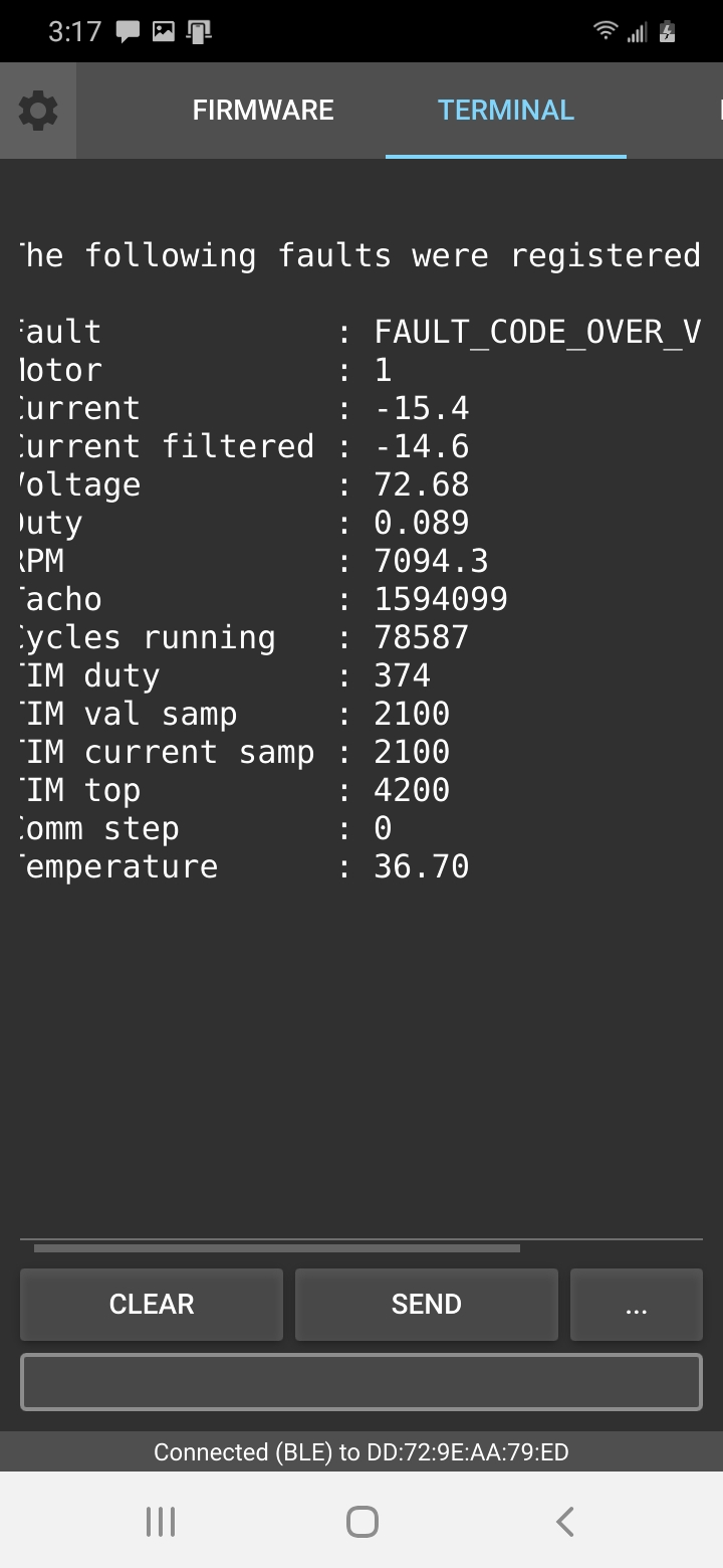

I just swapped from belt to gear drive and on one super hard brake test I had a overvoltage, so… yes.
16S ubox 140KV 6384 on bn-at 5.25:1
