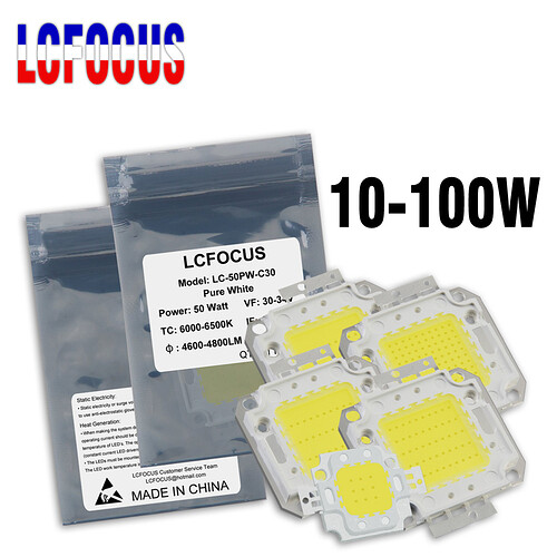

As per the original question/scenario maybe you could make a 400w dump load that you switch on at the top and switch off at the bottom. You can get 100w leds now for a few quid but they need cpu type heat sinks.
Could make a snap on snap off unit or just a 400w front light bar from hell lol.
I live on top of a three mile hill and just set off at around 90 percent on a meepo. This was fine till the esc components wore over 1500 miles and one day cut out down the steepest hill ive ever seen in my county. (I replaced the battery with a bms bypassed one and still cuts out so i dont think it was worn cells)
I have two of these 100w cob leds. At 56v in series they will draw almost nothing but 60v and over start pulling hard. Maybe i can set these up under my esc heatsink hmm
£1.51 | High Power LED COB Chip 10W 20W 30W 50W 100W Light Warm Natural Pure White For DIY 10 20 30 50 100 W Watt Outdoor LED Foodlight
