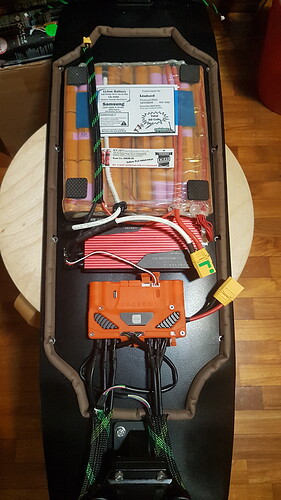

Second bad stack as a result of a discharge bms just shitting itself for no reason. Anyone know what the bms is in the bioboards thorium? Its a big red thing.

Yes it looks very much like that
