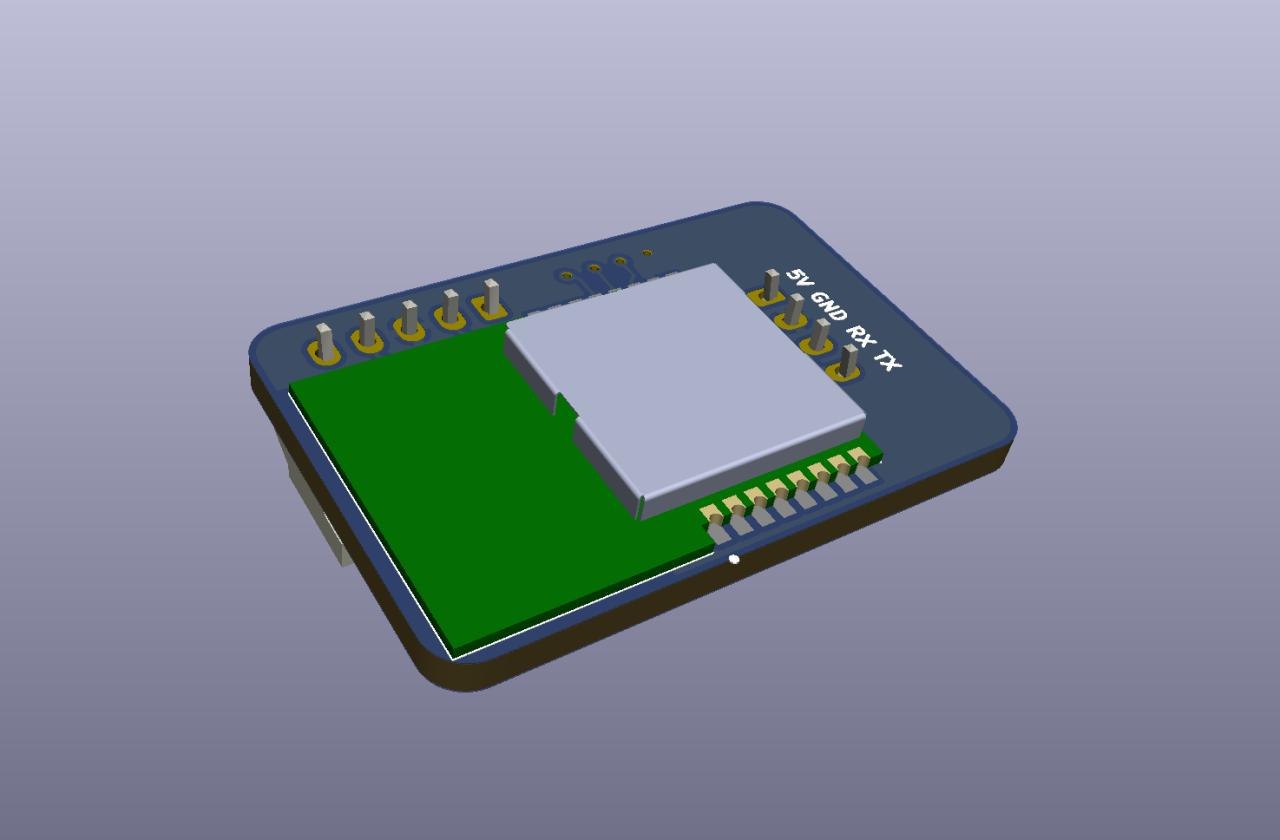

You guys can plug a GPS module also right? Can update the time from there
Thatā€™s correct, thereā€™s also a GPS module upgrade port which would also have an RTC, but not everyone is going to have the GPS upgrade + we want the Robogotchi to be fully functional by itself.

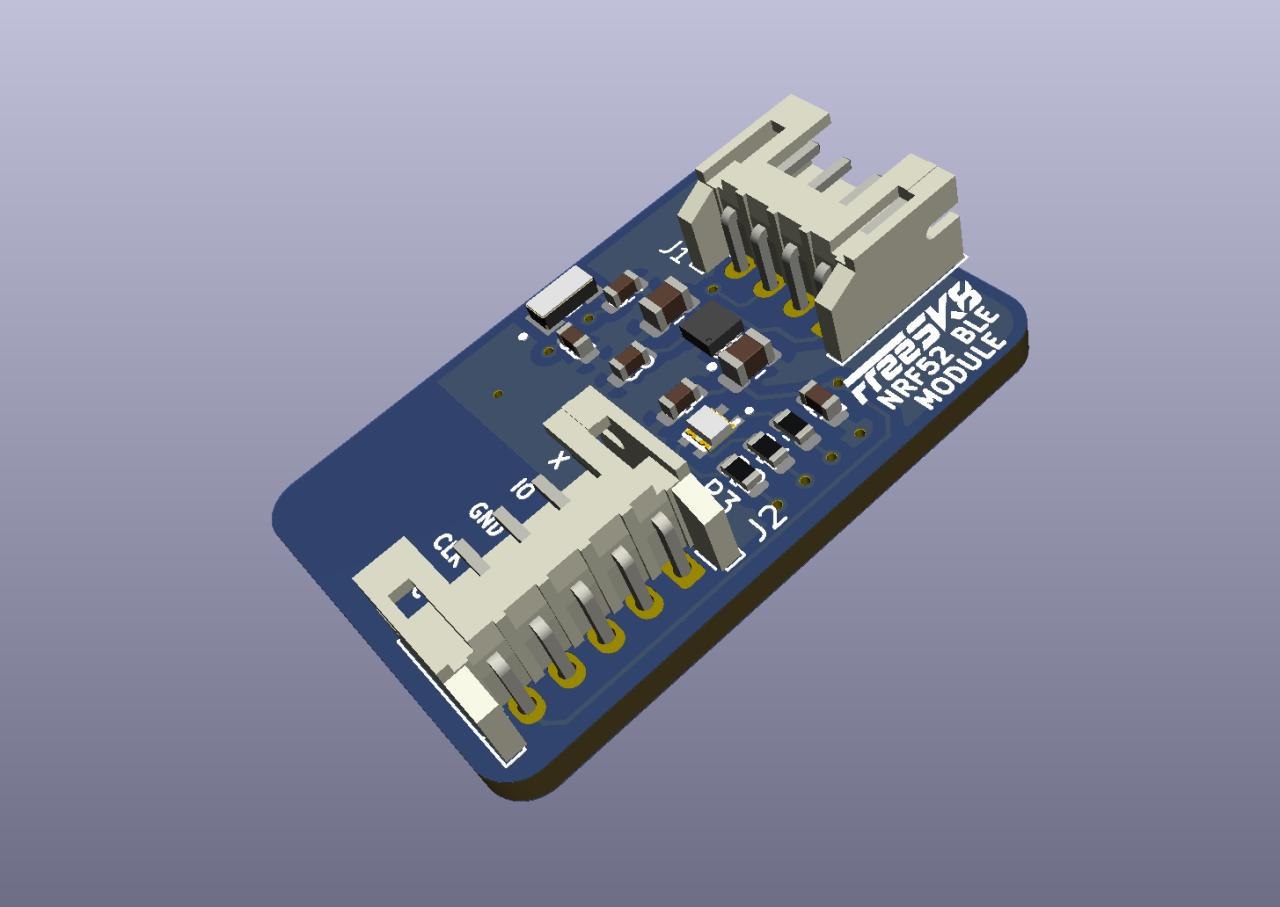

We also have the FreeSK8 NRF52 BLE module, which serves as a drop-in upgrade for existing NRF dongles. Higher power transceiver + external antenna option. Should be ready at the same time as the Robogotchi.
