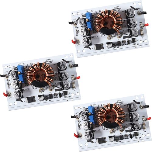

Whoever said to stick with DCDC converters is probably on to something - I should try to find a 12V to 50.4V converter.
Maybe this one?
or is 56 too high for 12S?

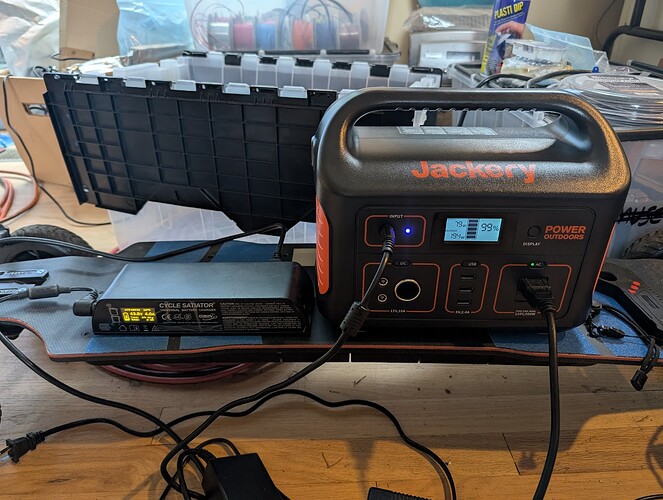

On a whim and because it was a pretty good deal (renewed) I ordered one of those Jackery power banks - 500W. I think I can probably trickle charge it from the car’s 12V and then use the AC port to charge the skateboard. We’ll see.

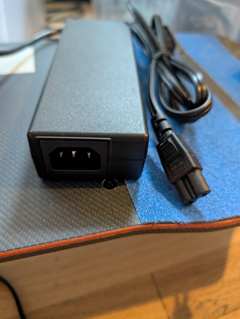

update, this thing has arrived. As near as I can tell the discount was due to the following power cord anomaly which took all of 30 seconds to fix:
Everything else seems to work fine.

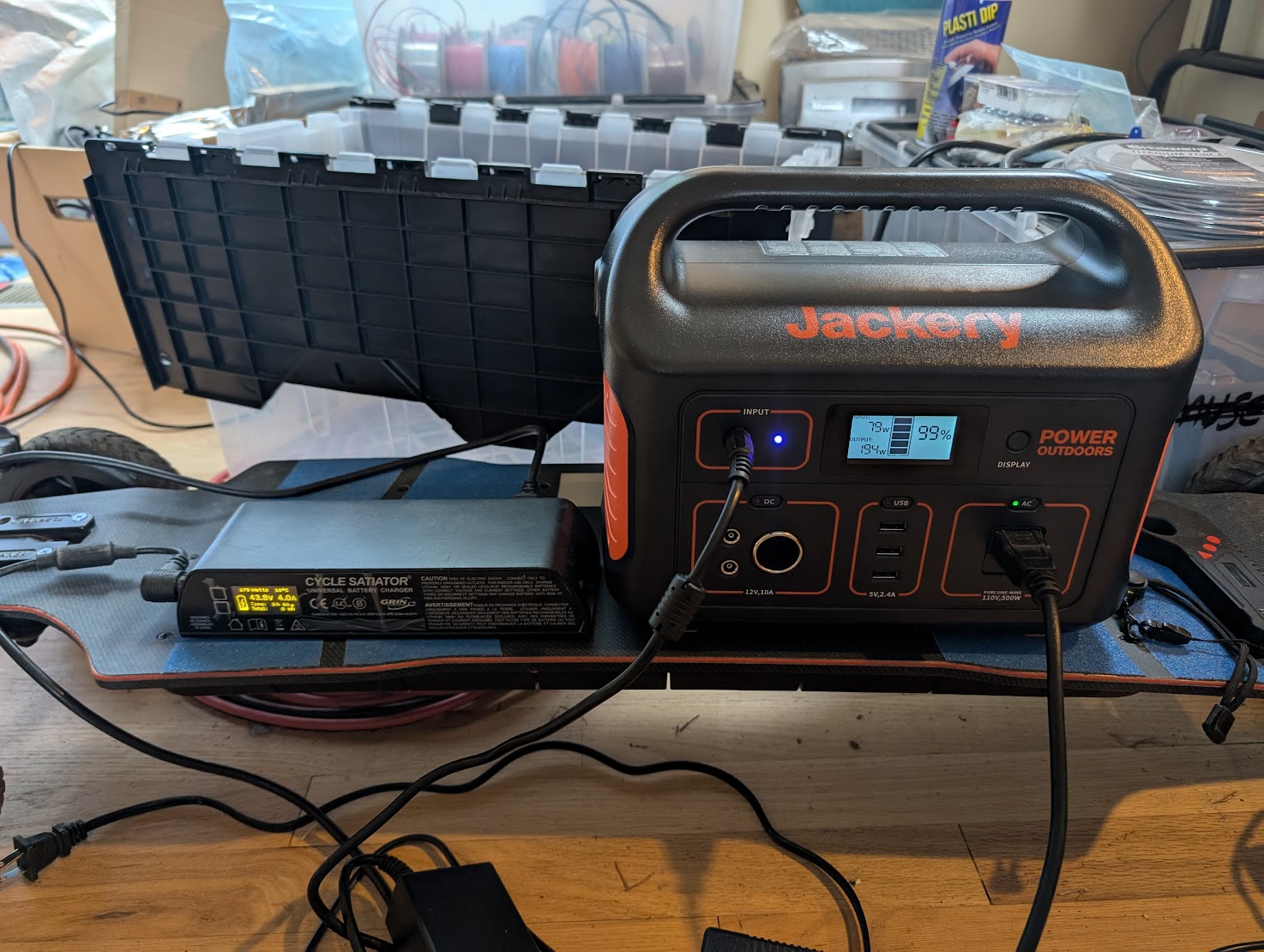

It will take an input and deliver an output at the same time (it even has MPPT for solar input). So here it is driving the Cycle Satiator.
Assuming I get the same 80 Watts in from the Cig Lighter adapter in the car that means my net loss to charge is ~120 Watts. at 500wH of capacity that means the batteries will run for 4 hours.
Unfortunately I don’t remember what the charge time is on my boards, but it’s certainly less than 4 hours.
So it will work - I will be able to charge my board while driving to the next destination :slight_smile:
