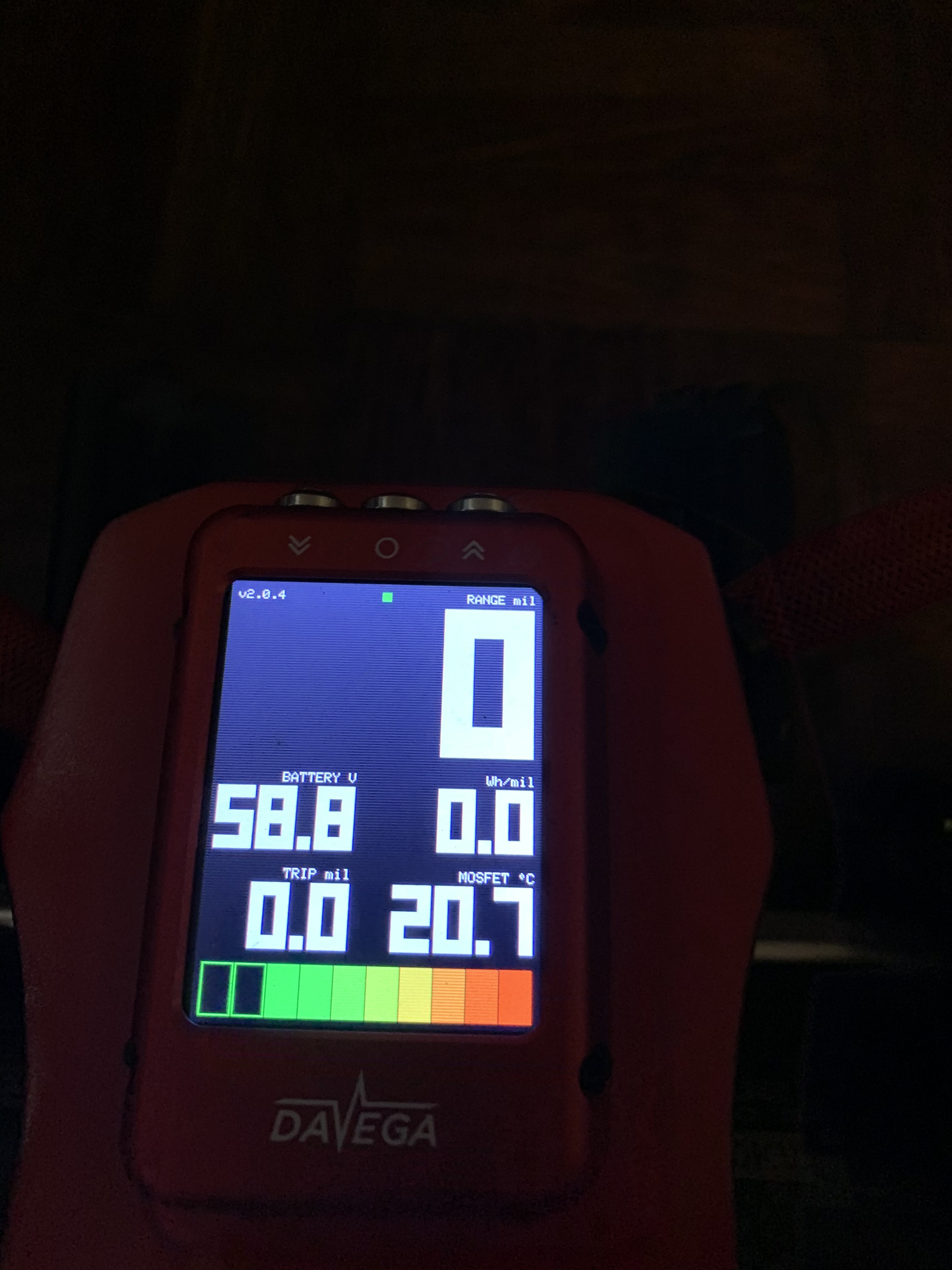

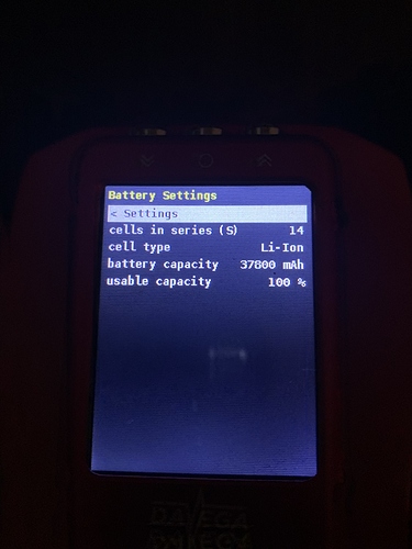

@janpom question for you. When I charge my board to 100% the davega bar indicator doesn’t fill up. The last two remain blank… is there something I need to change.
Currently runnin 14s not sure if that effects anything I made sure in the battery config I set it to 14s…
Anything else I need to change/update ? :eyes:
TIA :call_me_hand::penguin:
Can I have a screenshot of the battery config and the main screen please (the one showing the range in big numbers)?
Also, please check if resetting the session doesn’t fix this.

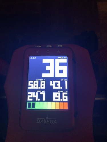

Yep yep here they are. This again is fully charged.
I’ve tried to reset the session still same outcome.
That’s very strange. I’ll take a look at it. Thanks for the report!

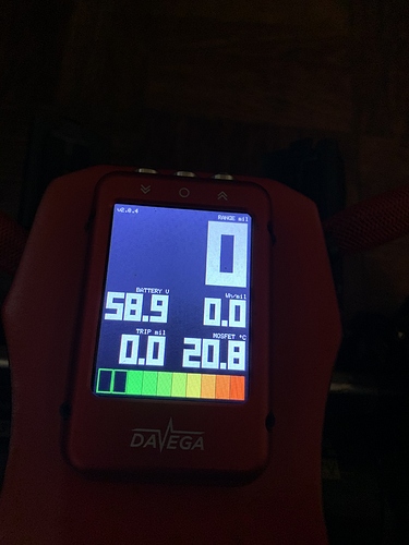

I’m unable to reproduce the issue. Can I please have a screenshot after the session reset when the battery is charged to 58.8V?
Yea no problem :call_me_hand:
Thanks! Huh, that’s weird. Could you please make an online backup? That allows me to look at your config and session data. Plus, I can install those files on my development unit and hopefully reproduce the problem.
