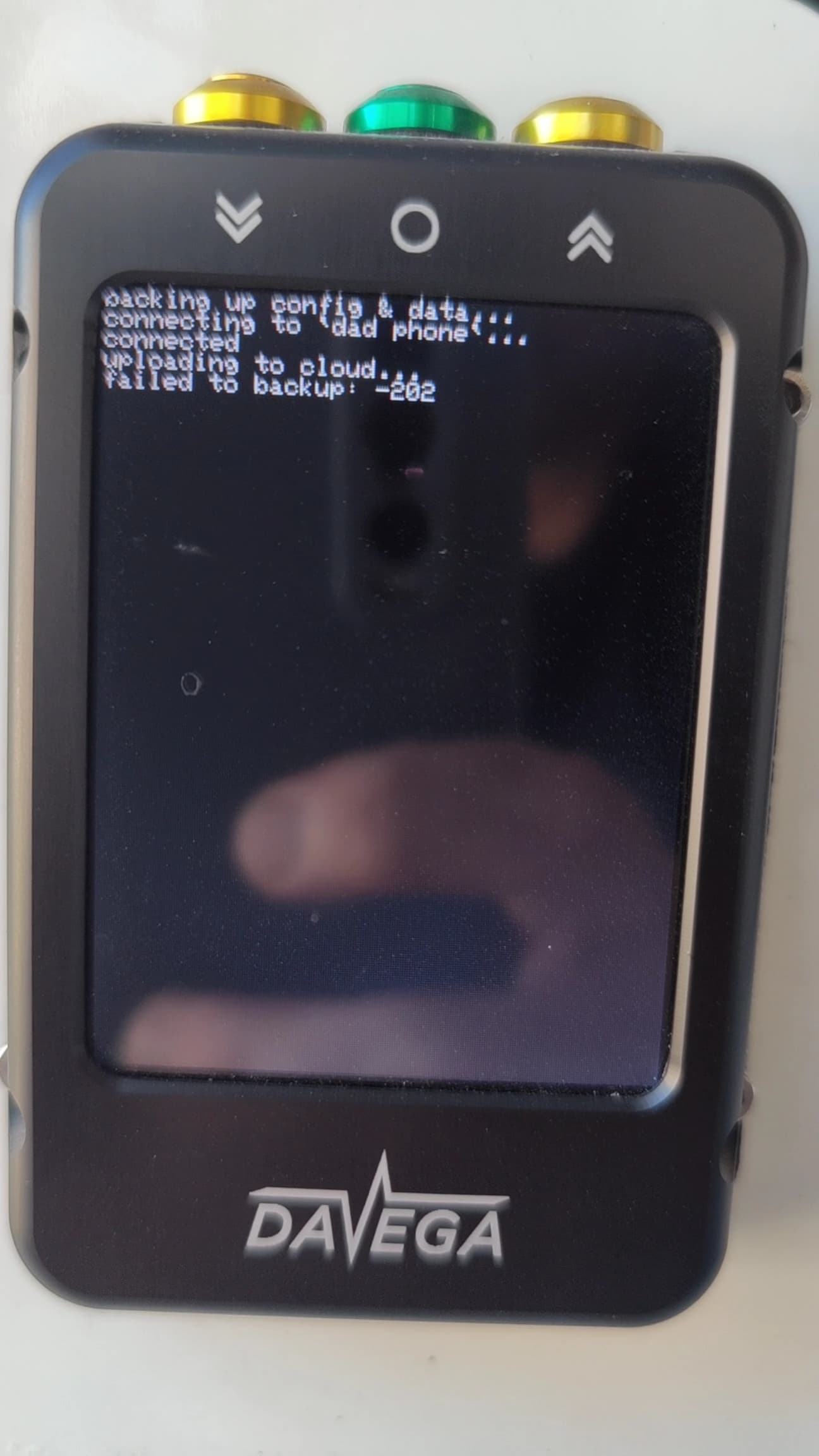

Here you go.
Sorry, I fixed it. I did a full reset and it connected, then restored the settings.
OK, great that you figured it out. I have never seen that error before. I’ll look into it.
