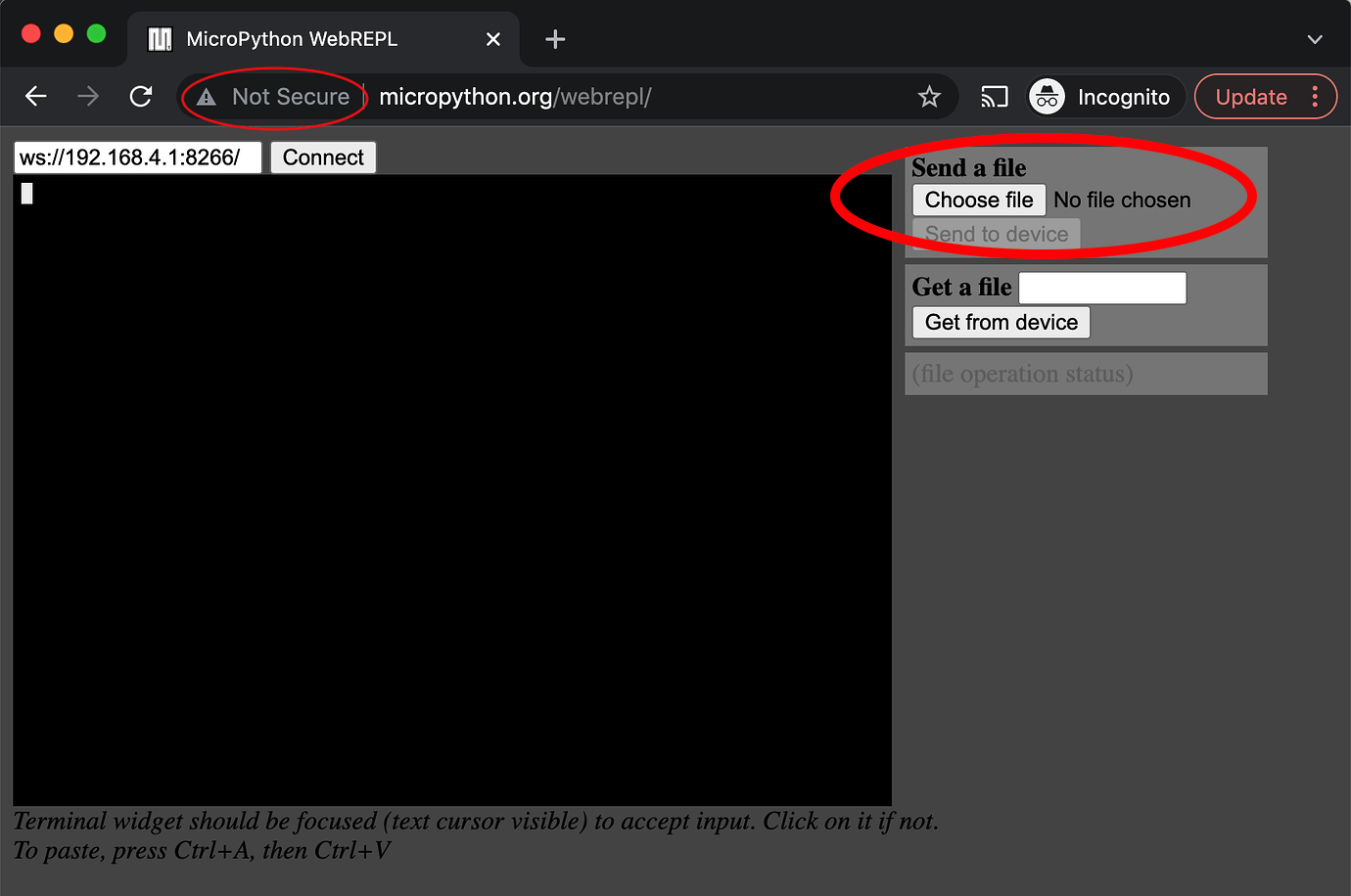

I did something wrong… halp :sweat_smile:
your code needs it’s file renamed, then try again
No dice
No, you don’t call restore. You create the start.py file on your computer (using notepad or a similar text editor) and then upload it to DAVEGA using the “send file widget”:
That’s it. No need to type anything in the terminal.
Oh… i did that like 10 times to no avail. . So then i started trying to type stuff :sweat_smile:
Wayyyyy over my head :rofl:
It says that it was sent, and shows up in the directory, but doesn’t come up with anything when i boot up with the button down :sleepy:
