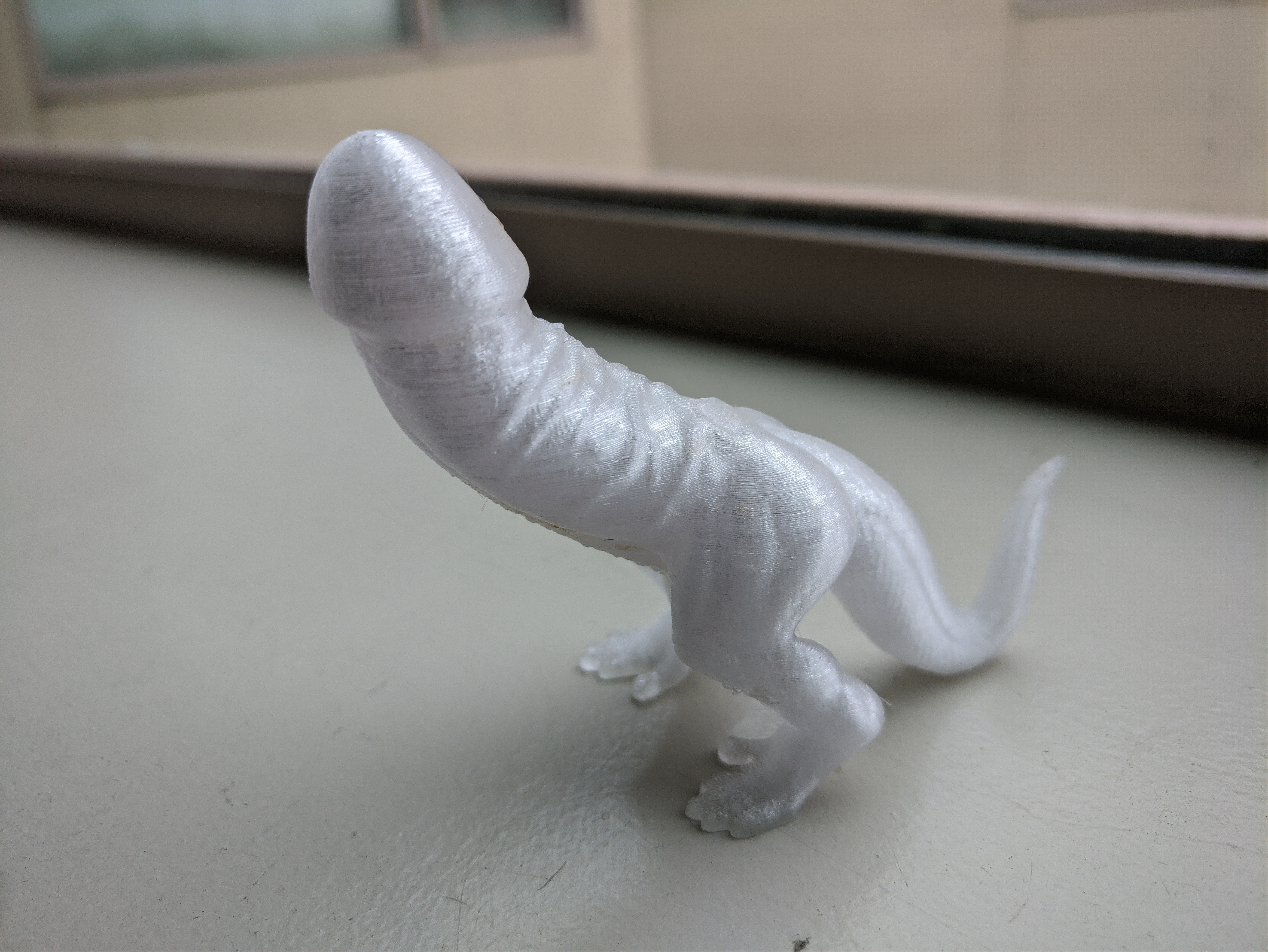

First print with this. .24 layer height because I was impatient and didn’t wanna wait.

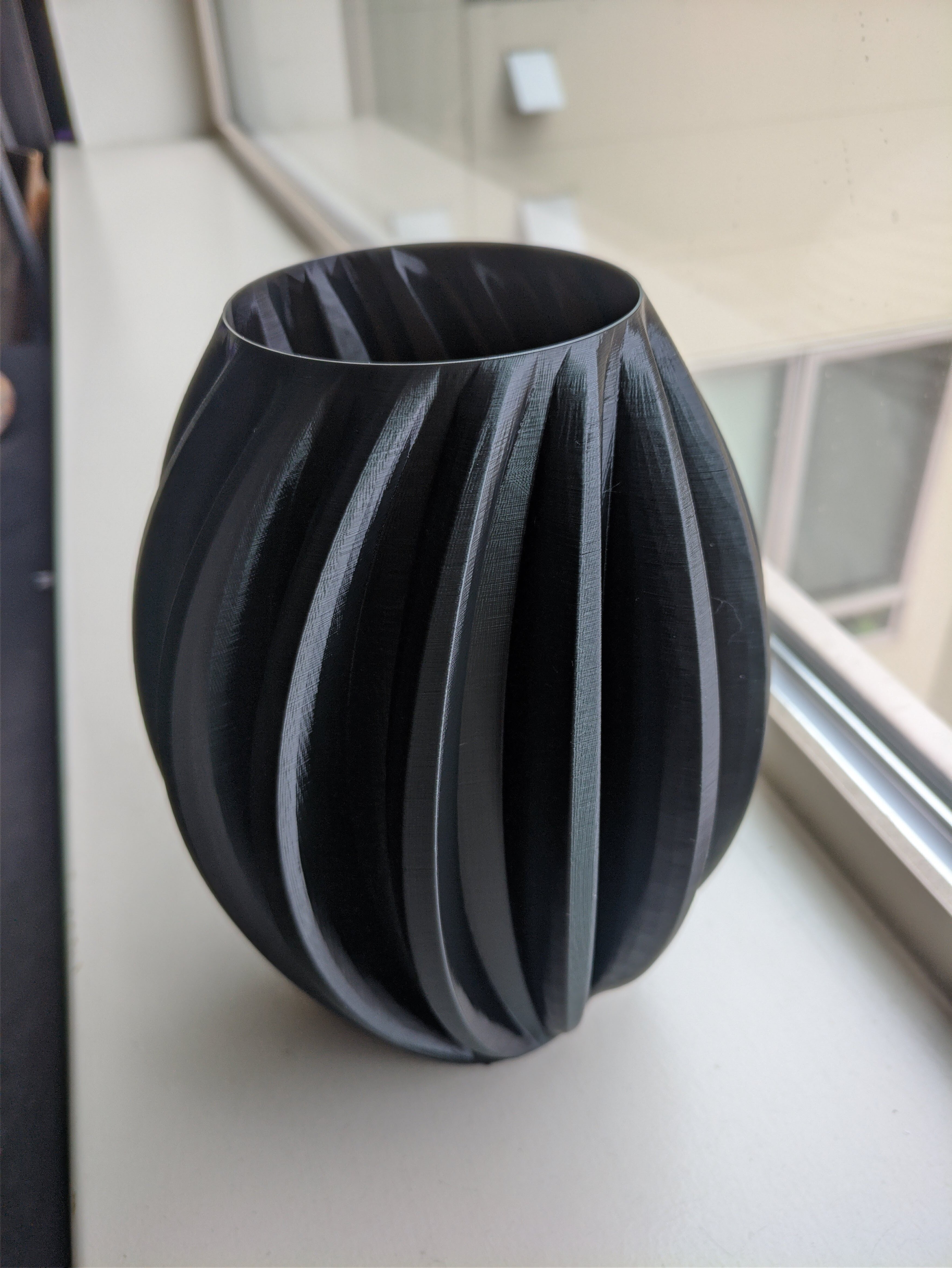

My lady wanted this for her desk at work. Printed in PETG 240/80. Came out perfect. I don’t see anything this wrong with it at all. I tried this print before going to direct drive and would get holes and voids where lines intersect. Thinking the dd has something to do with the print quality.
