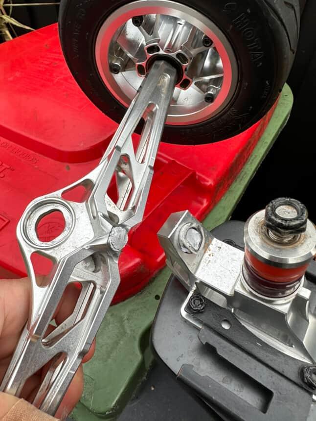

Holy shit! Is that piece literally just tack-welded together in one spot? That seems… insufficient, to put it kindly.

This is wild. One tack weld?
Think so

This doesn’t go very far to explain why the part itself wasn’t a fabricated engineered part to begin with and not a hobbled together failure waiting to happen under feet. It really doesn’t matter how long the weld is if it’s a poor weld and fails. If that’s a single peice, it.. you know, fabricated… would it have failed like that?
Also doesn’t go far enough to explain how confident and toxic he was about the strength of his trucks whenever any kind of criticism was brought up. And then when that criticism is proven right he doesn’t admit to it he just gives you a giant word salad that doesn’t include any responsibility being taken
All of this information must have just come to hand, I didn’t see an update before this shit show
Still waiting for your response as to why that weld was so shit and how many others there are putting riders at the same risk…
going forward what are you doing to eliminate the risk to your customers?

Yeah what’s going on? No recall with free replacements?
Didn’t he already say that’s what has happened with the affected parts?
“Updated parts were made and sent out to people using this setup. For Andys, we replaced and updated his bent and broken parts at no charge and replaced all attatching hardware involved with the bent hanger.”
Not welded by the same person I hope…
Is this part going to be manufactured as a single piece going forward? Wouldn’t that eliminate the dodgy as hell welding?

It’s the actual welding that’s the real issue here. That’s failure waiting to happen and hasn’t really been addressed. How many parts are welded like this? May as well have been painted silicone with the actual amount of ‘welded’ steel in that joint… aren’t you confirming the point, the material isn’t cast or CNC.. if it was CNC and of a suitable strength, likely that lad wouldn’t have been in that position.. the fact was that there appears to be a ‘rough enough is good enough’ attitude to critical safety items. That weld is certainly a one pass weld with no thought given to stitching the metals. Fucked if I’d put my feet on that sort of care and attention.
Safety in boards is a huge factor for me, quite simply, if I’d had his accident I’d be dead, the hand that added that blob of steel and called it welded and a job well done would be responsible for it.

You were, and in some instances I absolutely agree.. just not when it comes to this part. It EITHER needed to be welded properly or manufactured to resist the loads properly. Neither of which appears to be the case.
