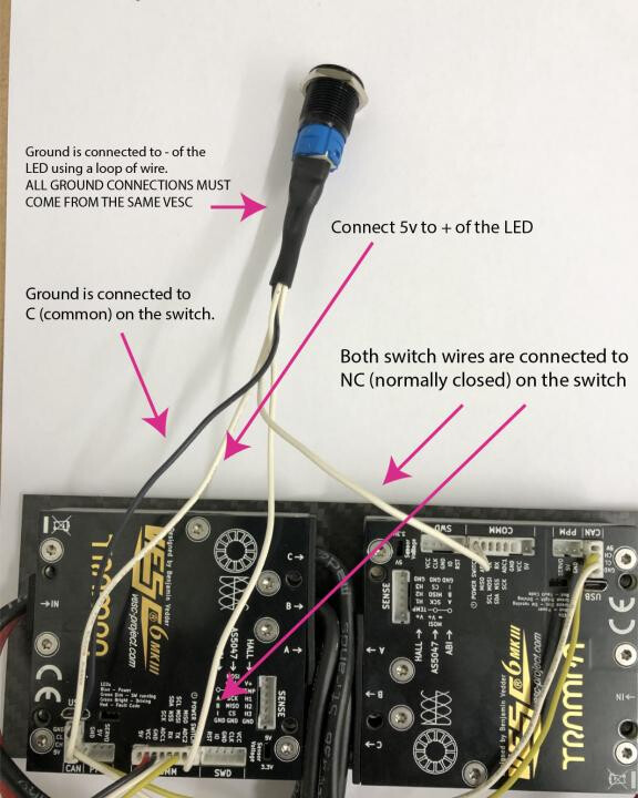

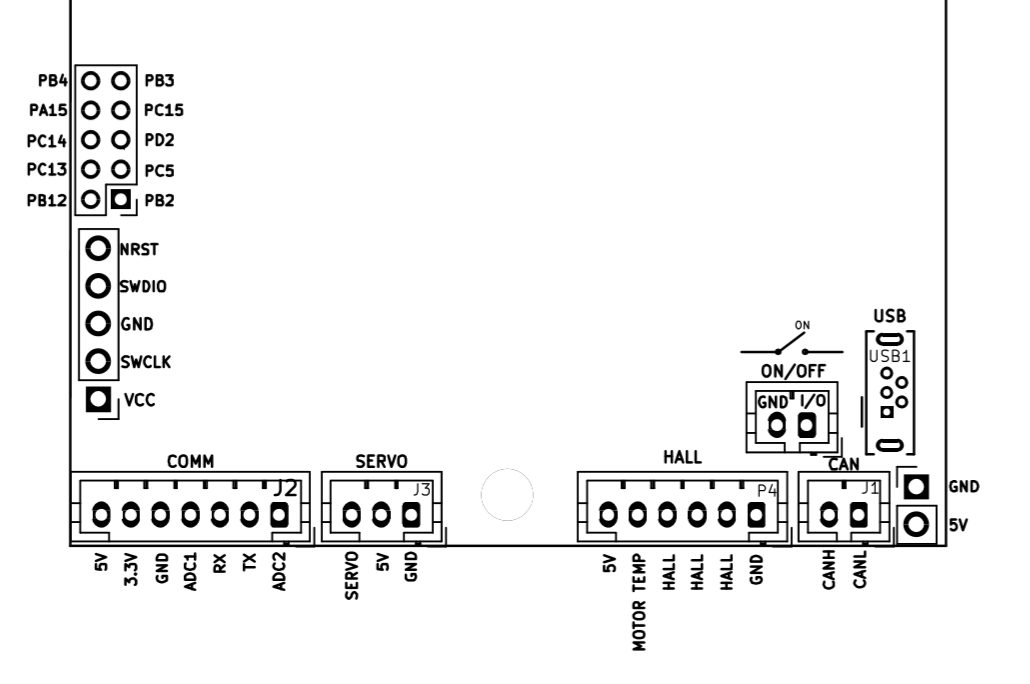

Someone can tell or show how to connect two FOCers in a one power button ?
put both I/O together and connect just in only one GND ?
