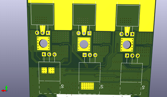

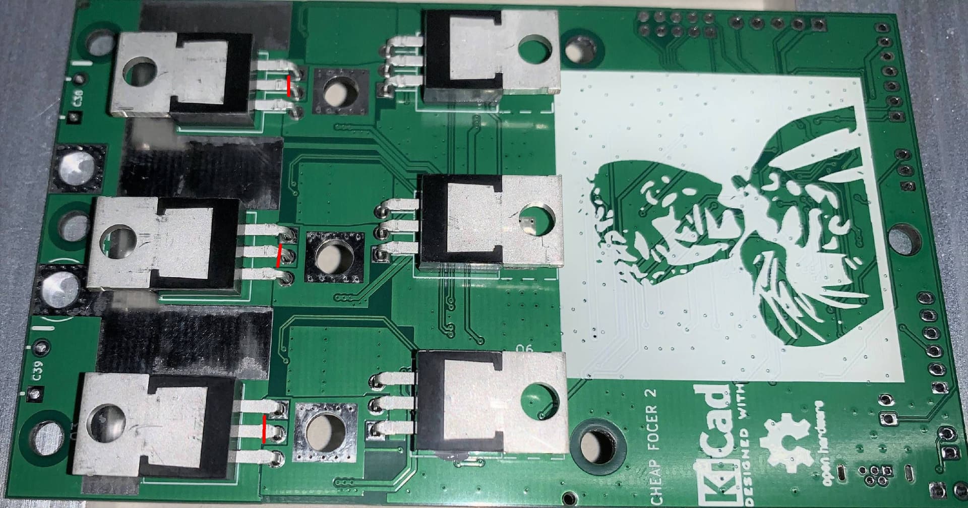

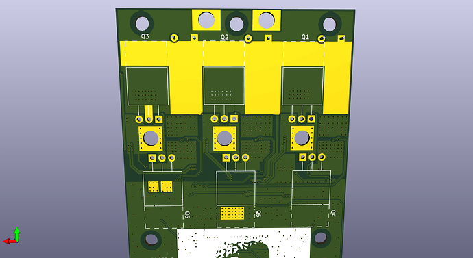

I’ve blown a few FETs on my CFOC2 (HW v1.0) lately. They are going in pairs (which I imagine is common), and I’m blowing the trace on the drain pin on the one on the capacitor side. Anyone have any tips to prevent this? Thanks!
@ziploc Have you got some pictures? How many phase amps are you running?
I didn’t take any pics of my board. There’s no visible damage to the FETs. This is where the traces are blowing out…
That is a picture of a cheap focer 2 v0.9 right? In the v1.0 there seems to have been an attempt to reinforce this trace as it is the weakest point in the power current path. Only on Q3 though, not Q2 and Q1. Did you test the fets if they are blown out? Or is it just the traces that have burnt?
If it is just the traces you could run a wire to bypass the burned trace.
That is the v0.9 board in my pic. That’s what was still in the assembly documentation for the v1.0 at the time I did mine.
And yes, both times the pair of FETs on a given phase were blown. Based on the behavior, it seems very much like one failed open, I continued to ride it for a few days, and then the other failed short.
When replacing the FETs, I did add a small piece of copper to replace the trace.
It might help if the traces where all reinforced like this:
