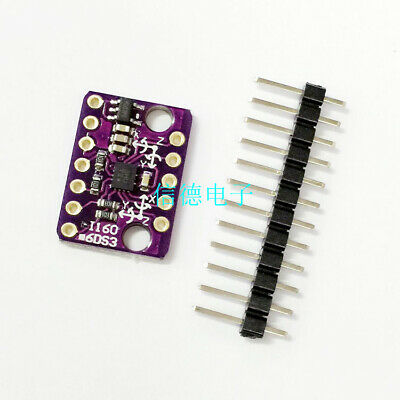

Cost wise, jlc is half the price of pcbway, but the biggest difference is that pcbway solders the bmi160 imu and that is a huge relief. I had an 80% success rate getting the imu correctly soldered and working the first time on jlc pcbs. On 2 of the pcbs, the ground pads lifted the second time making the imu impossible to get working. I have kept these pcbs for non-balance applications, but keep in mind, that is 2 out of 10 focers gone.

Just a thought here, but would it make sense on 1.0 to bring contacts out for the IMU so you could just add one of these with nothing but a Radio Shack wood burner?
