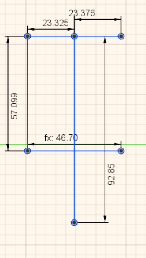

The .dri Gerber file has that info…
0.2441 3.7913
0.2441 1.5433
1.1624 3.7913
1.1614 0.1358
2.0827 3.7913
2.0827 1.5433
Thanks !
I tried to map it out in milimeters so its easier for everybody
