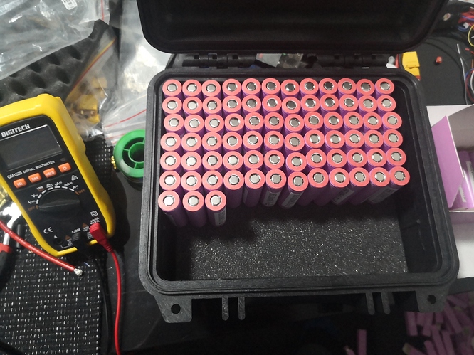

OK update I got the cells in today that I ordered from Melbourne on Monday so shipping was super fast. I just checked all the cells one in the black box read in at 3.45v second image cells on left read in 3.44v and right read in at 3.46v I’ll stop by the zape store tomorrow to find a balance charger to get the ones out to 3.45v so they are all the same.

I am pretty sure 0.01 V difference between the cells is fine. At least when I built my battery pack my cells were 3.43-3.45 V. Didn’t have any issues, sparks etc. when connecting them in parallel, and once attaching the BMS and charging, the series packs would get balanced.
