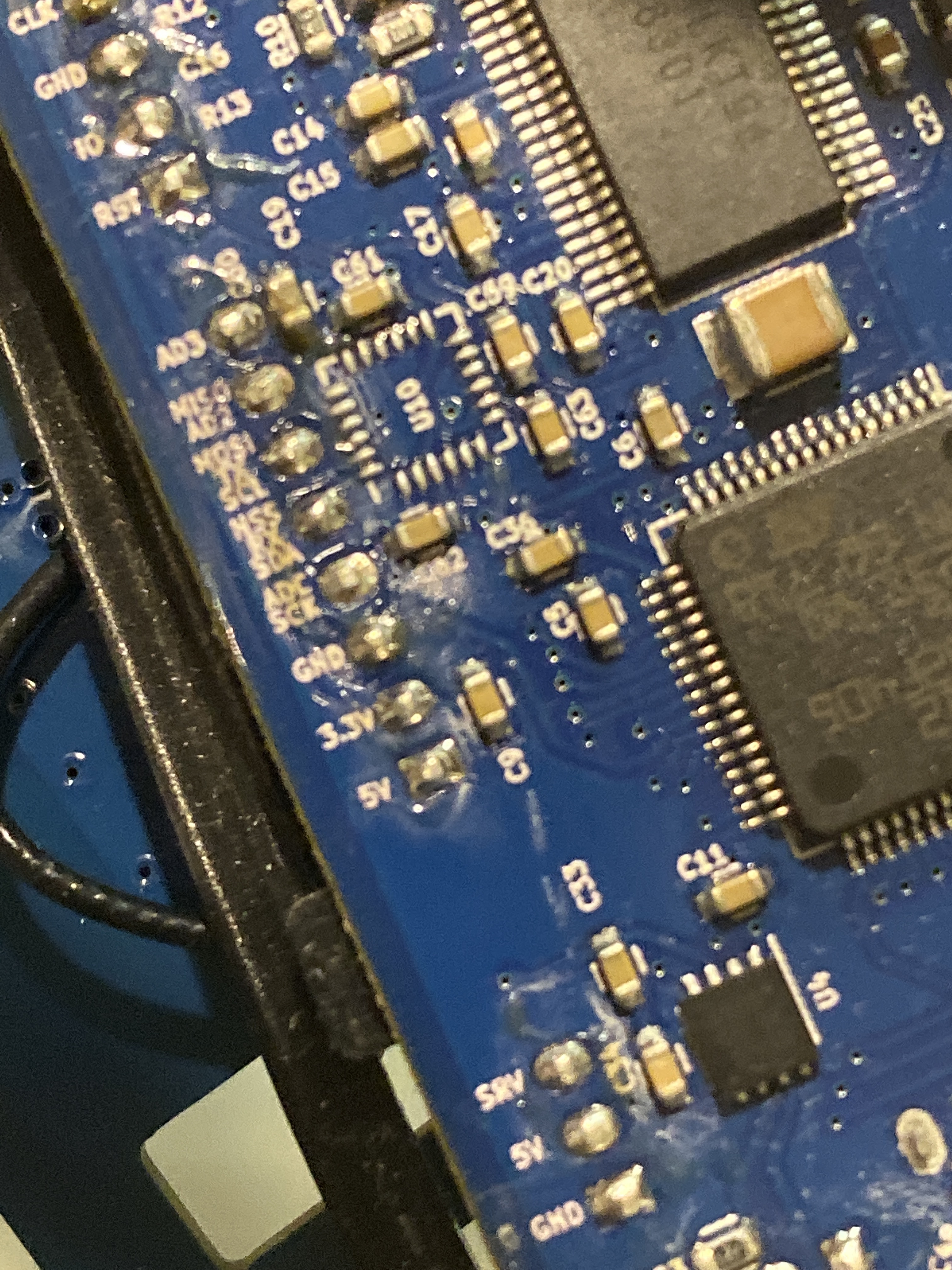

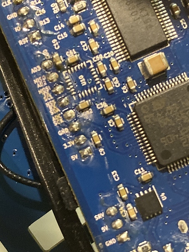

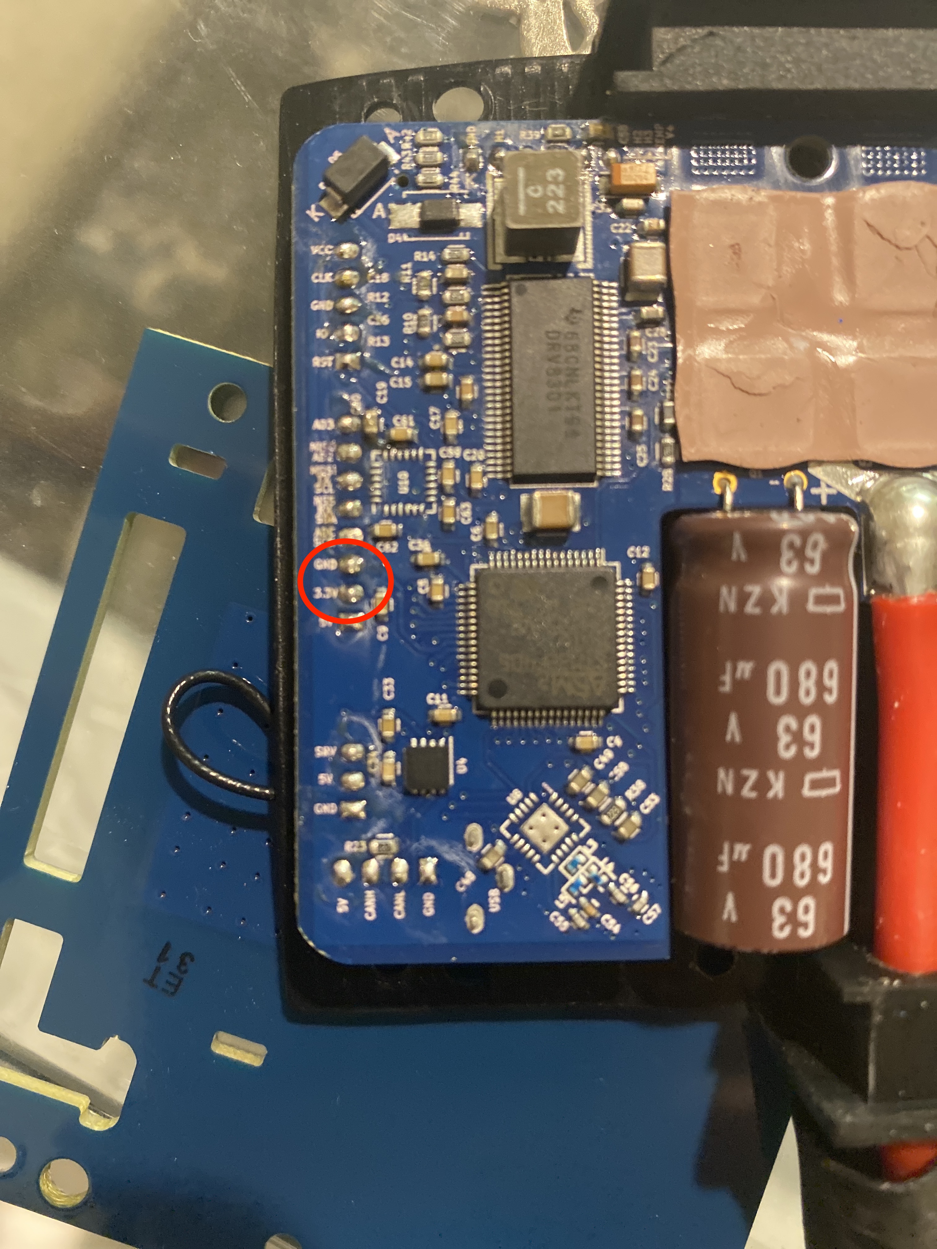

Both my TRAMPA vesc 6 wont turn on, FRANK, I NEED YOU
Check if those 2 are shorted
Does that look shorted to you?
You check a short with a multimeter not your eyes :rofl:
I’m stupid, lmao. I’m scared to do this. Which probe should touch what?

You don’t need to power up the board, just put the Multi-meter in diode check mode (or resistance) and put the Black lead on the GND and the red on 3,3V , you should ear a beep or the resistance should show 0ohm.
It becomes 0

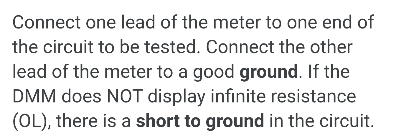

2ohms or less usually means little or no resistance and calls for a short to ground. In this case, something on that circuit is dead

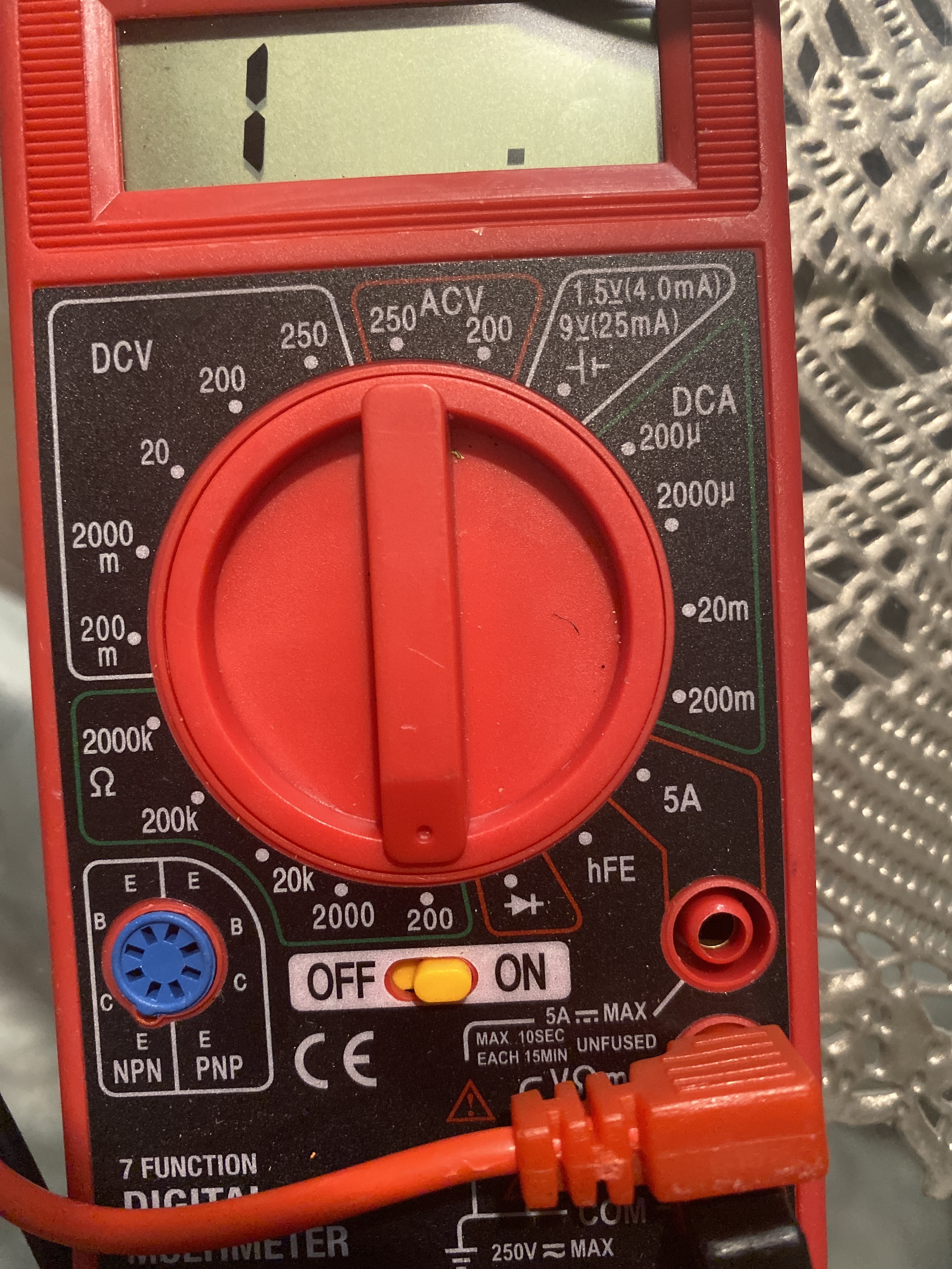

Wait, I might be doing this wrong
Lol :rofl:

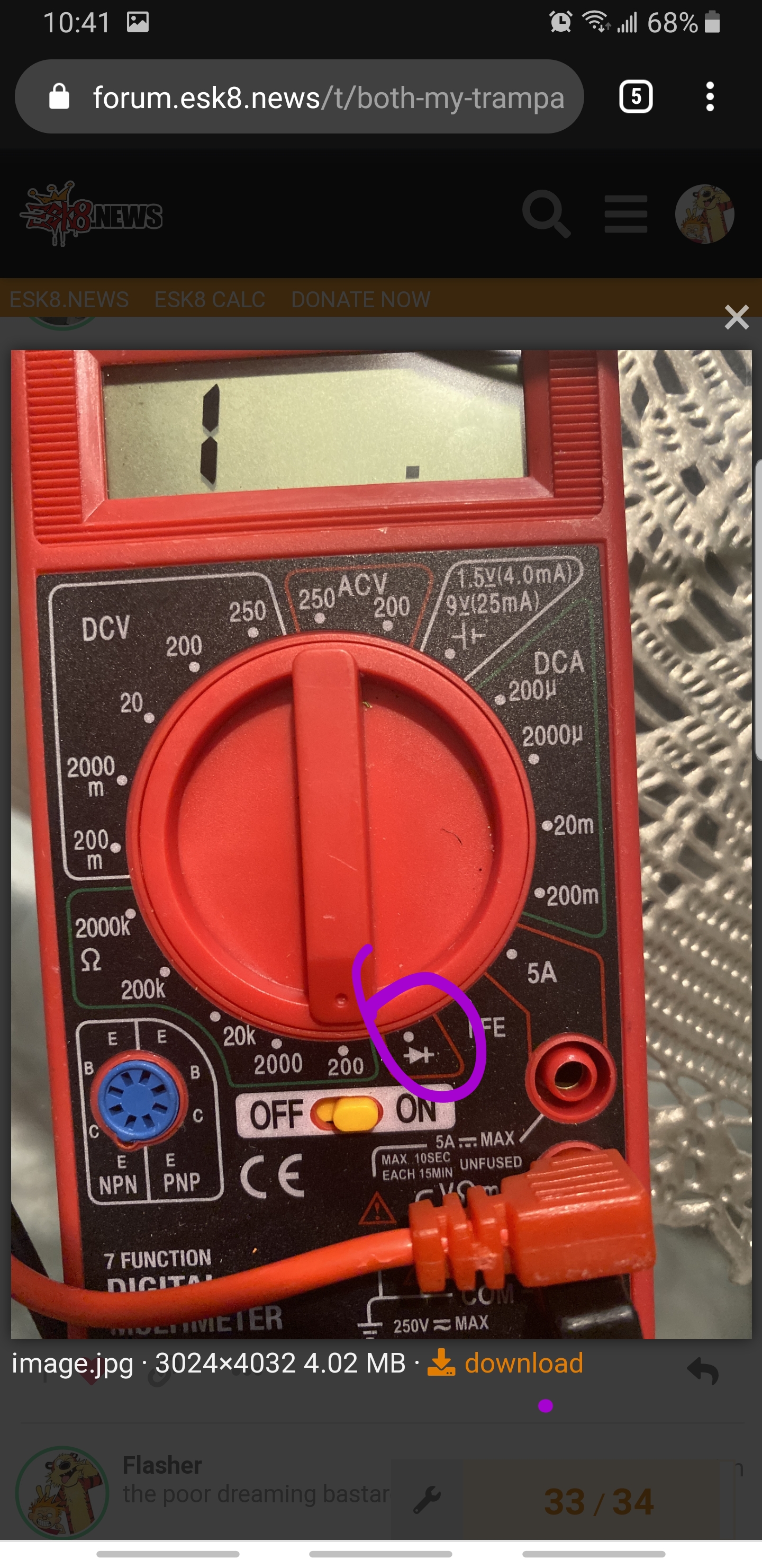

It becomes 1.4, I was on 200k before lol
Shitty harbor freight multimeter
001, is it shorted?
What do you get when you touch both probes together?
‎ 000
Your multimeter is confusing me…
