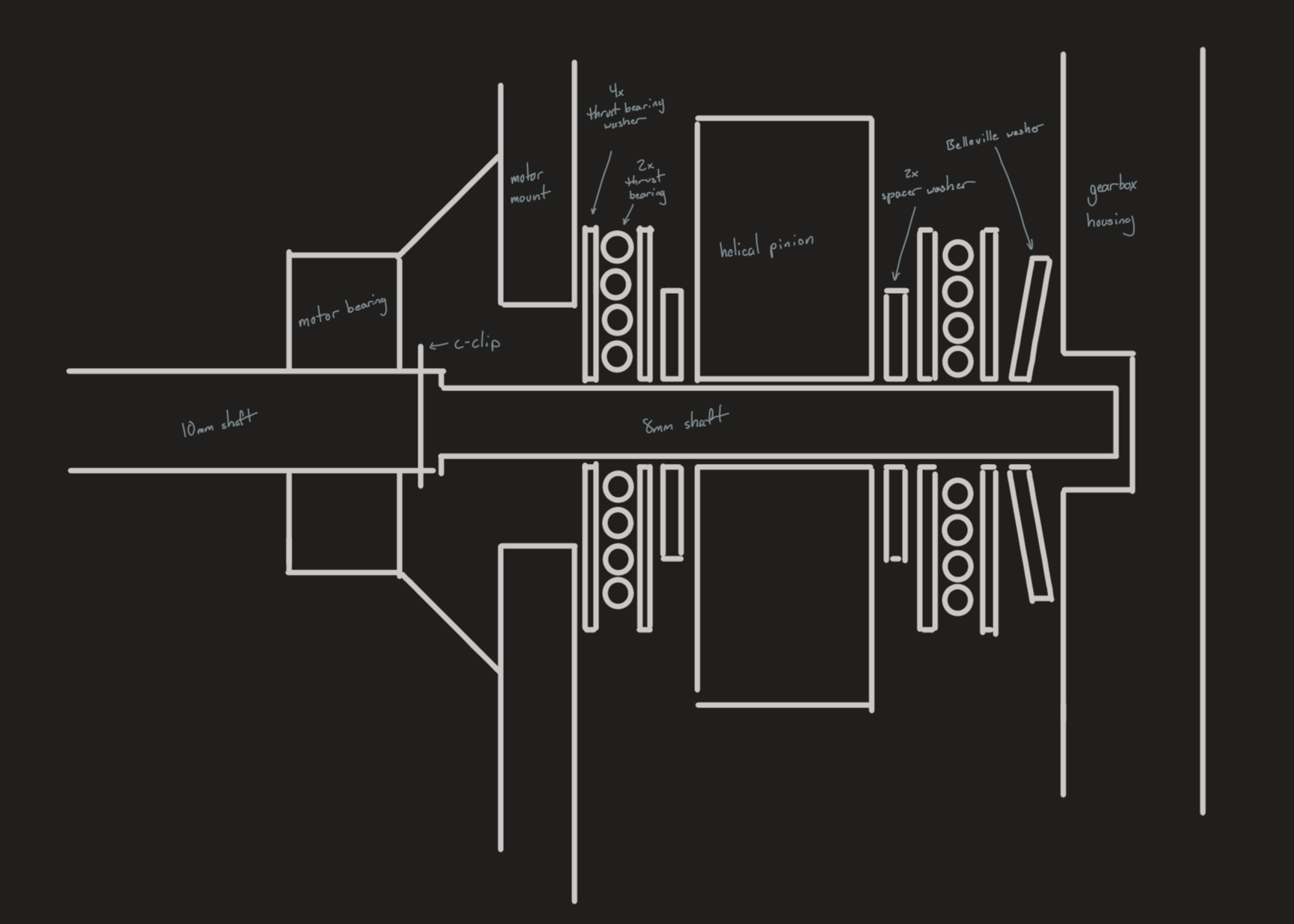

If you tap the end of the motor shaft and secure a washer there that will keep the key from moving out, and a spacer between the c-clip and pinion will keep the key from moving in
huh that’s an interesting idea. I wonder how hard the center of the motor shaft is. knowing me I’d probably end up with a tap stuck in the end of the my motor shaft tho lol.
Realistically you’re not gonna have much luck, it’s a hardened shaft and you can’t really put it on a lathe unless you remove the shaft from the can
This looks really good, I would love to see someone try this. However, I still dont know that I would trust that Belleville washer to take up the axial loads indefinitely.
Plus, I think the Belleville washer would end up making a ton of noise rubbing against the motor shaft.
Theoretically it’s only taking loads while applying brakes, otherwise it’s just preloading the bearings so they don’t rattle apart, so I think it should last long as the grease inside
The noise is a good point, maybe a bronze bushing? Flange to the thrust bearing washer and the Belleville washer on the shank
Your circlip is out of the groove. I would disassemble and put a new one back in asap

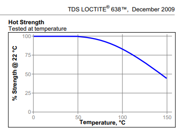

That wouldn’t be crazy, but 638 is a very strong adhesive (urethane methacrylate), and there is not any shear force, so the key shouldn’t actually ever come out.
638 also withstands heat well, so even if I’m burning up my gear drives at 100c, the adhesive is fine.
