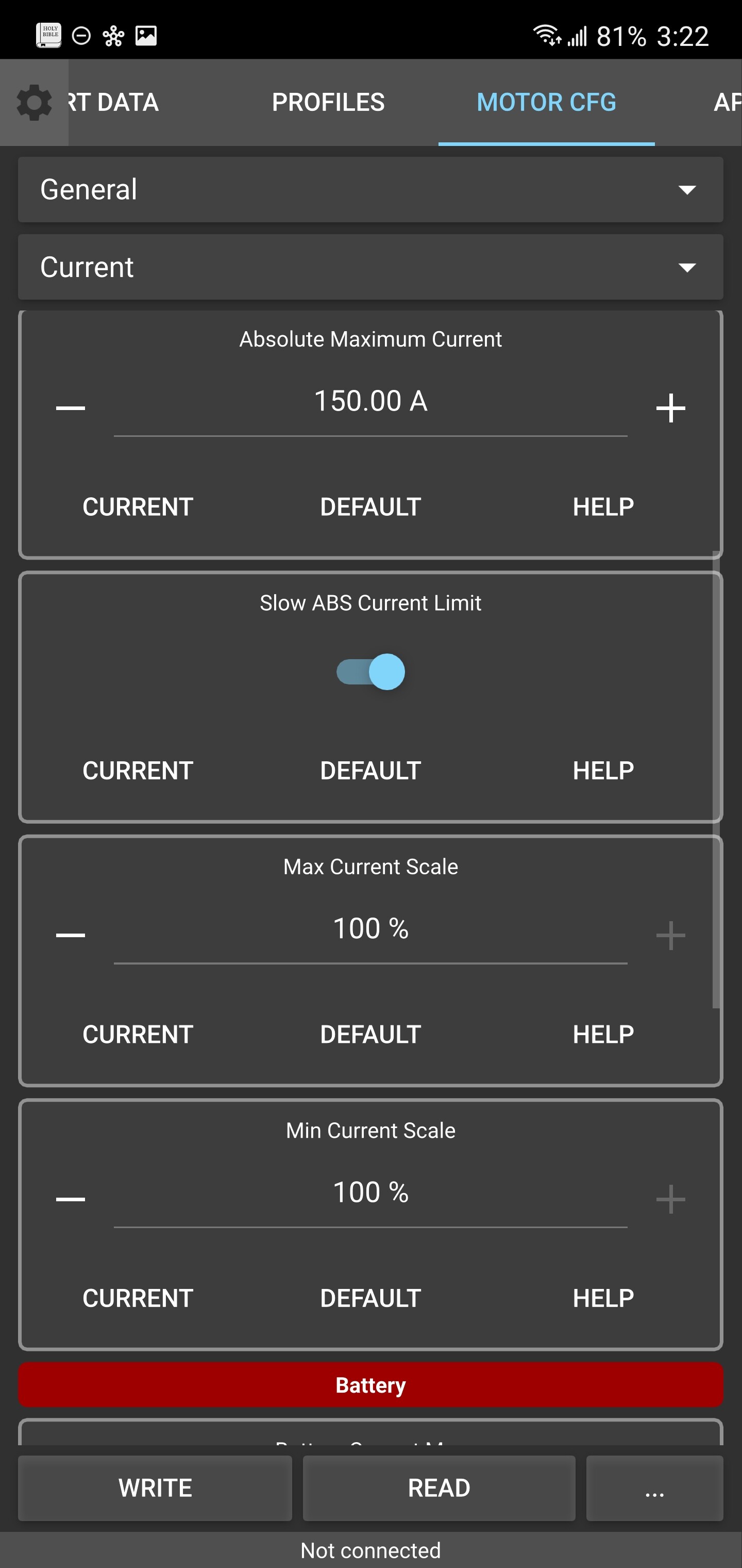

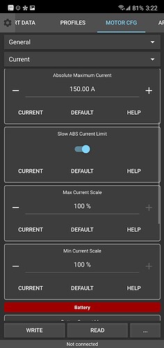

Board cuts out under full throttle, unable to map ppm

See if the board stays on. If you are disconnected from the app, the board turned off, this would be a battery issue from over current (would say undercurrent since you’re asking for too much power from it). If it’s still on, the remote isn’t fully set up and it’s a trigger value cut off. You can check to see your settings and re-work them.

Also, the board cutting off under load is probably not caused by the remote, but wrong settings in your VESC.
Absolute max is different from battery max. Your battery max is what your battery can put out and then split that by 2. Your absolute max should be higher. Mine is 150A since it came like that.
put 200a in it, vesc tool should back it down to the max it will allow u to set it at
when you go in motor settings you have the general tab wich have multiple motor type you want to choose BLDC motor then right under general you’ll see a BLDC tab you want to change the sensor mode to sensorless write on VESC’s to save.Then you want to put the proper min and max ERPM for the motors (max erpm is in general, min erpm is in BLDC)

Duty cycle current limit start adjusted to 85%?
