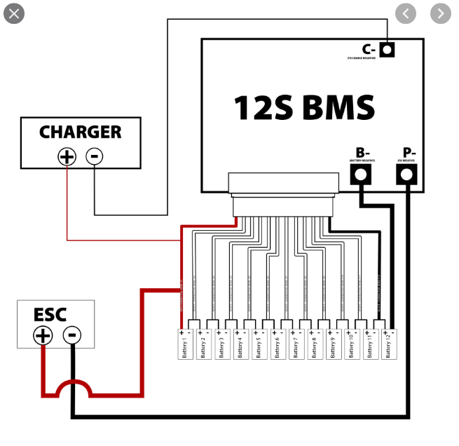

BMS Recommendations
holy bananas, that is confusing… how do I change this wiring schematic if I want bypass the BMS for discharge?

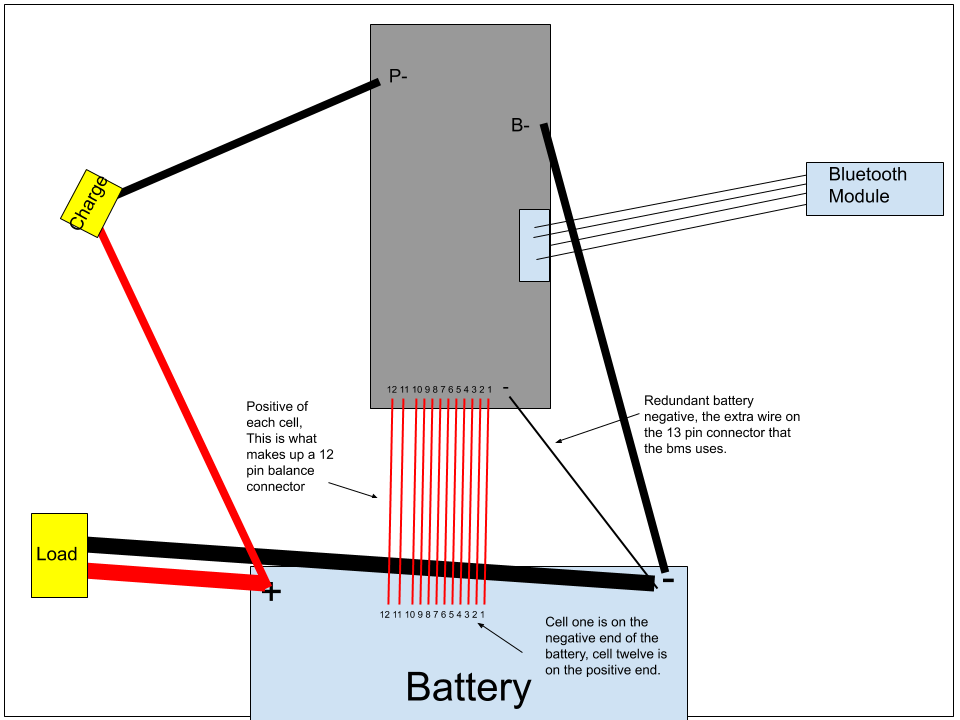

I’ll draw up something easier to understand.
Thanks dude. I really really really appreciate it.
I’m getting around to the wiring diagram right now. How many balance wires do you have on your battery?
Untitled drawing.pdf (29.4 KB)
If you battery has 12 balance wires, you will need to wire in that redundant negative that I mentioned. If you battery already has 13 balance wires, just pair them up to the BMS connector and your good to go.

Dude. It is hard for me to express how much I appreciate this. I have been freaking out about this step. I am not home right now to count but if I recall there are 13 of the little cables.
No problem man. At first I struggled a lot to understand this, so I’m happy to help you through it.

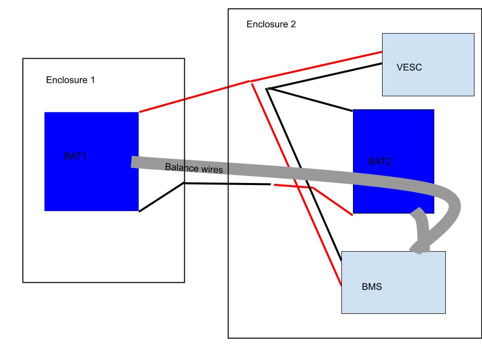

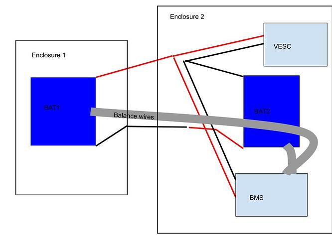

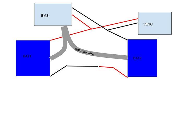

How I would do this is run balance wires from one battery over to the other side. It only adds one more thing that you have to run on the bottom of the deck. Then you can use one 12s bms. The long balance leads shouldn’t be a problem.
This drawing doesn’t include a power switch or charge port, but it gets the idea across. Depending on which enclosure has the bms, different wires would have to cross the middle of the board.

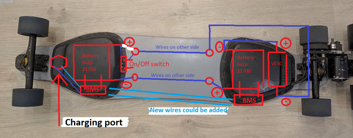

Image not representative, im gust imagining 2 batteries and added wires between them
So basically at this point there is 2 possible solutions:
  1. charge 2x6s batteries separetly at the same time with 2 chargers
  2. Use 12s bms and add wires to other side of the board for charging and balancing.
Is there any obvious highlights on witch approach is better?
IMO the one BMS approach is the way to go. Here’s why:
  • Adding an extra BMS is just adding another thing that can fail
  • If you put the BMS in the same enclosure as the vesc, you would only have to run one more cable(6 balance wires) along the top/bottom of your board.
  • Saves cost – you only have to pay for one charger and one bms
  • In the end, it is simpler. It may take a little more time to understand how to wire up, but you have fewer components and fewer wires to deal with.
Thanks for your advice. Im a bit confused
If ill put bms in same enclosure “i need to run one more cable(6 balance wires) along the top/bottom of your board” AND positive and negative wire for charging(as existing wires is for discharging and switch(Anti-Spark XT-90S Loop Key) is located at opposite side of the board and i cant use them.
Because bms cant charge through balance cables it only balances, and this needs charging cables as well. Isn’t it correct? Is this ok for bms to charge in this way? To me looks similar to my initial plan with 2x6s in series making it 12s
