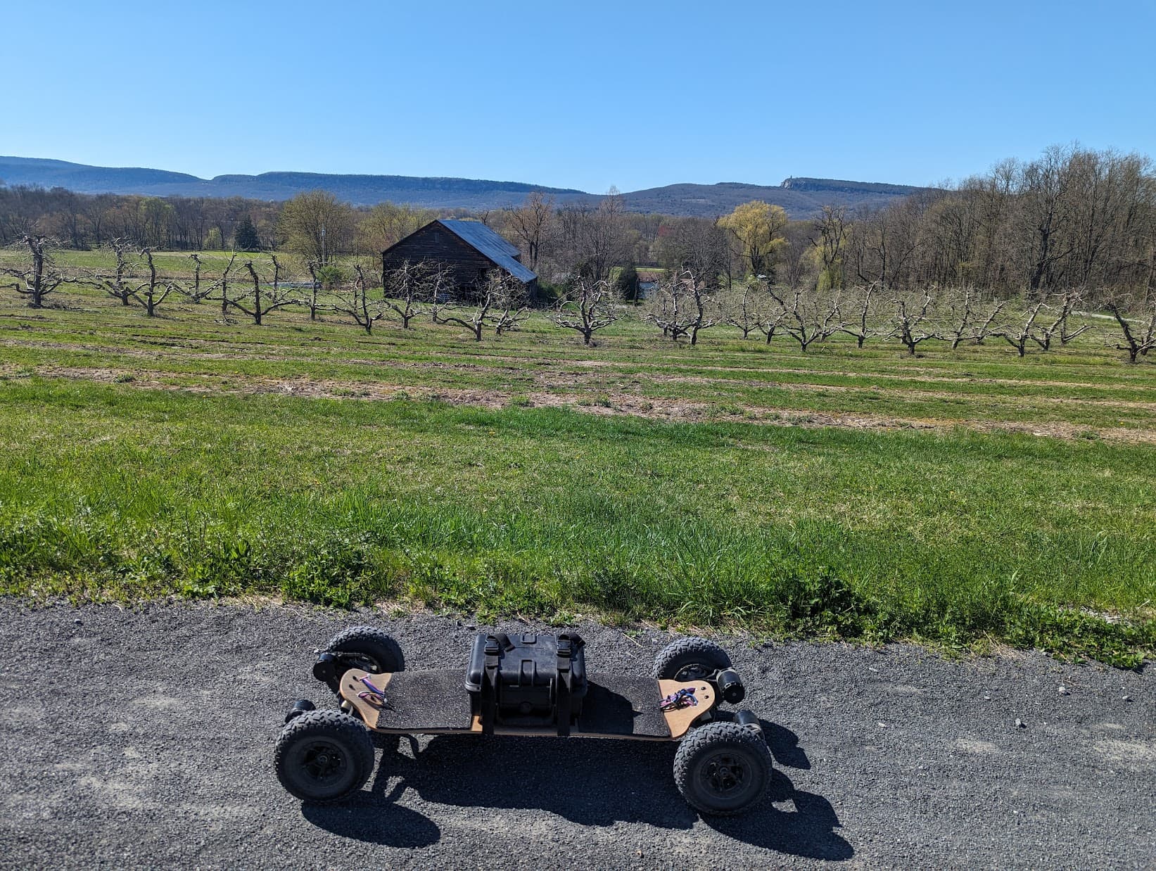

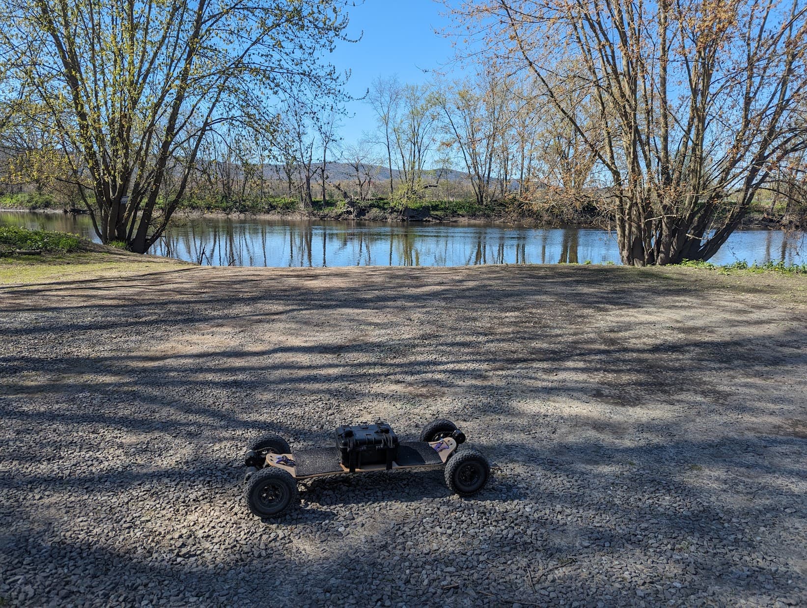

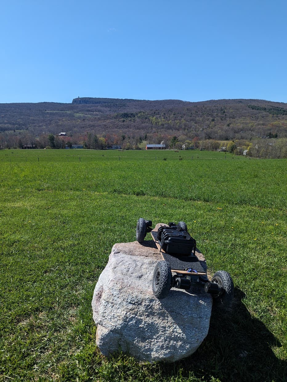

Friday, after a full day of classes, I decided to be productive. Roommates were throwing a big party for 4/20 and we already had like 8 more people crashing in our attic than usual. I set a goal of doing half of the 48 solder joints. 4 hours later, I finished all of them and had essentially completed all of the electrical stuff that night. I was kinda surprised, and the board was almost completely rideable at that point. Just needed to be cleaned up a bit. I did not even greet the guests lmao
Saturday morning I woke up and chose violence. I completed the board, getting the phase wires placed nicely, all of the EVA foam and grip tape cut and applied, ESC programming, sHFI tuning, the board was done. I decided to immediately take the board to a NYC meetup, where it surprisingly didnt fall apart. It just kinda worked…
Fast forward to today, did 13.5 miles of clean riding, with an efficiency of 33.5wh/mi doing mixed gravel/pavement. Super impressive for a 4wd setup. That’s more efficient than my 2wd.

The board’s a blast. It’s slow, like, considerably slower than my 2wd mountainboard, but it’s so much fun.
For anyone interested, here are the sHFI settings
45 degree v0 HFI
HFI start voltage: 20v
HFI run voltage: 8v
HFI max voltage: 8v
HFI gain: 0.150
Why?
Battery power
50 motor/20 battery amps at 12s per wheel (combined 200 motor/80 battery)
my 2wd mountainboard is 120 motor/50 battery @18s (combined 240 motor/ 100 battery)
More wattage, more phase current, geared for a similar top speed of ~40mph
vesc reported a max of 3600W on the 4wd
It’s reported >7000W on the 2wd
Both the battery and the ESCs suck, so the limits are set conservatively
