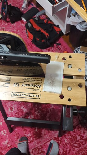

Apex stuff arrived. Sexy as always.
Mbs logo fell off of my trucks :scream::scream::scream:. Tragedy.
Axles required a good 2 minutes of straight mini torch to remove. There’s so much threadlocker on them haha
Some progress has been made
Battery is fully glued (this picture is a bit old)
I also spent a while working on the stomp pads. It’s been a wild journey, but I think I have them in a good spot. I printed out a first prototype, but realized that I screwed up the curvature somewhere, causing it to not conform to the shape of the deck.
I just finished a 3 hour stent of CAD work to get the second iteration designed, but i’m out of TPU. The print settings for the original was 10% infil, 3 walls, 3 top/bottom on 98a TPU, and it had the firmness of a stiff closed cell foam, which was nice to stand on. This version also has significantly more concave as the originals were a bit too flat.
Had to chop 1mm off the top because the bambu p1s wont do 250mm z height :frowning: This is a tragedy.
This pad will be clamped onto the deck with the binding screws, so it’ll be easily removable too. I’m also thinking of replacing the big channel with grooves for individual wires, which should tidy up the wiring.
One thing that i wish i had done with my stomp pads was to add additional holes so that the pads could be secured independent of the bindings. This is still on my to-do list
Noted, that’s certainly not a bad idea. Would be easy enough to do, I just don’t like turning my decks into swiss cheese.
Sure, but you can still add them into the pads and just not use them
Could always print with extra holes and print little TPU plugs if you don’t like dirty, obscene exposed holes.
