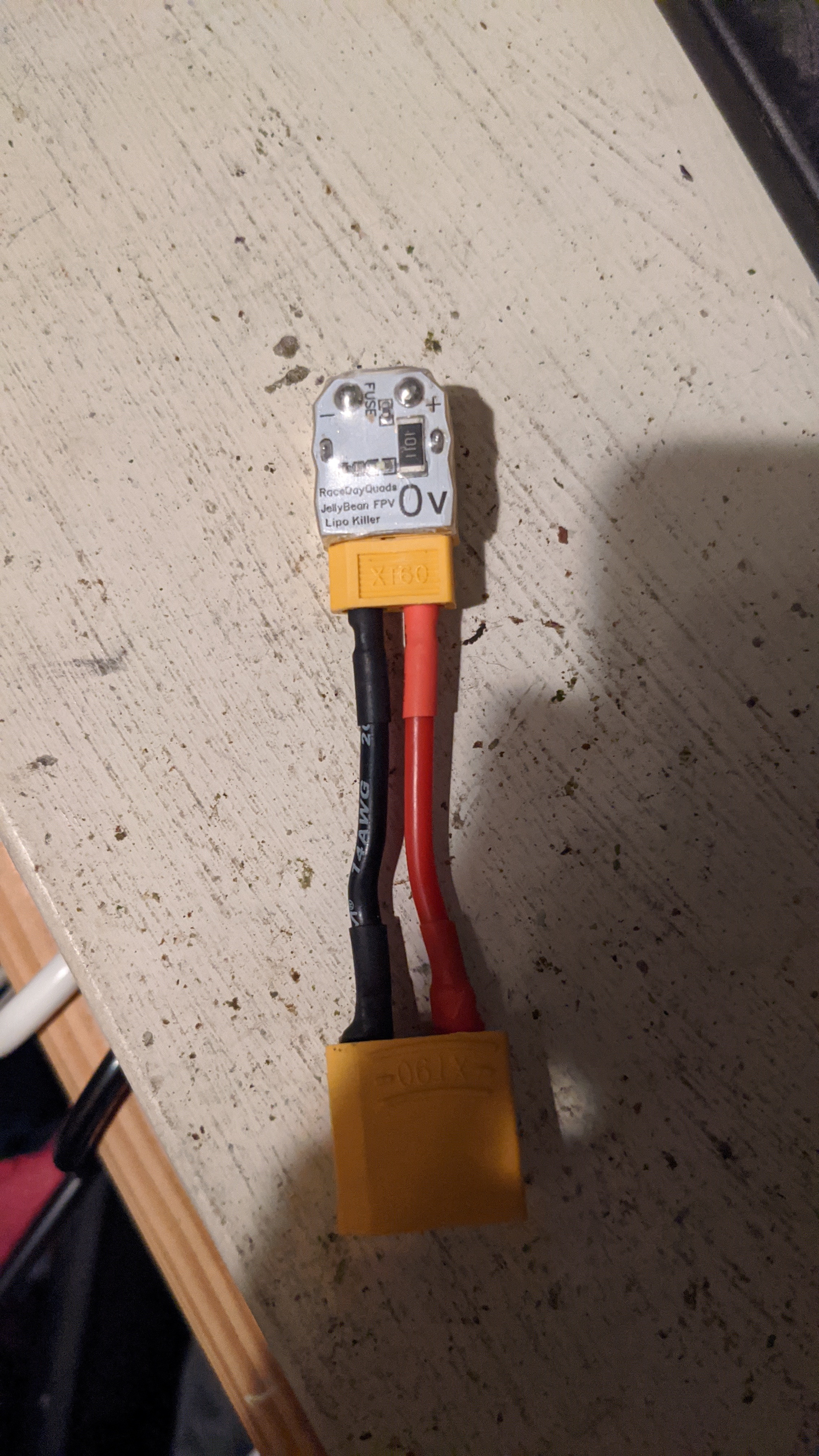

Takes a couple days to kill batteries but it does the job. Used it on a couple puffy 4s lipos to safely dispose of.
Haven’t actually chucked 'em yet. They’re sitting at 0 volts so I still need to “short” the leads together and recycle them.

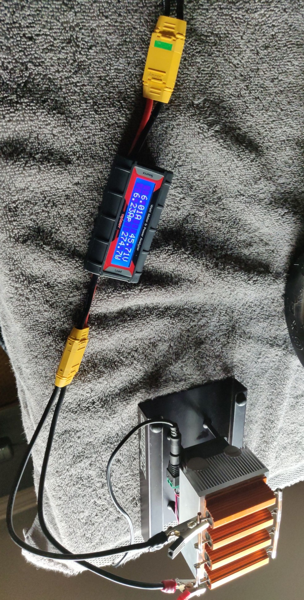

My discharger.
  • 4x 8ohm 100w resistor
  • Therma glue
  • Copper wire
  • Big heatsink
  • 2 fans at bottom
  • 4x countersunk m5 screws as a “stand”

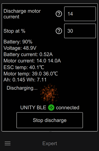

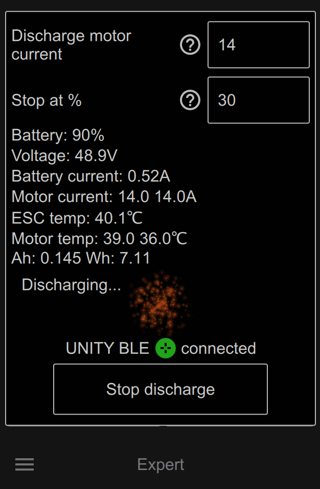

Example of safely discharging in metr app with 14A motor current (which results in 0.52A battery current)
Keeping eye on the temps won’t do harm, but Metr Pro will stop discharging automatically if it gets too hot. Or when battery gets to desired level.

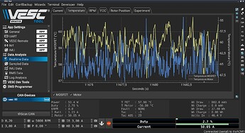

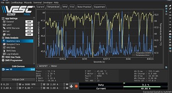

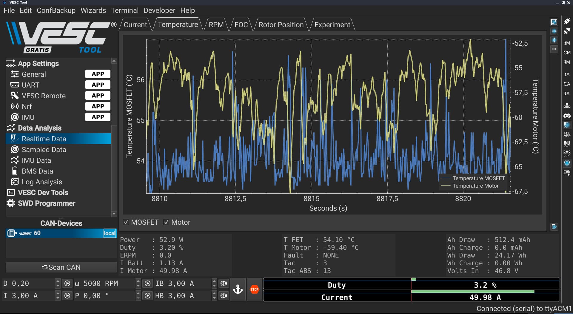

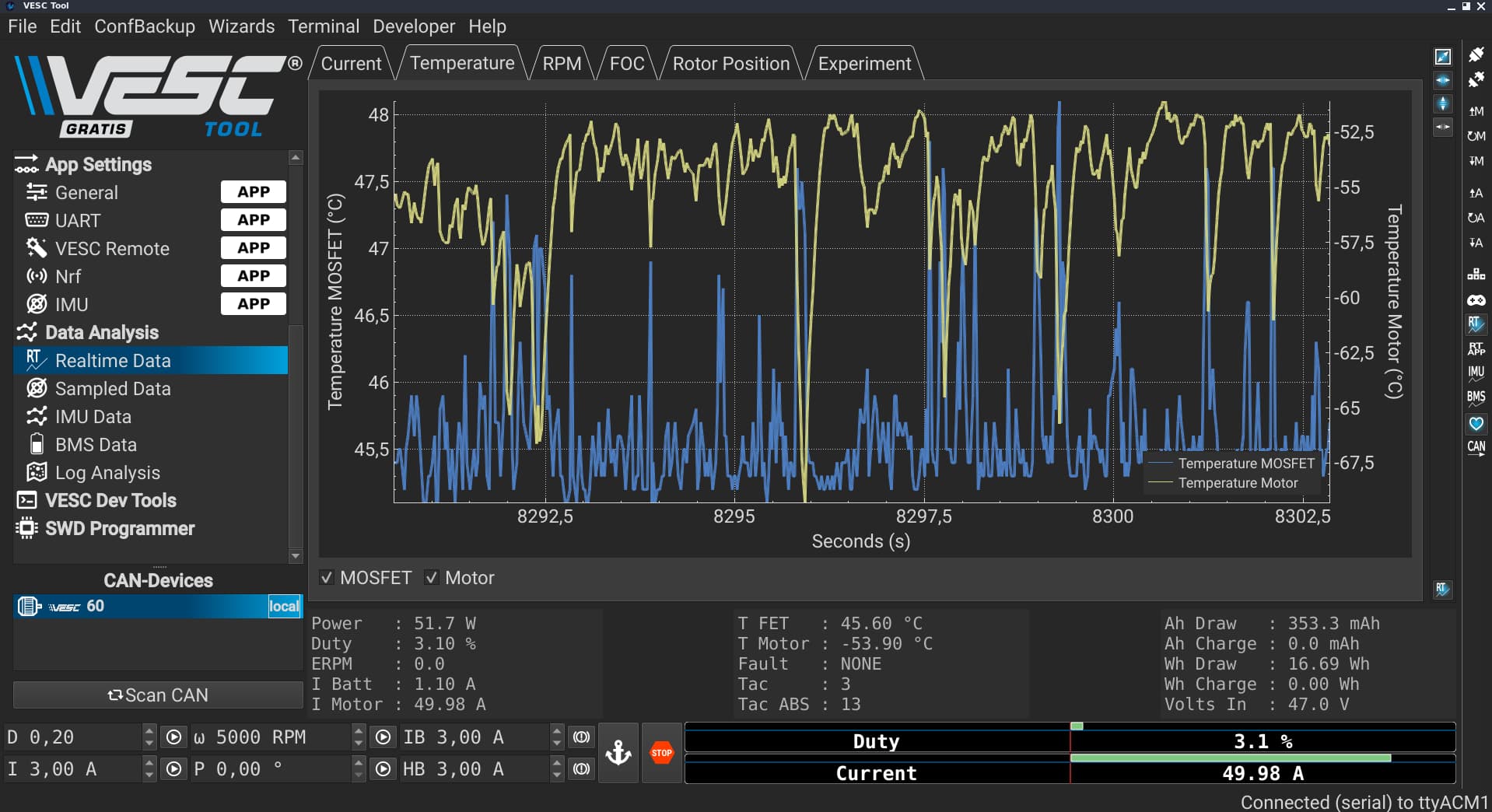

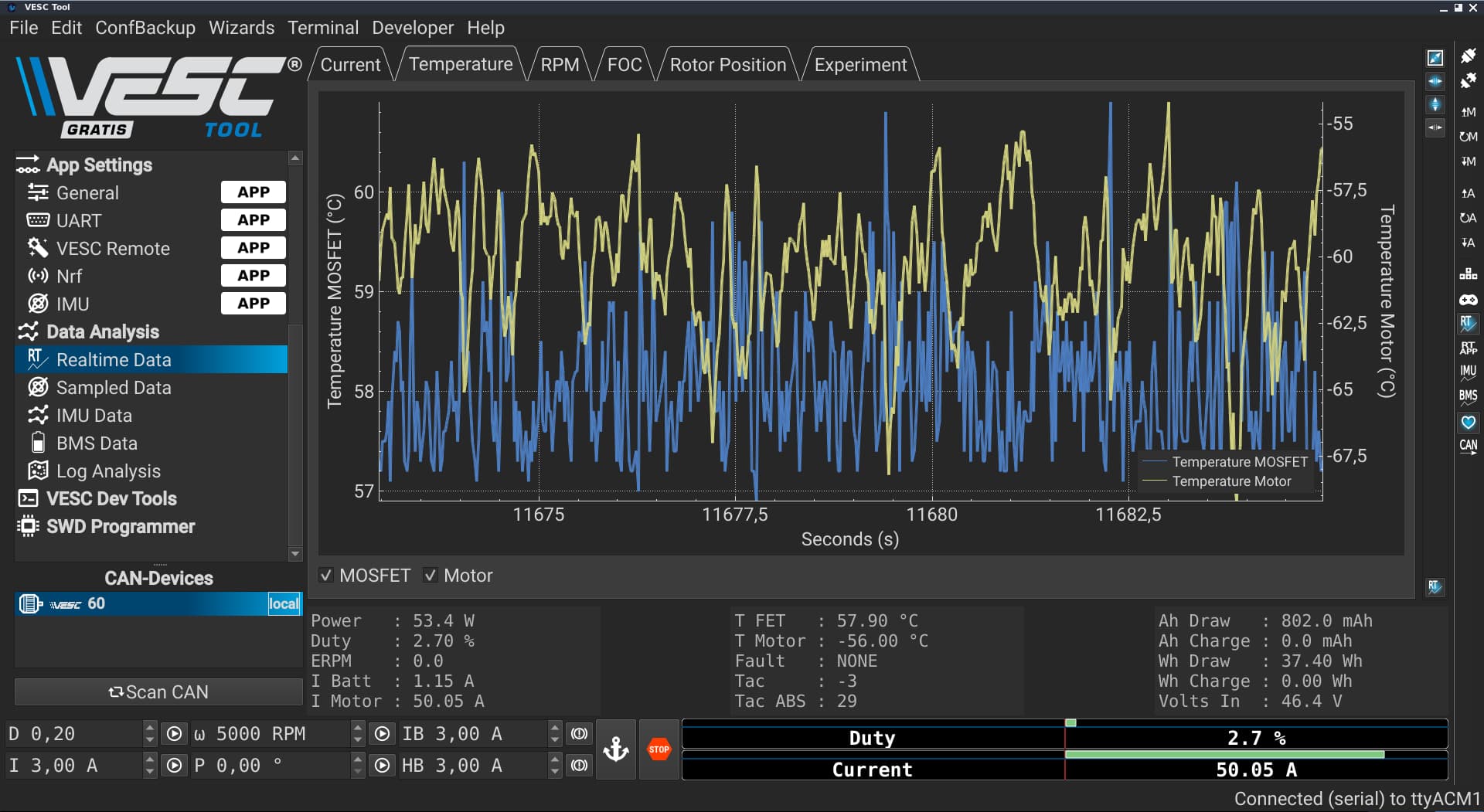

with my 12s4p p42a (16,8Ah) at ~ 49v, and flipsy 6384 (190Kv 4000W)
on only one motor only because my dual vesc has one channel dead.
Began with “foc_openloop 15 1000” to test,
then going up to 50amp (step by step) and drop rpm to 0
at foc_openloop 60 0 motor begin to hit 70°C in few minutes.
staying back a 50 amps with cycle of ~20minutes.
last cycle of ~45minutes - 1hour: here is screenshot:
Interesting that 50A was the point that temps were stable. Looks like thats a true continous rating for that esc/motor combo.

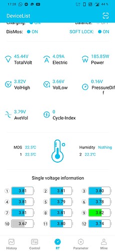

Sooo, sorry for reviving this dead thing.
These are my voltages atm:
Not great, not terrible…
Would you guys say it’s reason enough to fully charge the pack and let the charger balance the groups (I believe my charger only balances at 100%) and then try this foc open loop thingy til 60-70% for winter storage?
I’m honestly a super noob when it comes to vesc tool and never dared to try it, I’ve been blessed with a functional non-blood unity from way back and have only been using the app.
