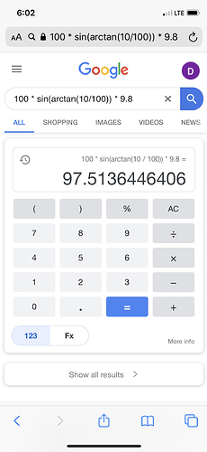

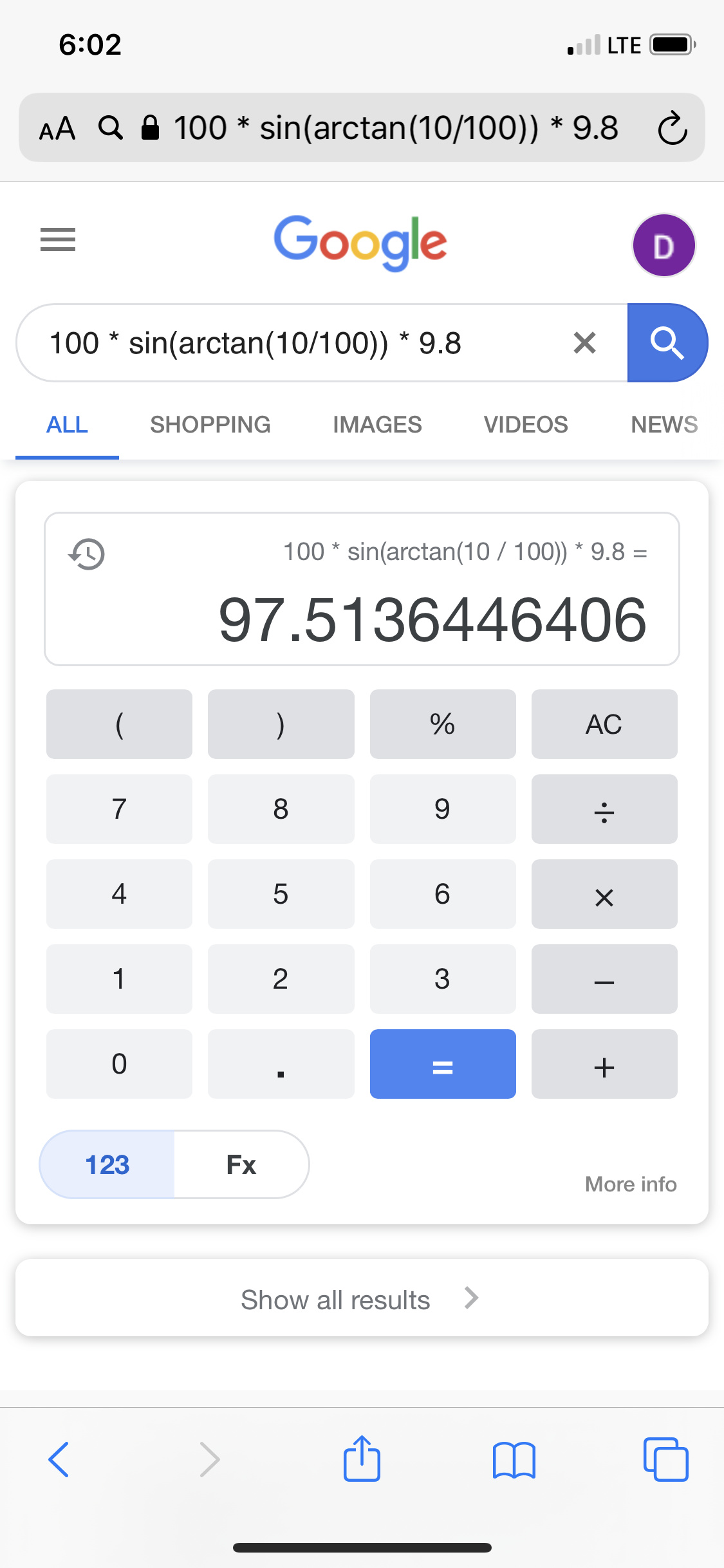

you can calculate the downhill acceleration force in newtons or the amount of force it takes in newtons to hold a 100kg mass steady or at constant uphill velocity on a frictionless 10% (10/100) slope in a vacuum on earth (gravity acceleration = 9.8m/s^2) via:
force_newtons = mass_kg * sin(arctan(rise/run)) * acceleration_gravity_meters_per_second_squared
97.5 newtons = 100kg * sin(arctan(10/100)) * 9.8m/s^2
1 newton = 0.102kg force
so
9.94kg force = 97.5 newtons
