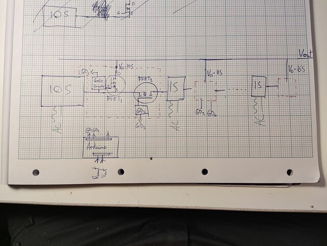

I came to say almost exactly this idea above, but I’ve got an issue with (or I’m misreading) the second part on implementing it:
When you say switch the output on and off on a normal charger do you mean
  1. A fully normal 16S charger that just has a big mosfet after it controlled by the arduino, that high frequency modulates the power down to the correct level? or
  2. A power supply made up of many individual smaller supplies (in for example a ladder of 1S voltages) that can individually be switched on? So no high frequency, just on or off
  3. Something else
If it’s 1, you’d need a decent amount of design work to actually implement it. It’s not trivial to digitally filter the switched output of an already switch mode supply, and even more so to run the control loop without having unwanted interactions with the existing loop in the supply. I think it would require a decent knowledge of the donor/master/bulk 16S supply, and a high efficiency medium frequency high power mosfet plus drive circuitry, and a basic LC bulk filter, a bit like this
for number 2 idk if I’ve misunderstood, but it would be almost comically complex IMO. You’d need individual supplies that can be tri-state switched between series connection to the next supply, shunted to the output bus, or off. These wouldn’t need to be high frequency at all (relays could work but mechanical failure and physical size), but would need to pass at least a few amps each and withstand ~60V. They’d also need to each get their own logic out on the MCU with digital control coordinating the timing to avoid shoot-through, or do it analog and build in a bunch of predictable delay so transitions run in the right order, either way it’s work. On top of that, you’d need conservatively 4-8 separate mains fed converters. To get a 10, 12, 13, 14, 15, 16S selectable one you’d need at minimum 6 supplies of 3 different voltage outputs. In the diagram I sketched out the tri-state thing once and from there a red box indicates a copy-paste, and arranged it in a sort of sensible 10S + 1S + 1S… up to 16S.
Usual disclaimer: I’m not certain that I’m right here and am liable to miss something obvious, could be that I know just enough to be dangerous
