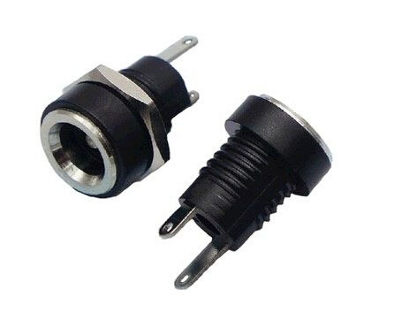

Nah those are like 1A rated.
Similar plastic one that shows rating.
Best to just find one that has a current rating at or above your desired charge rate.
I bought these the other day. All metal and 10A rated.

fuck NO… that’s fukking plastic
probably rated for less than an amp
