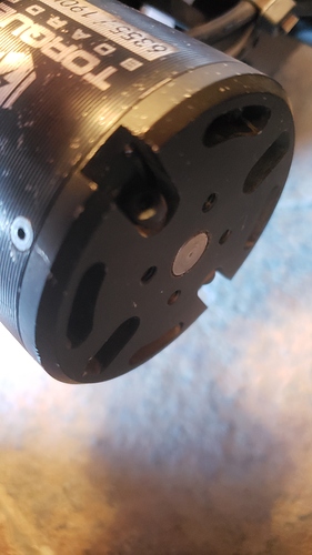

How do I keep the motor can screws from backing out? I have already tried medium strength thread locker.

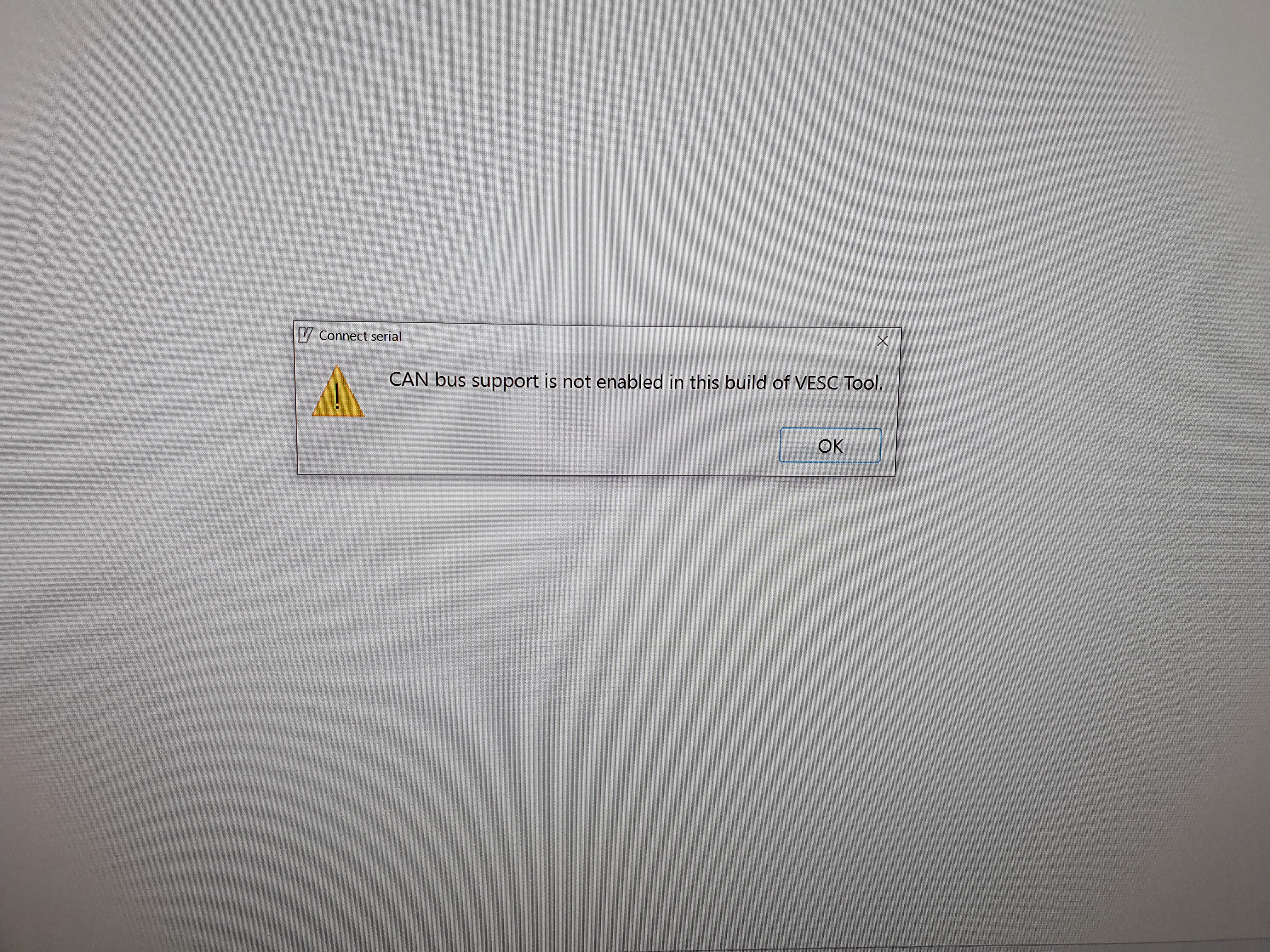

Huh?.. connected without motors, got this message, updated both firmwares separately (now they both have 4.2 which i heard is far from best). Still get this message. What gives?
See a thread I posted in the how to section for fixing those. Now that it’s moved, they are likely mushroomed and backing them out will destroy the threads. Best fix is to put in m4
Well your right about the part where backing them out will destroy them, both are now stripped. So your saying I should force some m4 screws in to create new threads?
You will need to drill them and tap
That lays out how to fix it. Hopefully you have enough material left after removing the messed up screws.
You could ask @torqueboards if he has any cans for sale
I think I will give it a shot! Regarding the tap, do I want a M4-0.7 or M4-3/4?
Anything M5 (or 10-32 if you’re using freedumb units) will fit.
As mentioned before, hex drive is preferred over phillips or pozi due to resistance to camming out.
Strength class 12.9 is preferred, but truck screws aren’t ridiculously stressed so it’s not critical.
You want M4-0.7.
I’ll give it a shot tomorrow! If it doesn’t work, I will just stick weld the fucker together.
