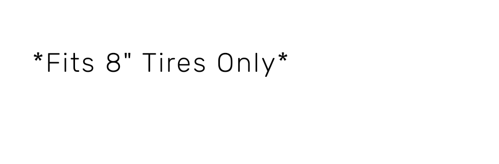

hello,
will a 6x2 tires/tube or solid rubber fit MBS Rockstar II?
@dikoharold
Mbs states it wont

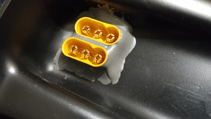

How do you guys route your motor wires into the enclosure? I’m trying to find the cleanest (visibly) and the most dust proof. I have previously just drilled holes slightly bigger than the wires and pushed the wires through, but a lot of dust would still get in. I think something with rubber would be better…?

Epoxy MR60 connectors into the enclosure using JB Weld. Run sensorless since it’s more reliable anyway.

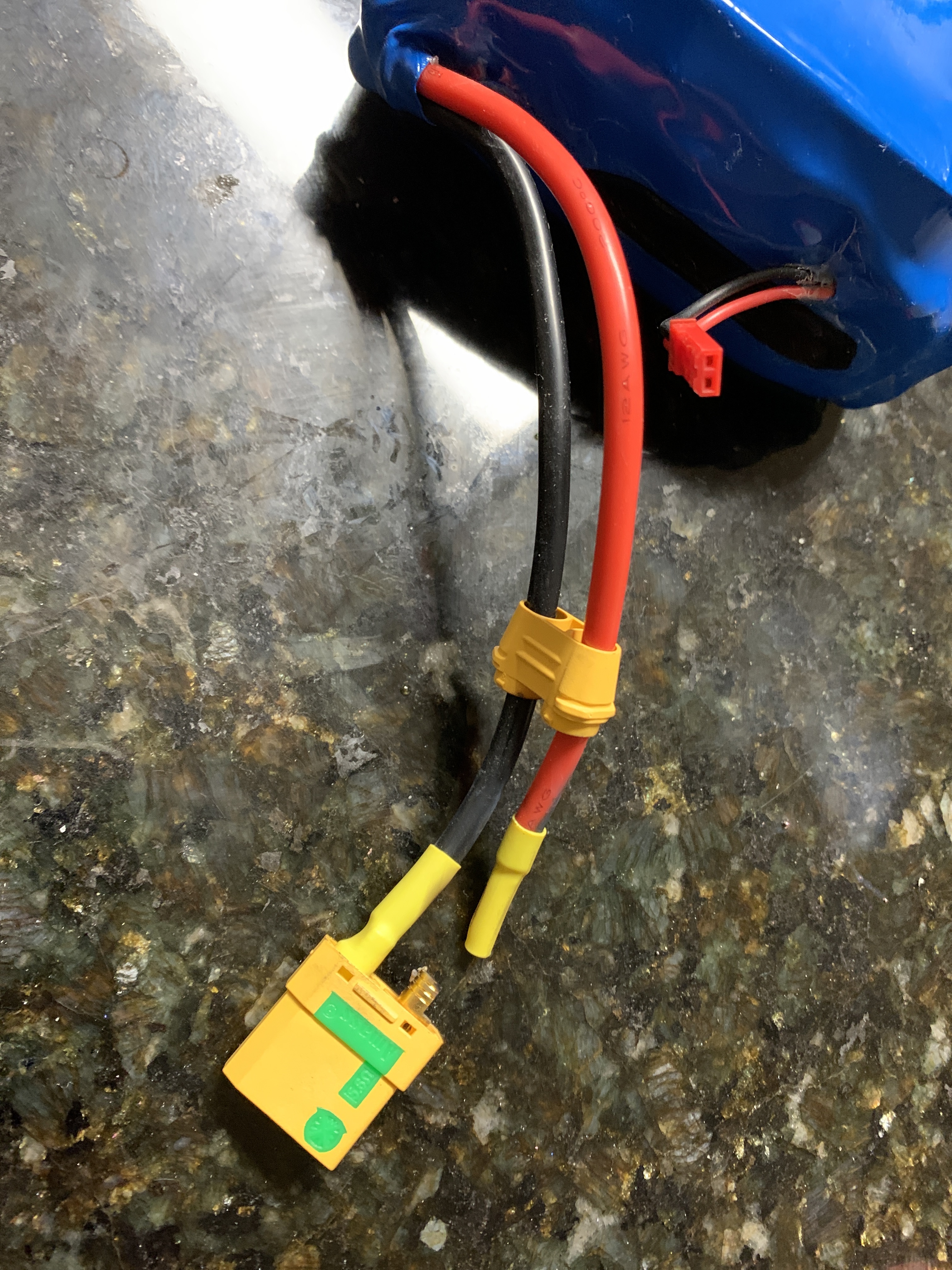

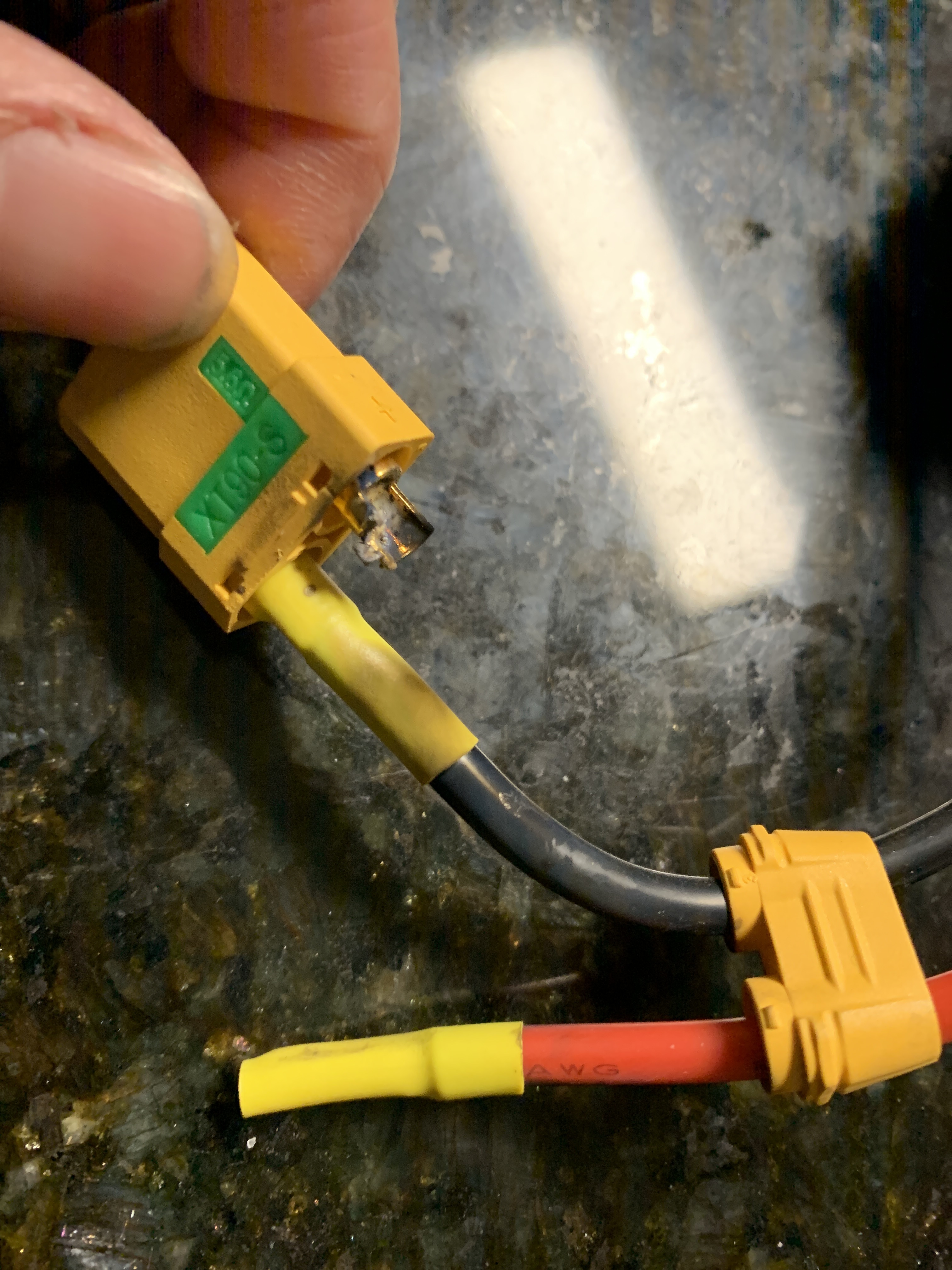

If a pack shorts out, how do you tell if it’s safe to use? The connector kinda melted
Battery is 12s3p 30q bypass, voltage is still 44.3V and nothing is warm except the molten connector
I shrink wrapped the positive so it doesn’t touch again the wire is blackened and slightly melted
I was using a connector as a support but I grabbed the one I used as a short from a test long long ago
I’m about to have a heart attack…
Thank you.
If I don’t do this now I will be scared forever, I have supervision
A batter main and 6 bullets later I’m feeling mush better, pack is still stone cold and 44.3V
I’ve been there, the ā€œkeep the window open, extinguisher handy, and big channel lock pliers nearby – just in case this thing goes supernovaā€ heart attack sequence
Hope you got it sorted out :smiley:
My general sequence is: feel the pack all over. Any localized hotspots, or any change in the shape under the shrink wrap, are cause for concern. Then I do the sniff test all around for any burning smells: It’s normal at the point of the short, but anywhere else is A Bad Thing.
Then I’d cautiously apply load, starting small and working up to the full discharge rating, and repeat the above checks to make sure nothing internal was weakened to the point that normal use will cause undue heating/damage.
After that, if all seems well, use as normal but watch it like a hawk the first couple cycles.
How should slowly increase load? Just limit amp draw settings?
One way, of many ways, would be to set ā€œbattery maxā€ and ā€œbattery minā€ to like 5A / -2A and ride full throttle uphill, then keep increasing those.
But on the bench upside down it will never reach the maximums, you’d need to actually have a load on it and be ready to inspect it with a quickness.
Not sure what enclosure solution would allow such fast access, maybe tape around the deck (for a temporary use while testing)
