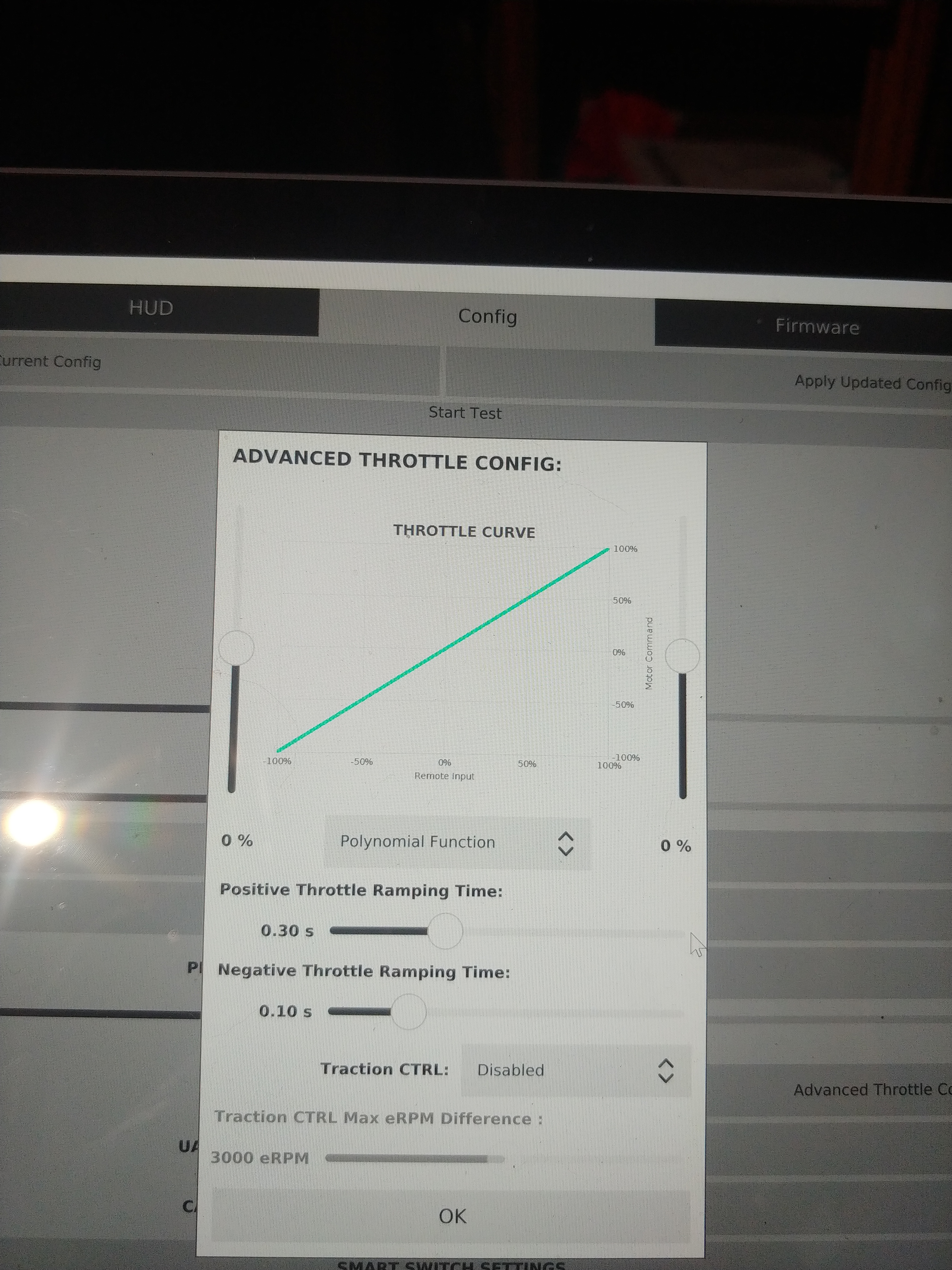

@b264 I don’t understand. What do i make 25% & -3%?
@taz that is good to know! I will contact @EboardSolutions :slight_smile:
See where you have -100% in the settings?
Just put 0% in everything
Also change your positive ramping time to 0.3s and negative to 0.1s
Still does not work. The sensitivity increases but still no response until I hit the 17% on the throttle and then the speed just keeps increasing even though I don’t move the throttlle. Would it help to have a video?
After changing the throttle config i “Apply Updated Config” of course :wink:
Use the realtime data part of the VESC configuration utility to view your “ESC Tool” and “from ESC” input values from your remote
You are doing this on the bench with no load right?
If yes don’t worry about it, when there is load (while actually riding the board) it will behave ok.

@PixelatedPolyeurthan You are standing on it for the test, no?
@b264 this is a noob thread… I don’t understand haha :rofl:
You have to ride the board. It will always do that with no load.

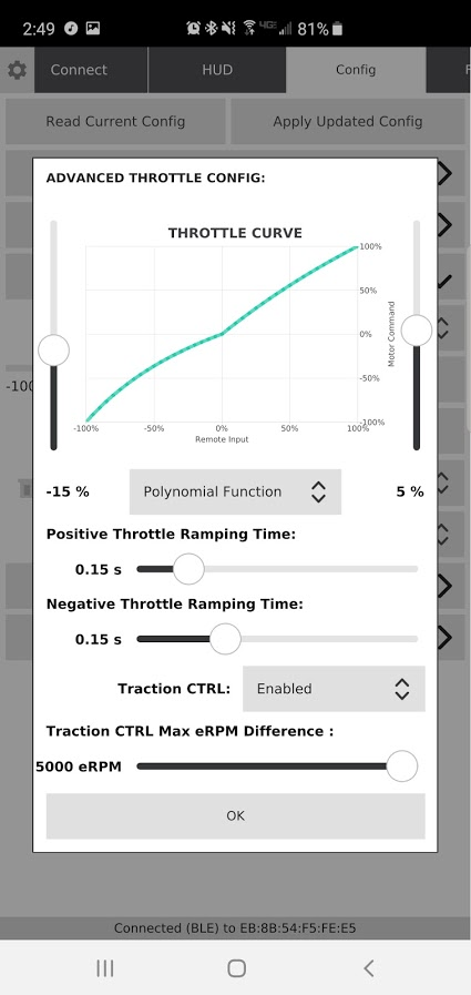

So much better! the braking starts soft and then really kicks in hard. how can I smooth that out?
Also since you guys said that I am controlling the power (not the speed) is there a way to change that. I live in the Alpes in France = mountains. i have to adjust the throttle whenever the angle changes. it will suddenly accelerate. I also realllllly don’t like the remote unless it is faulty. it is really sensitive. like 10x more than an evolve board it gt/gtr mode. What can I change in the settings?

In general:
Regen current: Braking at high speed
Motor braking current: Braking at lower speeds.
So if you feel your brakes are too strong at lower speeds decrease braking current to -40A and try again
To make the remote less sensitive try around -20% on the curves

Play with the throttle curve on the left side. Try -25% or 25%. I forget which is which. One does the opposite of what you want. You want the curve to bend this way

@b264 will definitely go for the mini remote. +25% is what you (I) want for the purple line :wink:

You might want to try 10% deadband before moving to 5%.
This is my go to throttle curve for smooth braking. Try increasing the throttle ramping time and decrease your “max braking current (not regen)”.
Regen braking current: Braking at high speed.
You will also get better at controlling the remote gently with your hand. Snip finger tips off gloves if you need more fine motor control.
