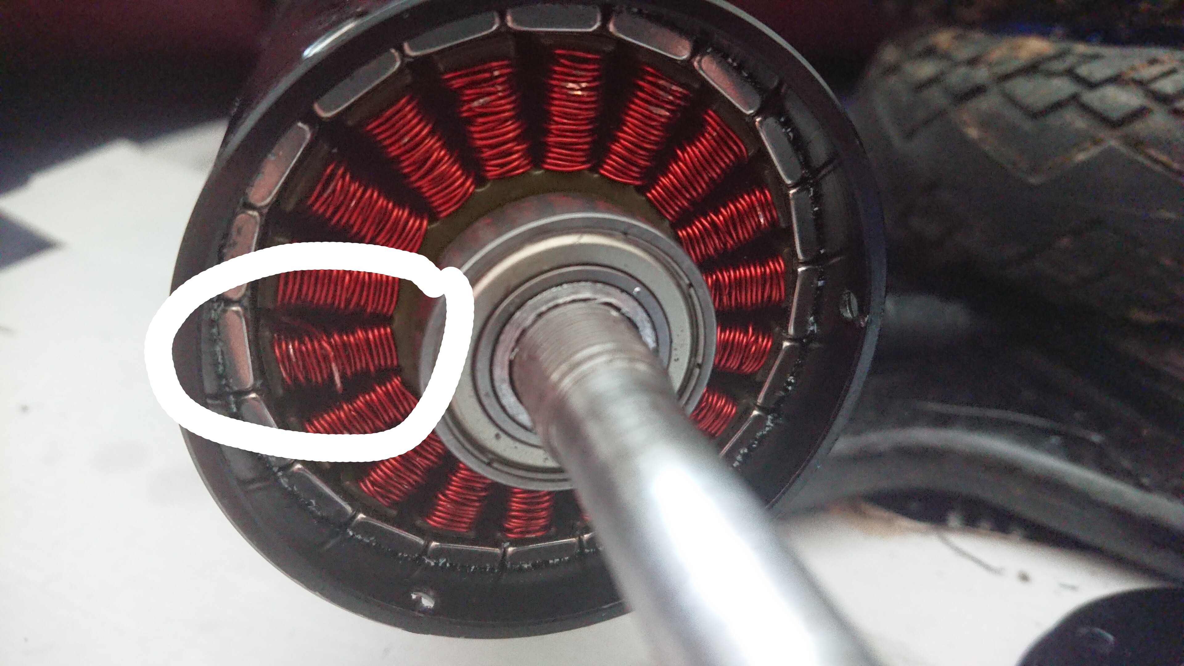

Still have to take the screws from the back and check the other bearing, but the outer bearing looks ok, and so do the magnets. Watch this space.
Maaaan, I’ve never ridden anything better than this board when it was working :disappointed_relieved:
When you’ve got the end off the drive the can has nothing to centre it so will be pulled to the magnets I’m guessing. Not necessarily out of line.
There’s info somewhere I think on the elofty thread on how to do a complete teardown of these. Did you find that?
Yeah, you’re probably right. Really need to complete the inspection to be able to draw any conclusions.
I saw the guide, but the tiny screws are a bitch to get out (had to drill two of these out so far) and so far have been unable to get the motor out of the axle…

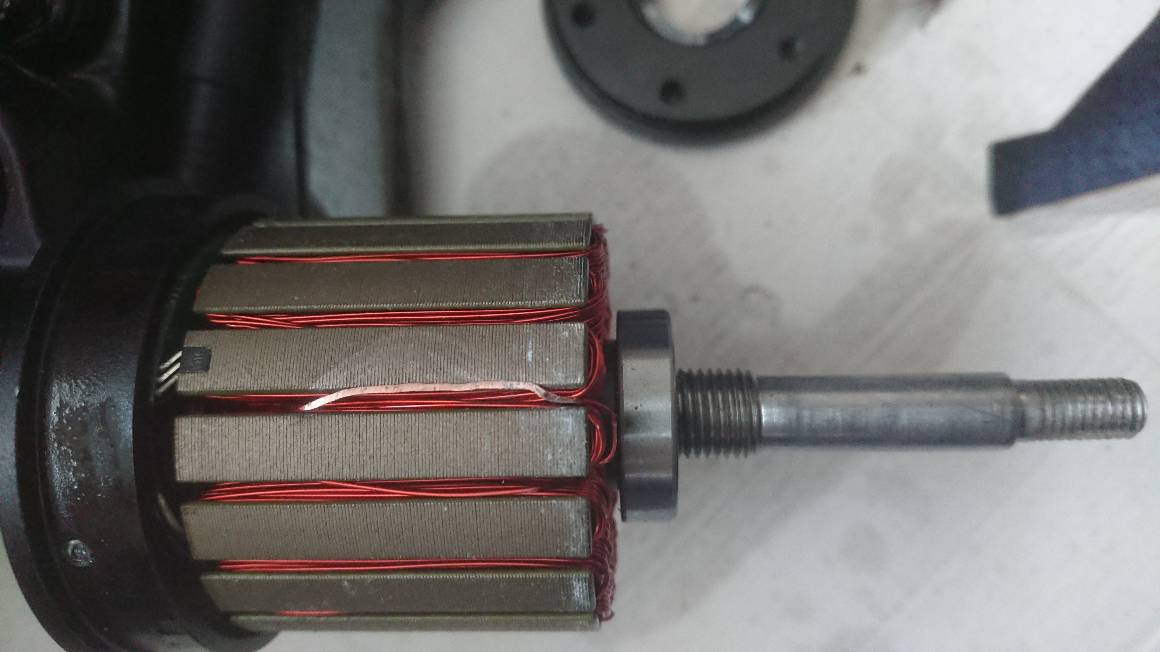

@hummieee does this winding look normal to you?
When rotating the can it looks like the wire is caught slightly so I’m thinking that may be the issue?
I might just be talking bollocks because I don’t know anything about stators, so any help it deeply appreciated!
I think I found the culprit :rage:
Is this salvageable or is this garbage?

Oh i see you found the failure, mbmb hmmm looks fixable maybe, but not an easy one i bet.

Maybe add nail polish to the wire and push it back in place?
Dunno if it would hold the heat TBH

It probably has a couple of these strands in parallel and even if it fully sliced it would maybe still go. It’s not sliced though and if u squeeze it back between the teeth snd glue it there should be ok. Use a multimeter or the Vesc tool
And make sure it’s not shorting.use high high heat epoxy
