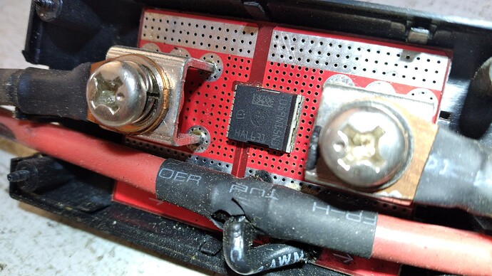

These are the ideal diodes I have:
Specs say upto 70vDC, and 0.04v drop at a 28.6 amp load.
I will measure the drop across them next time I drag my gc-2 AGMs down low enough they can take ~50 amps.
I misremembered the flow on the 3s packs, I was trying to drain my ~12.2v 3s Lipo weld battery down, connecting it to my 3s1p 18650 pack that was likely much lower, and saw 12+ amps flowing through my wattmeter, and decided that was way too much.
Maybee the ideal diode can be used to charge one battery from the other more safely than putting two in parallel.
They’re lying about the voltage drop.
That FET has about a 9mOhm Rds-on when hot and that gives you a voltage drop over six times higher than they say, about 0.26V. And that’s only the FETs Rds-on. You have to add on the other resistances from the soldering, PCB copper, and terminal.
It’s a 150V FET so the 70V rating probably comes from a 75V ideal diode controller that’s running the show. They scratched off the number in that eBay listing but perhaps it’s visible on your unit. It’s the small chip to the side.

Ok, some data, as promised.
I drained my 2 GC-2 6v agms in series for 12v nominal, till they were 12.02v.
I turned on my 100 amp adjustable voltage power supply, jammed my dmm probes through repurposed wattmeter housing, onto main Ideal Diode terminals.
No load voltage drop across terminals
@12.2v…0.033v
I dialed up voltage
0.039v at 5.9 amps
0.05v @29.9amps
0.098@53.5 amps and 14.2v
My diodes are wired with 8mm2 and 8awg across 45 amp anderson powerpoles on either end, and are warming up rapidly at this point
Holding 14.2v on power supply output…
0.104v drop at 51.8 amps
0.106@ 50.3
0.108@ 50.7
0.114@50.4 amps.
At this point I connected my second set of 8 awg 45 amp powerpoles across second ideal diode and ammeter on powersupply jumped to 60.1 amps.
I started typing the above, fat fingering at 7 beers deep, this data.
shunted ammeter on power supply output says 57.4 amps @14.2v
The original ideal diode and wiring is now hot as fvck
clampmeter over it says 29 amps
voltmeter says 0.055 volts drop across terminals.
second diode says 26.62amps.
lemme puncture housing to read voltage drop across ideal diode on cooler diode…
0.040v

What FET is on your diode boards?
Your (very low) 114mV drop at 50.4A = 2.3mOhm resistance and the FET in the eBay photos you linked to (and that I based my calculations on) has a much higher resistance.
I’m wondering if those eBay photos were of an earlier prototype they had and not what they’re shipping?

One is on the output of my Meanwell rsp-500-15, two others pare portable, inside wattmeter housings, one of them has now a big copper heatsink stuck atop the main FET in between terminals, the other does not.
I just keep them on my 100amp powermax adjustable voltage power supply outputs, so i do not need to unplug the DC connectors when I turn it off and reattach when I turn it back on. Very convenient. Their low voltage drop not really needed as I could just dial the supplies’ output voltage higher to compensate.
All three ideal diodes have seen a lot.of use, Glad I have them.
I can take the other one’s casing apart and try and read anything visible on the components, a bit later today, but IIRC, the seller or their parts provider decided that info was not to be shared and scraped their surfaces clean of parts numbers.
They scraped off the part numbers on the little chip
Thanks!
That’s the same FET as in the eBay photos. Its resistance spec should result in a much higher voltage drop than you measured for that current level but I’m glad it hasn’t!

I bought another ideal diode, well, I bought two.
The first one, purple, has a no voltage limit, just not allowed higher than 40v difference.
I could have screwed it up wiring it incorrectly originally, like a dumbass, but its voltage drop when wired correctly, is inconsistent, rising from 0.04 to 0.4v, cycling over and over every 5 seconds or so.
So I bought another red one like pictured above, that I’ve been using for years.
This newly arrived one, they didn’t bother obscuring the markings on the little processor like they did on my other two.
